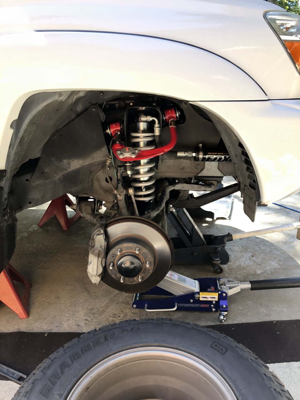

    Finally made some time to install my Fox 2.5 extended res. with JBA high caster UCA’s. Install went well. Drove it about 100 miles then got it aligned. 3BE1D6DE-D676-4752-B2A6-629E6BCA025B.jpg
    A couple tricks:
    1-Removing UCA Long Bolt. Bend the inner fender seam just enough that the UCA bolt head passes. Then use a 10” 3/8 socket extension to tap it out. This method I barely had to bend the metal.
    2- Install the the front “wheel well apron” before the fox reservoir bracket. The bracket cover up the lowest snap.
    3- If installing by yourself like I did. I slid a 3/8 socket extension in back hole to hold the UCA in line and also finger tightened the ball joint to the spindle to help hold the uca in place.
    14Tacos4me, bax and Bumble Bee Tuna like this.

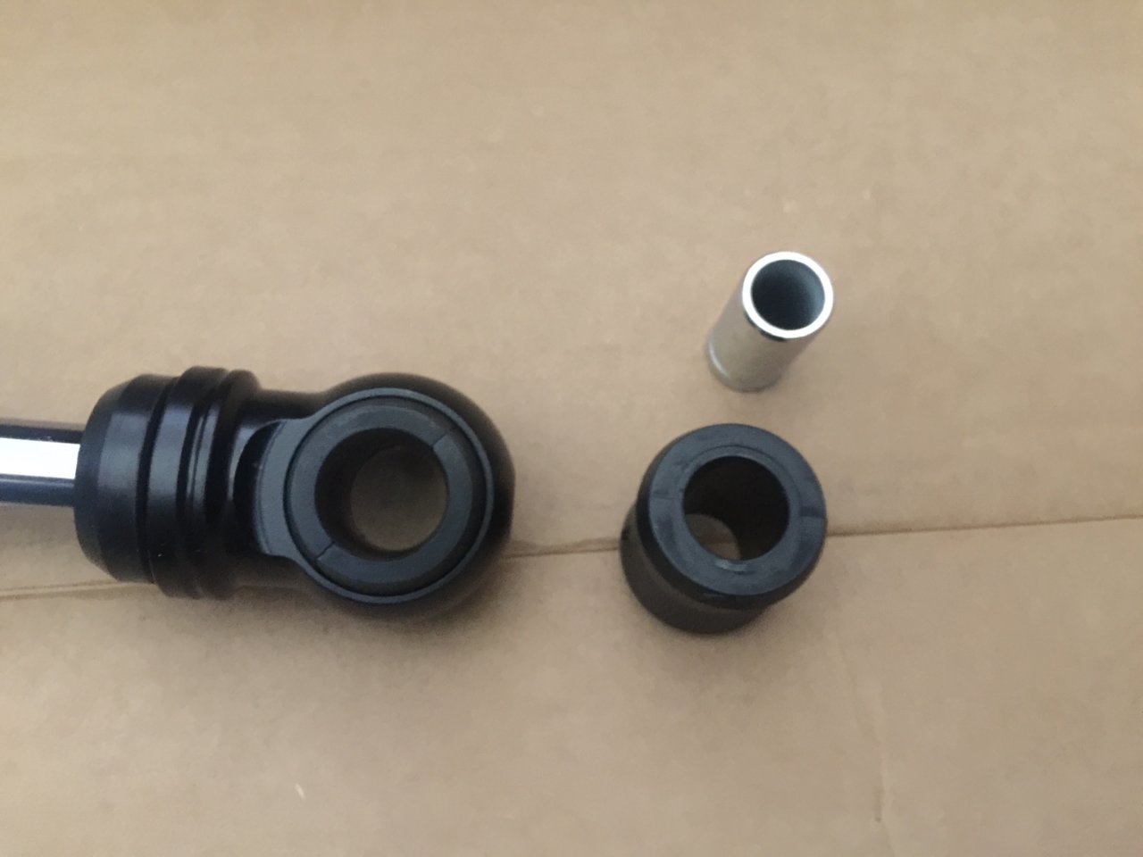

    Those need to be pressed out and the correct size installed. You received bad advice.

    Maybe Fox should start supplying the correct size lower bushing for the vehicle. I mean the extra bushing that was supplied fits the shock properly and the ID is the correct size for the bolt but the bushing is too wide and does not fit properly between the mounting tabs. It shouldn't have to be forced on brand new shocks. It's not a one size fits all kind of deal.

    i pressed them out and installed the correct size, they are still 1mm too wide; good advice, works at Fox

    Took the day off and finished installing my lift kit. Fox 2.5 coilovers up front, 2.0 RR and 3 leaf Headstrong AAL out back. Everything was pretty easy peasy but the rears. I'd done them first about two weeks ago but had to dismount the lowers for the AAL install.
    What a bitch! Got tired of reliving the lower shock mount nightmare and broke our the dremel and shaved the bushing and sleeve down until it fit like it should. Then bolted it right up.
    Fox needs to seriously reevaluate the rear lower mount situation...

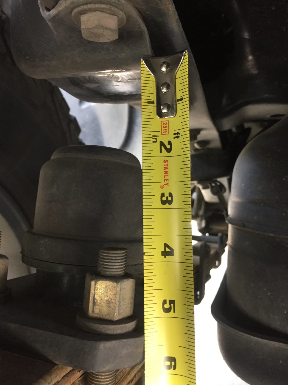

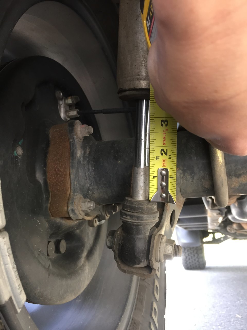

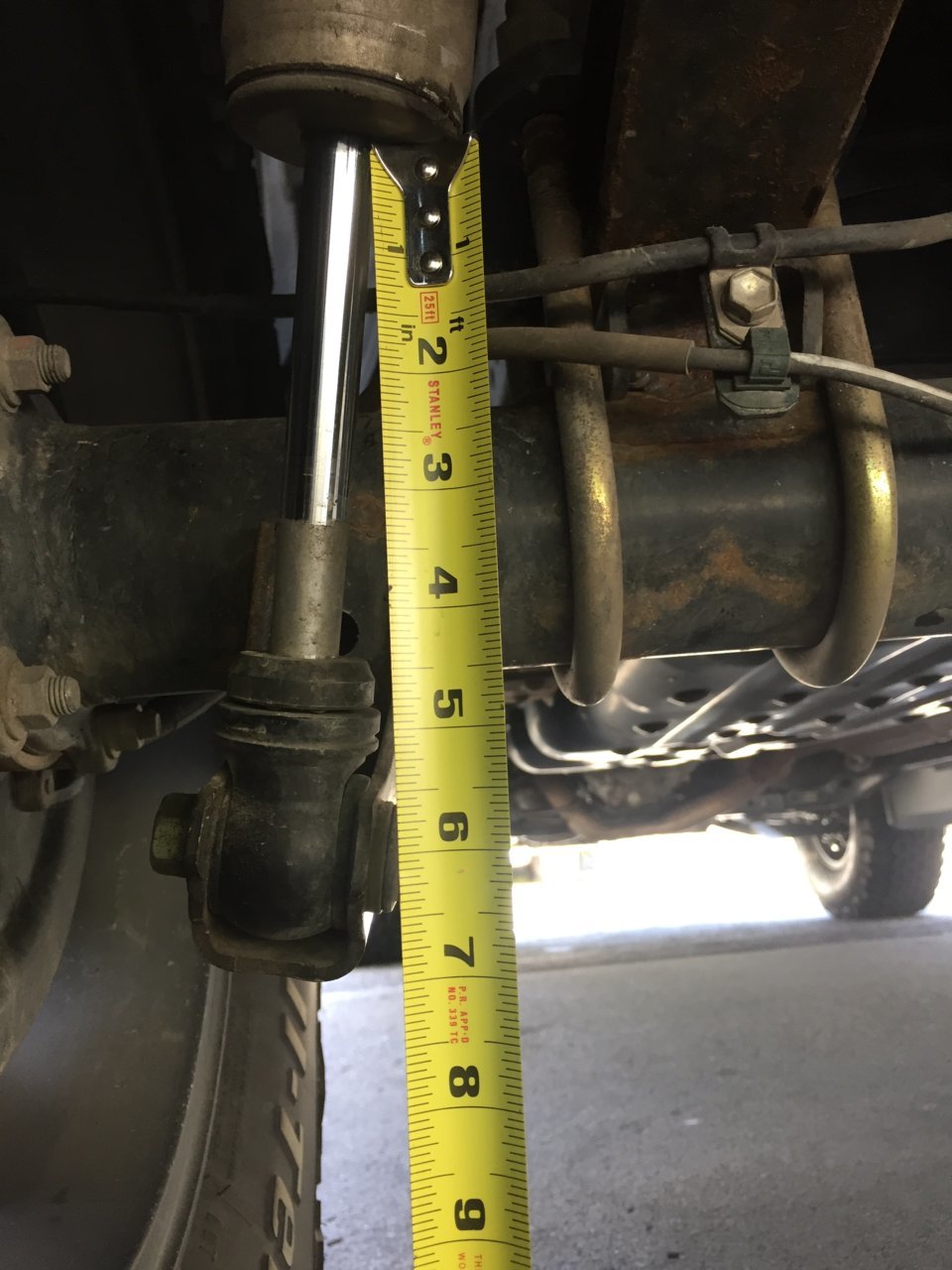

    BFG KO2's 265/75r16 32" OPT7 light bar mounted behind grill Softopper Canopy (black) Total Chaos UCA Fox 2.5 rr DSC Coilovers Fox 2.0 rr rear shocks w/adjuster Icon rxt leaf springs config 2 Weathertech stone/bug deflector CBI hidden winch mount Smittybilt x2o 10k synthetic winch
    For those running Icon RXT rear leaf springs, which shocks and bump stops are you using? Right now I have RXT leaves config 2 with Archive garage ubolt flip (older version, 1" spacer built in, measures 1 5/8" from top of leaf pack to bottom of super bump) Fox 2.0 LSC 9.1" travel and I am looking to get more bump travel and use the last 1 1/2" travel of my shocks. Anyone have a better bump stop setup or running other leaf packs with more lift but still a similar spring rate? Ideally I want something that will ride okay when empty (sliders, recovery gear, hilift) but that I can put 300-400 lbs and still be able to handle logging roads with potholes and washboard.
    where it sits loaded with 200-300 lbs:
    and unloaded:
    Photos taken after definitely hitting bump stops multiple times.

    I just installed wheelers flip kit & bump stops today on option 2.. previously i was on option 1 with factory bumps.. i had about 4.5” of shock shaft travel (unloaded) and 4.5” (fox 2.0 and i think it’s 9.3” of travel) to the bump stop. Which wasn’t good I bottomed the shock out before i hit the bump stop. That’s why i installed bigger bumps. i haven’t taken any measurements with new bumps.. but a rule of thumb (from my understanding) is you’d want to hit your bumps before bottoming out on your shock. So an inch or so on the bump is fine
