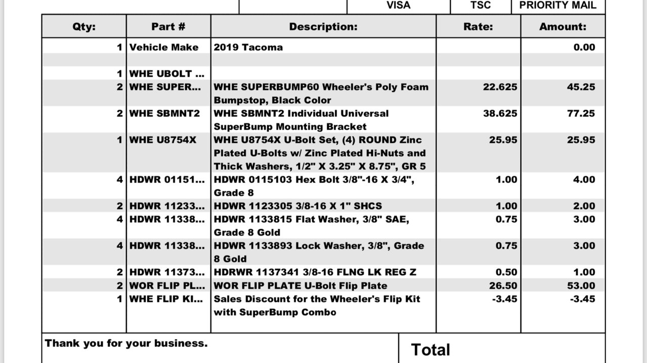

    I definitely want to leave a little space to not risk bottoming shock, thinking 1/2" or so which means I would ideally like my bump stop to completely compress an inch later than it is. Might try playing with different bump stops that aren't quite as big as superbumps, also thought about Archive Garage's new ubolt flip and keeping the super bumps which would gain me about 5/8" more bump travel.

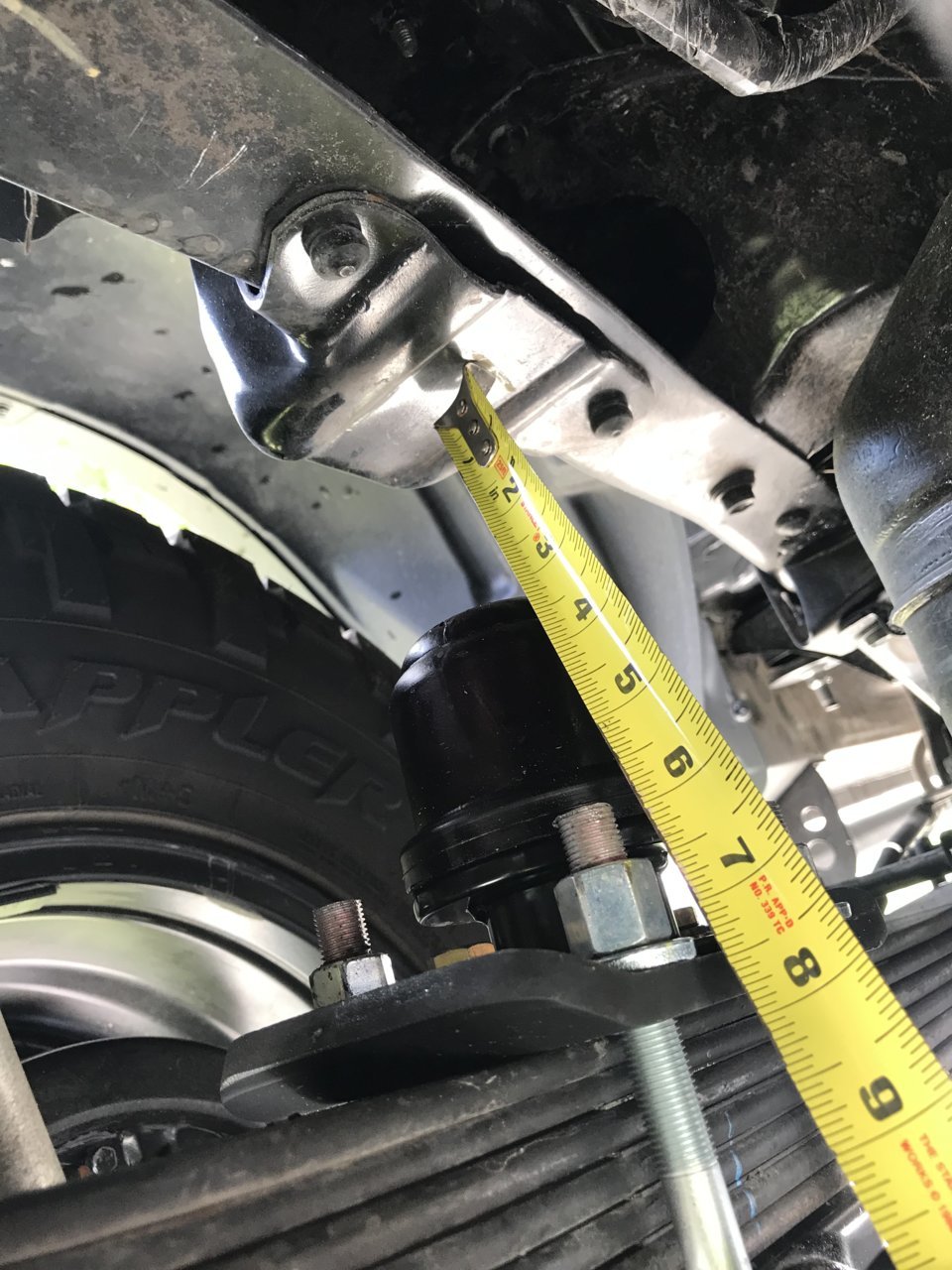

    I’ll take a few pics tomorrow with tape measure to give you a reference.. wheelers flip kit and superbumps.. i think it gives me 1” of bump travel. The bumps sit 1” higher than factory.. at least that’s what wheelers told me.. 9B375A7F-2BA8-4A76-B07B-FA006157D19A.jpg

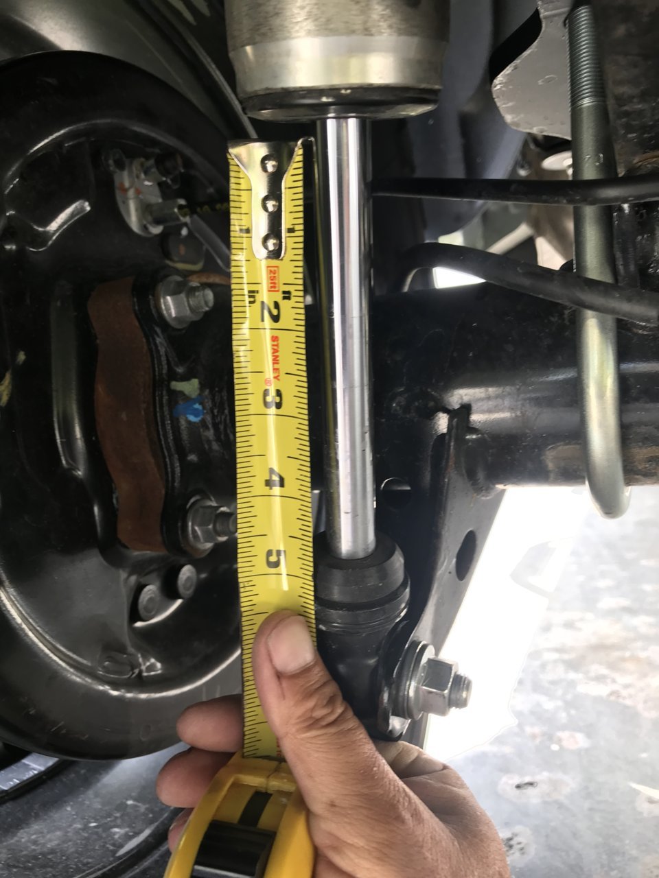

    @kylerocker10 F5C2FBA0-3FBF-4F83-A846-62CE51E0925B.jpg 1FB0869A-FE4B-4F37-8454-DF78A0973159.jpg
    I’m sitting on pretty level ground on option 2 unloaded. But it looks like I’ll have about 3.5” of travel before i reach my bumps.. and an additional 1.5” on them.. they are supposed to compress and be cushy.. we shall see

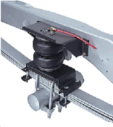

    Another option is airbag suspension kit that replaces the bumpstop. The owner from filthymotorsports had recommended this as an option. The inflatable airbag/bumpstop attaches over the leaf spring where the bumpstop would be located and you can inflate it during heavy loads to prevent bottoming out of the shock and deflate it when the load in the bed is minimal. As I understand it, it can be hard to find a shock/bumpstop combo that works well during both heavy and light loads since the spring rate/shock mechanics are very dependent on weight. Below is a picture

    I have thought about air bags, however I have heard they aren’t great for serious off-roading. Also, I am usually only adding around 300 lbs of camping gear and bikes so it seems like I should be able to find a good compromise between that weight and empty weight. My goal, after talking with Ryan at Accutune is to dial in the bump travel and then possibly revalve the rear shocks so they are a bit firmer. I would love to have some sort of bypass shock like the new King 3.0’s or Bilstein 8100’s but Fox doesn’t seem to have an option that competes. I also don’t want to do anything irreversible like welding on new shock mounts.

    Any air bag that is fixed to both the axle and frame will ruin your ride quality. They don't like to extend or compress, even when empty.

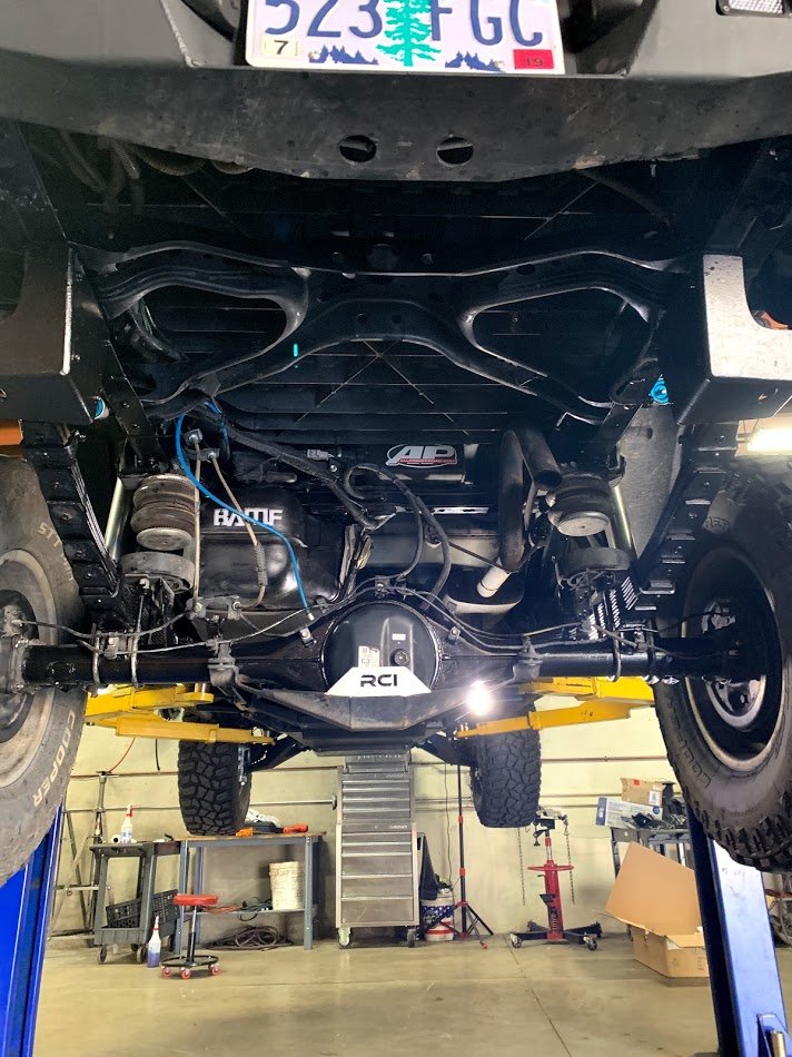

    ive offroaded mine for almost the life of the truck with daystar cradles/firestone bags so they free float, i air them down when i need the full range of travel. pretty much an adjustable bump stop

    Nice setup, what leaf springs are you running? How does the truck handle off road with the airbags inflated and a moderate load?

    they run perfectly fine with a loaded truck on trails
    with the right pressures in the tires its no different on road. im on the ap expo v2 springs

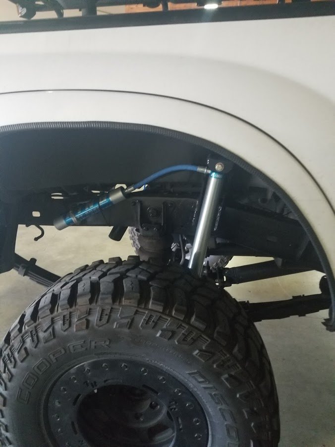

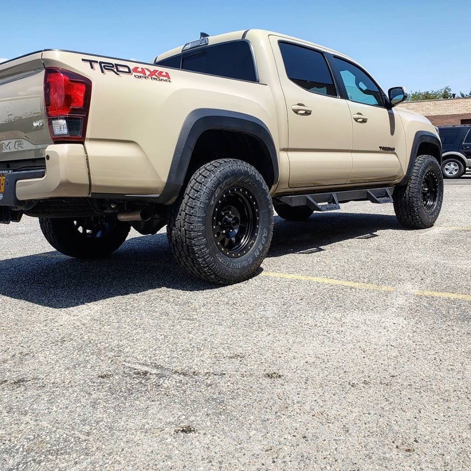

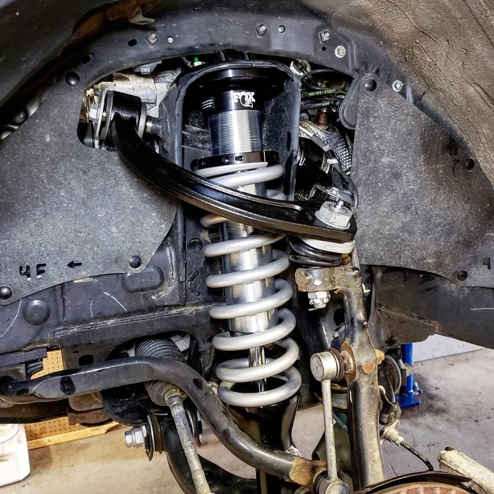

    Just got my trucks suspension all settled. FOX LIFE! Could not be happier with how it looks and rides. Rear is a bit stiff as expected but over the ride is buttery smooth.
    -Fox 2.5 Extended Coilovers
    -SPC Upper Control arms
    -Fox 2.0 rear shocks w/ resis
    -Headstrong AAL System
