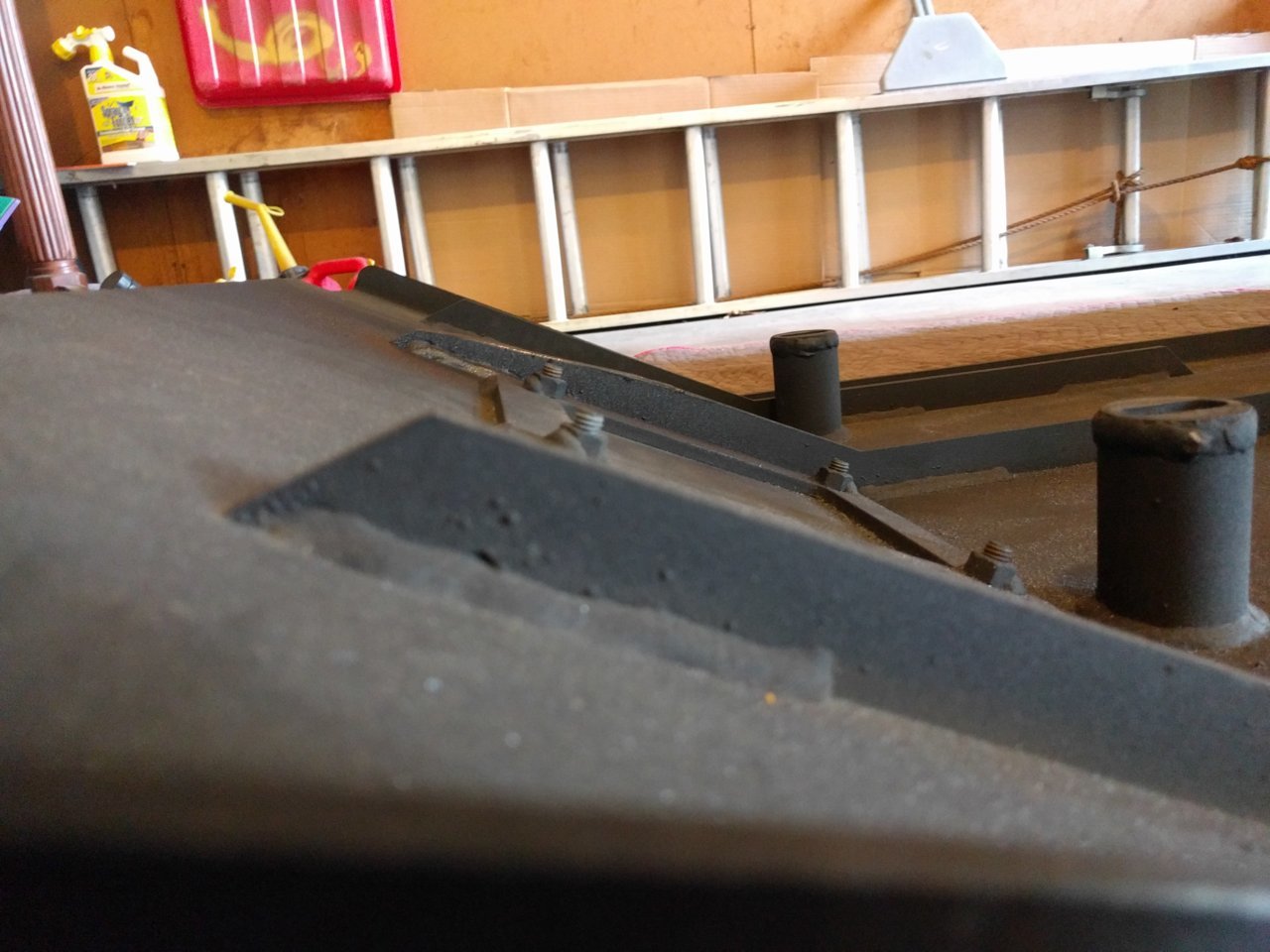

    Trying to identify where this creaking noise is coming from after speed bumps or compression of the spring after install. Inside the truck it sounds like its from the front. Any ideas? Something need to be lubed up?

    I'll check on lunch break. But silicon spray makes for a good tool to hunt down noises. Spray one suspect area at a time

    90% sure, that is your sway bar rubbing against your skid plate. Swaybar relocate bracket pushes it too far down and it contacts the skid.

    Not sure what that is. But it doesn’t sound like it’s coming from the coilover or the UCA. It’s after the fact. I have the same coilovers and the pro skid too. I haven’t had any contact issues with the sway bar and skid. But I’d check and make sure the sway bar relocate bolts are tight..
    Did you have a CMC done?

    This was my exact issue after re-installing the swaybar with the relocate kit. No factory splash guard but my Mobtown IFS skid needed an angle grinder taken to it in the center on a piece of metal that reinforces the skid. Shaved some metal off. Sound gone.

    you could just delete the sway bar. easypeasy.

    It was happening before skid plate install.
    Thanks will check those bolts
    I just started to think it was UCA after rewatching again. The closeup shot of the spring shows the creaking just as the UCA is moving.
    I have a CMC getting done on Monday.
    Might remove sway bar and skid and test.

    Ok.. honestly it’s strange.. the noise seems delayed. I had noises after my cmc but it was the body mount washers creaking against the cmc plates..

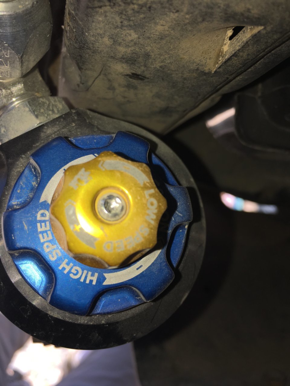

    ok a noob question::anonymous:
    I got the 2.5 rr dsc with TWO dials on the rr. (1st gen DCSB, custom plate bumper, winch, skids which connect to the bumper and the frame)
    The preload is as set from the factory.
    Ran DVNP and the Saline wash boards are legendary.
    I didn't adjust anything and now I was thinking that that would have been the best place to do it..
    So can someone explain the dials?
