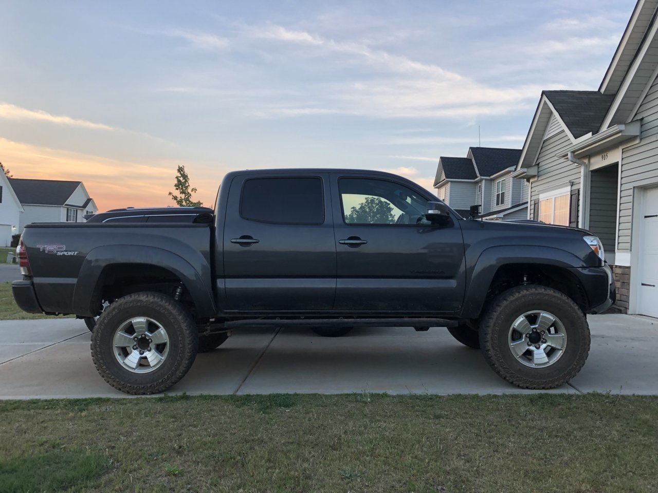

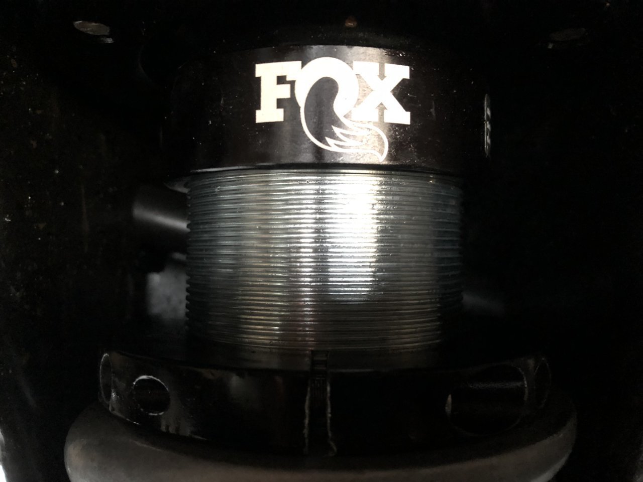

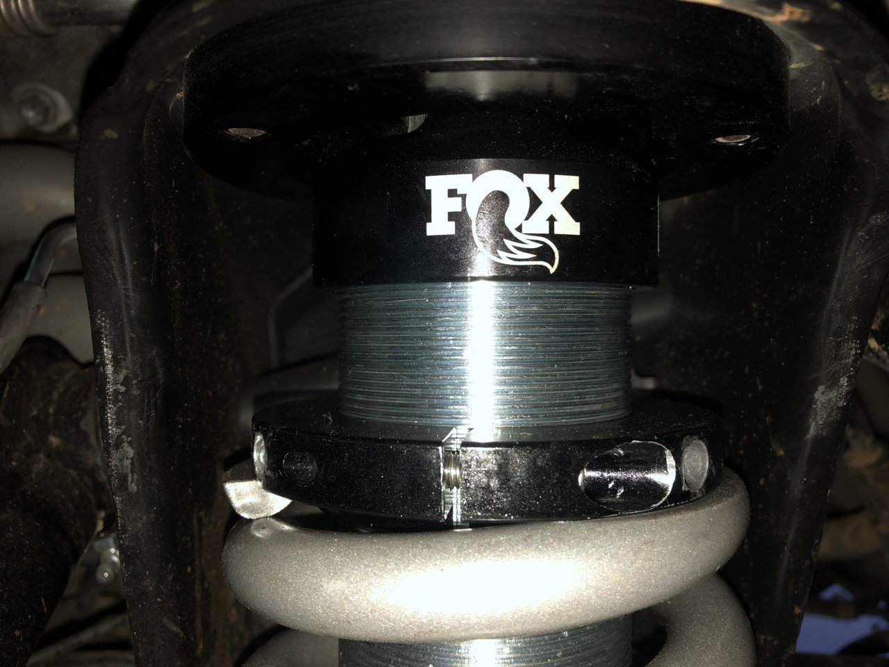

    Swapped out my 13"/600's for 14"/650's and couldn't be happier.
    Driver side preload:
    *Preload = 1-5/16" or 17 full threads VS 3-1/4" with 13"/600's
    *Full droop = 12" spring at full droop VS 10-1/4" with 13"/600's
    *0" preload = 13-1/4" installed w/ ring completely backed off VS 3/4" full threads at 12-1/2" with 13"/600's
    Passenger side:
    *Preload = 1-1/16" or 14 full threads VS 2-5/8" with 13"/600's
    *Full droop = 12" spring at full droop VS 10-3/4" with 13"/600's
    *0" preload = 13-1/4" installed w/ ring completely backed off VS 5/8" full threads at 12-5/8" with 13"/600's
    Guestimating ~2" of rake, but I still need to take more measurements at some point and get another alignment. Night and day difference in the trucks mannerisms and handling now.

    The 13"/600's were a give and take scenario. To achieve some semblance of drive-ability and not chew through my tires, I had that asinine amount of preload. On the flip-side, doing so really screws with the springs functionality and throws the up/down travel out of wack. The end result is a "pins and needles" driving experience avoiding all things pothole and the like.
    With the 14"/650's now installed, it's an entirely different scenario regarding the preload, travel, CO's overall function and performance, etc. Also, the overall driving experience is no longer a harrowing ordeal.
    I hope that provides a little more clarity and insight on my particular situation. :thumbsup:
