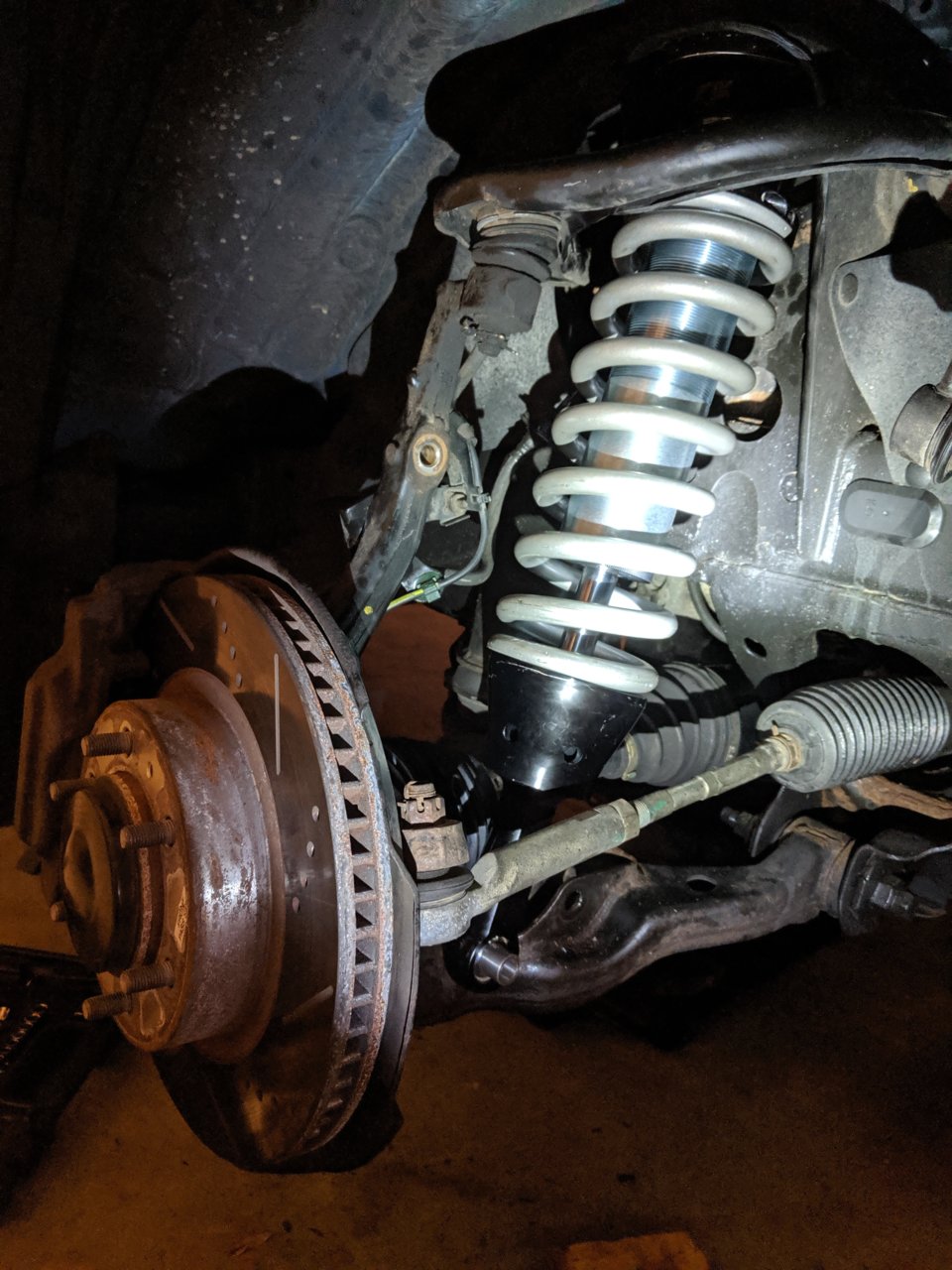

  11. Jun 2, 2019 at 3:36 PM
    #1551
    Z slice
    Z slice Well-Known Member
    Mar 2, 2019
    #285068
    52
    2010 Tacoma V6 TRD Off Road 6spd
    2018 - Installed touchscreen stereo with new speakers. no sub or amp. 2019 - Ultimate Headlight +foglight upgrade from Crashnburn80 - Fox 2.5 non-res upfront -fox 2.0 w/ res in back -3rd Gen TRD Pro Wheels w/ Falken wildpeak 265/75/R16 -bed mat
    Need help with installing Fox 2.5 non res in the front...
    Had a terrible time trying to line up the shock.
    We disconnected the sway bar which helped, but the lower control arm still sits too high to allow the shock to swing in to place.
    What is the preferred method to getting the lower shock bolt lined up? Is a shock compressor required?
  12. Jun 2, 2019 at 3:45 PM
    #1552
    Hookedup
    Hookedup Well-Known Member
    Jun 27, 2014
    #132830
    773
    SOFLO
    2012 DCSB SPORT/ 2019 OR DCSB
    FOX 2.5 DSC/ICON RXT/SPC UCA
    You can use a jack to compress the shock into position and slide the bolt into position
  13. Jun 2, 2019 at 4:30 PM
    #1553
    Rd62
    Rd62 Well-Known Member
    May 16, 2018
    #253683
    366
    2014 DCLB TRD Sport
    I used a long pry bar on the lca to force it down allowing me to seat the shock

  15. Jun 2, 2019 at 5:32 PM
    #1555
    Kwikvette
    Feb 27, 2019
    #284735
    81,735
    Fresno County
    4 run, 2 don't
    Ok, enlighten me.
    I've got multiple cars; they each sit low naturally. 2 of them have different purposes as well; straight line and the other is for cornering/handling.
    I've never owned a vehicle that was even slightly lifted.
    Having installed the front 2.5 CO's, there was a noticeable improvement in absorption. I have washboards/dirt roads/etc. where I live and the front end just soaks everything up. This is with a stock front end (no additional weight/bumper/winch etc).
    The rear end has a slightly-heavier-than-stock tube bumper. The Fox 2.0's I installed were very hard to compress by hand if that says anything. Going over those same roads, the rear end of the truck feels stiff, as if my shocks were just long 2x4's. Even had another TW member push down the rear end of the truck and the truck didn't squat at all with his weight.
    Installing the Bilsteins was a cake job as I was able to compress the shocks much easier.
    I was just thinking Fox may have a shock "valved" for the lighter weight of our trucks?
  16. Jun 2, 2019 at 5:43 PM
    #1556
    Z slice
    Mar 2, 2019
    #285068
    52
    If I use a jack under the shock, how will I get it to the LCA mounts without having the shock decompress?
    Is there a bolt or a tie rod that I need to remove before the LCA can be forced down? Right now, this is where I'm at on the Front Passenger.
  17. Jun 2, 2019 at 6:04 PM
    #1557
    cmbondo
    cmbondo Well-Known Member
    Feb 2, 2014
    #122060
    564
    San Diego CA
    2021 Cement DCSB TRD Offroad
    FOX 2.5 DSC and some other stuff too.
    It looks to me as if your UCA is limiting your down travel. Separate the UCA ball joint from the spindle and see if it drops.
    wi_taco and Hookedup like this.
  18. Jun 2, 2019 at 6:05 PM
    #1558
    Rd62
    May 16, 2018
    #253683
    366
    2014 DCLB TRD Sport
    I disconnected the spindle from the upper control arm to install mine.
    Disconnect the wheel speed sensor and brake lines from the spindle. Secure the spindle with some heavy wire to keep it from damaging the same. Use some needle nose to remove the retainer wire from the castle nut then remove the nut. You'll likely have to give the spindle (not the ball joint) a couple of hard wacks with a sizable hammer to get the ball joint to pop loose of the spindle. I used a small hand sledge.
  19. Jun 2, 2019 at 6:05 PM
    #1559
    Yetimetchkangmi
    Yetimetchkangmi Well-Known Member
    Jun 19, 2013
    #106605
    3,543
    Benjamin
    Newcastle, WA
    03 Tacoma 4x4 The Yeti
    ARB front locker, Custom high clearance rear bumper, Custom plate front bumper, mile marker winch PE8, safari snorkel, Deck Plate Mod Fox 2.5 rr DSC, Camburg UCA, squeaky Dakar leafs, 5125 10" and custom 7.5" shackles, thee finest PNW pinstripes, MT-R, Nissan crew cab roof rack??? wtf is that about??? Allpro skids, Rigid duallys President McKinley CB with PA Recaro SRD with Wedge Engineering Morimoto retrofits Champion Rad - Failed Tundra brakes
    You have a couple of choices to make and assuming you are doing this solo:
    1. Since you don't have aftermarket UCAs, it makes a challenge to lower the bolt on the UCA = not an option.
    2. Disconnect outer tie rod (gently), then disconnect the lower ball joint. This will lower the lower control arm but then you will have to use a jack to move the lower control arm up.
    3. Use a bottle jack between the upper control arm and the inner fender well to push down the upper control arm. Make sure your lower shock races are correctly aligned. = probably the quickest option to get you going.
    drewhaus likes this.
  20. Jun 2, 2019 at 6:20 PM
    #1560
    drewhaus
    drewhaus Well-Known Member
    Feb 28, 2018
    #245938
    241
    Andrew
    El Granada, CA
    2018 Tacoma
    I wouldn’t mess with the UCA here, drop the lower ball joint and make sure you have a bottle jack under the LCA so it doesn’t swing out and hit something.
    This video should get you going, good luck.
    https://youtu.be/IOW-FRDl5wg
