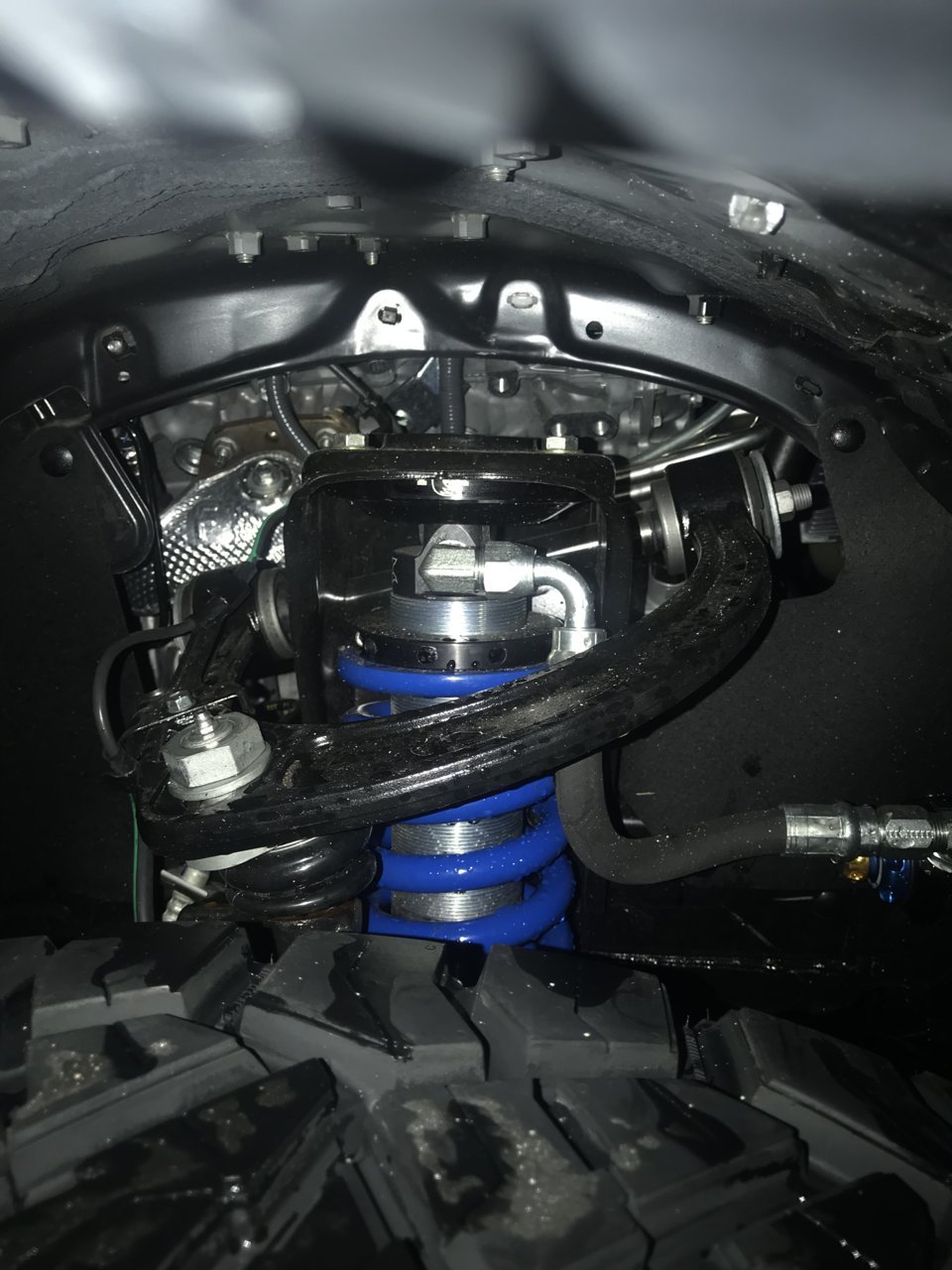

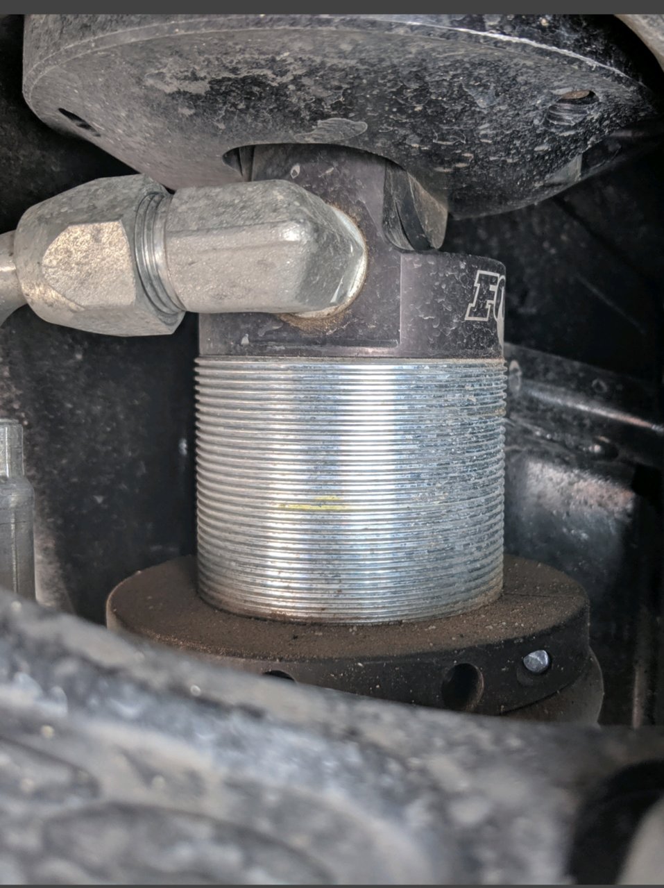

    How much preload are 3rd gens running with the King 14" 600's?
    Below is what I'm running (13" 600) and I like the stance, but not the ride. The amount of threads was the max recommended. (I'll get hub to fender measurements this evening) That's why I'm looking at the King 14" 600 and put less preload.
    Edit: hub to fender measurements - driver (23" 3/4) passenger (23" 1/4)

    You might look at going to heavier springs if your preload is maxed out. That would probably help more than going with totally different shocks.

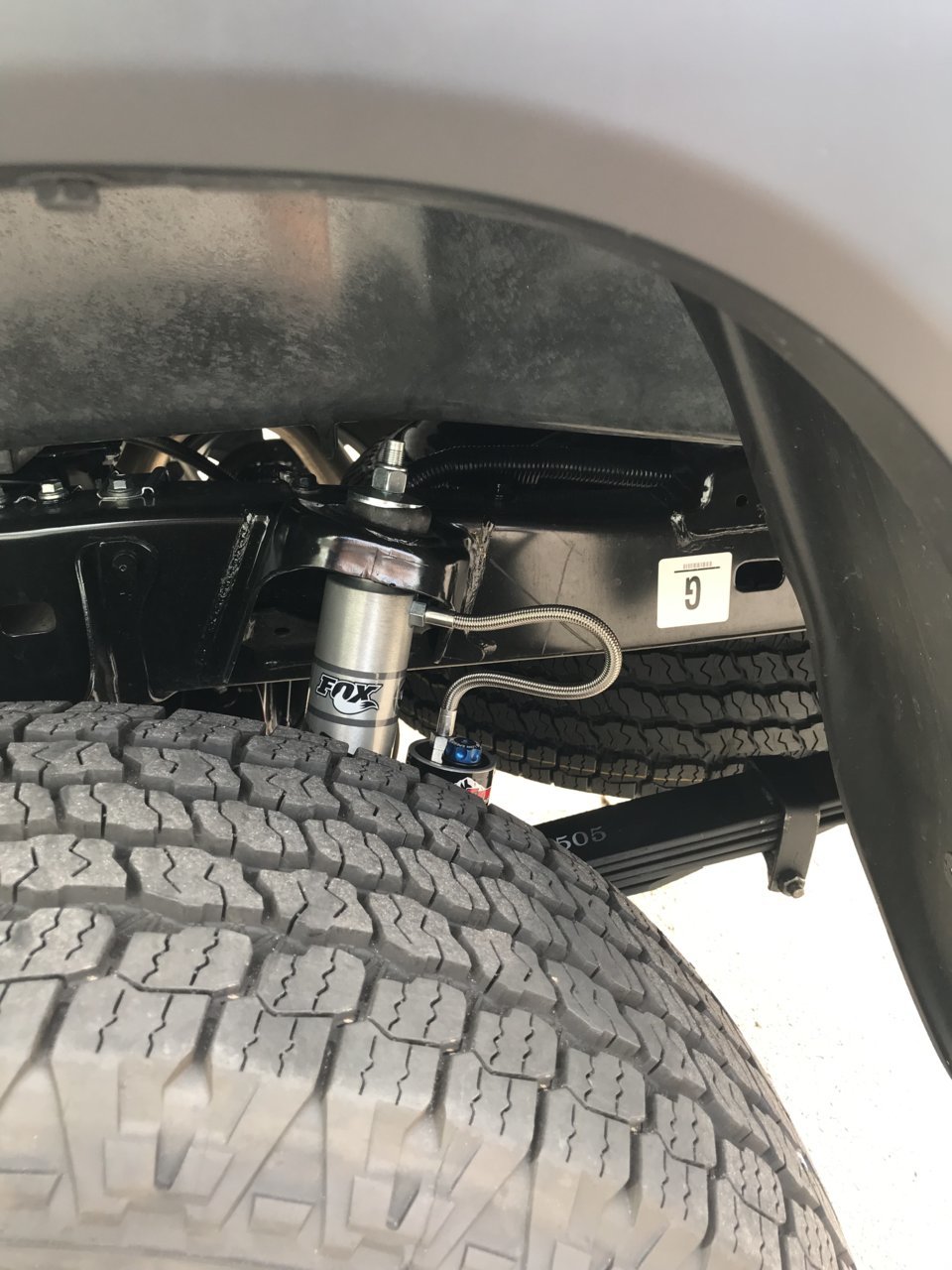

    i did this and am very happy:

  13. Jun 27, 2019 at 7:17 PM

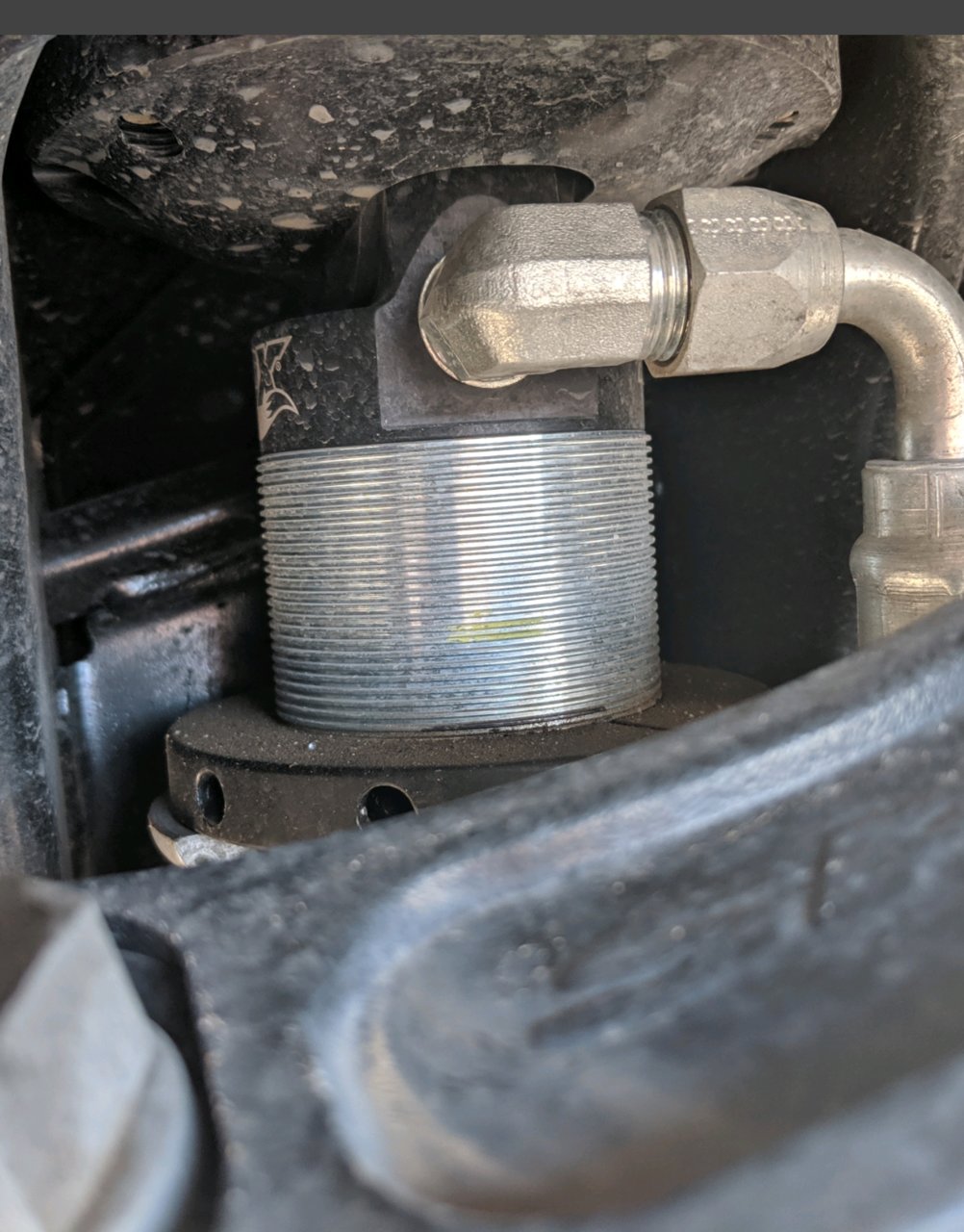

    E0928245-C3AF-438F-99C5-AF8895C7BE0A.jpg 23.5”ish driver and passenger. No added weight

    Did you run any spacers with the superbumps?

    So about 8 threads. Thanks!

    no spacers. I have the medium dakar pack so I'm about +2" and have the fox 2.0's for 3-5" lift. the 118's if iirc. my little rubber bushings on the shock shafts usually have about 1/2"-3/4" from bottoming out, so I'm pretty happy with the spacing.

    That’s my passenger side.. i believe driver has a bit more ‘pre load’ to compensate

    Yeah compare that to my passenger side...

    Pretty sure you’re ok.. it does look like a lot.. but how’s the ride??
