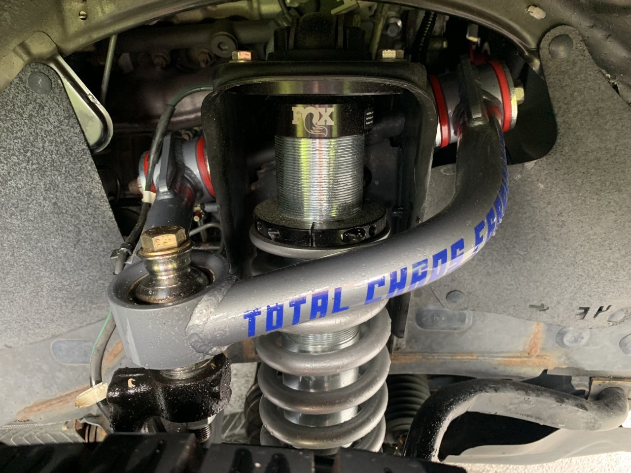

    Jpiskura
    Jpiskura Well-Known Member
    May 23, 2013
    #104773
    536
    A0DB5233-FE2B-4317-8996-FF01AB3ABBA4.jpg Really no added weight.. I have the C4 life pro winch bumper but that weighs no more than 75-80 lbs.. but there is a good amount of preload in order to get my height I wanted to.. And E rated 285s.... And speaking of the E rated tires... what psi should I be running on a truck that primarily sees pavement to simply get back and forth to work every day..? Think I’m at 35ish now.?
    13txtaco likes this.

    switching from 13" to 14" won't make your ride any better. it's the valving of the shocks that you'll want to adjust to your liking. if you're going to swap coils, get them tuned to your liking. and alignment - yes for sure.

    If they're both 600 # coils and your sitting in the proper sag of the stroke of the shock, no. They will ride the same. Turning the collar down for setting ride height doesn't put any more or less force on the spring. The trucks weight puts force on the spring and that is going to be constant no matter where you set that collar. Again, this is only the case when you are within the proper sag for the stroke length of your shock. Turning the collar too much can cause too much lift, reducing down travel and cause a rough ride. Same goes if not enough lift and your riding your bumpstops the whole time.
    Now 14" 600# coils can support more weight than 13" 600# coils. Almost as much as 14# 650# coils. You can read more about that on Accutunes website. https://accutuneoffroad.com/articles/coilover-spring-rates-for-toyota-tacoma-4runner/
