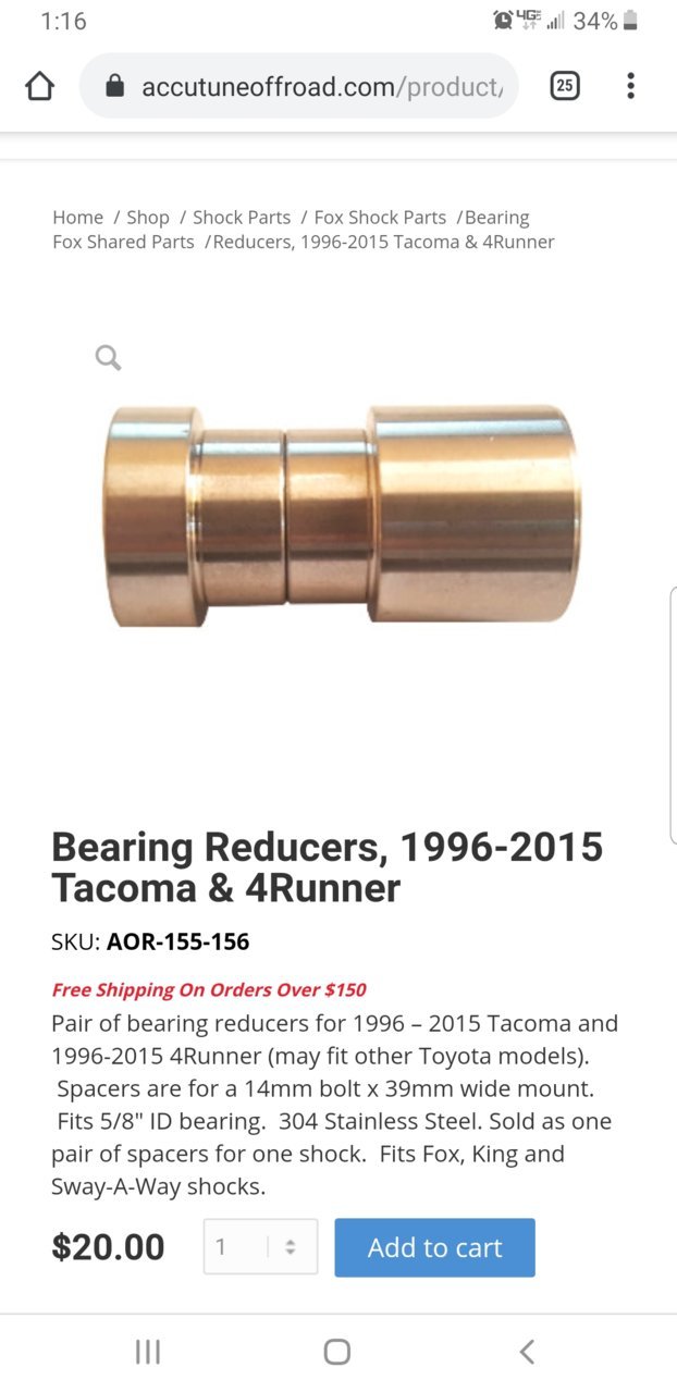

    Quick question regarding 1st gen 2.5 Fox C/O. Theyve been installed since May of this year however, my front end feels loose. It was immediately noticed after installation so i would say C/O related.
    I believe it's the spherical bearing and metal sleeve. Instructions state "install lower mount to LCA with longer spacer to rear of vehicle." However, there was only one spacer per side with a line marked in the spacer. Did they provide me with the wrong spacer?

    I remembered I couldn't reuse stock bolt/nut because it wouldnt fit through the spacer. Instructions say to reuse so I'm onto something. Do all coilover 2.5s come with this?

    #104773
    536
    yes those are like the ones Fox sends with all their shocks

    Got it. Problem is I was sent a a single 1/2" spacer for each side - which went through the spherical bearing and reached the LCA (a few MM's short actually). Stock 14mm bolt didnt fit for obviously reasons so I had to source a smaller one. Let's hope the LCA holes didnt get elongated!

    Mine came from Accutune with the wrong bushings installed but the "right" ones supplied in the box. So I had to swap them. Also, I say "right" ones as they were the correct ID but were too wide to fit between the mounting tabs. Had a bitch of a time installing the lower shock bolt because the bushings were not quite right. How hard is it supply the right bushing? I'm not the only one either. Apparently this is the bushing they think is the right one or close enough. It's just piss poor service. They claim to have all this knowledge about shock tuning and can't even be bothered to supply the correct parts.
