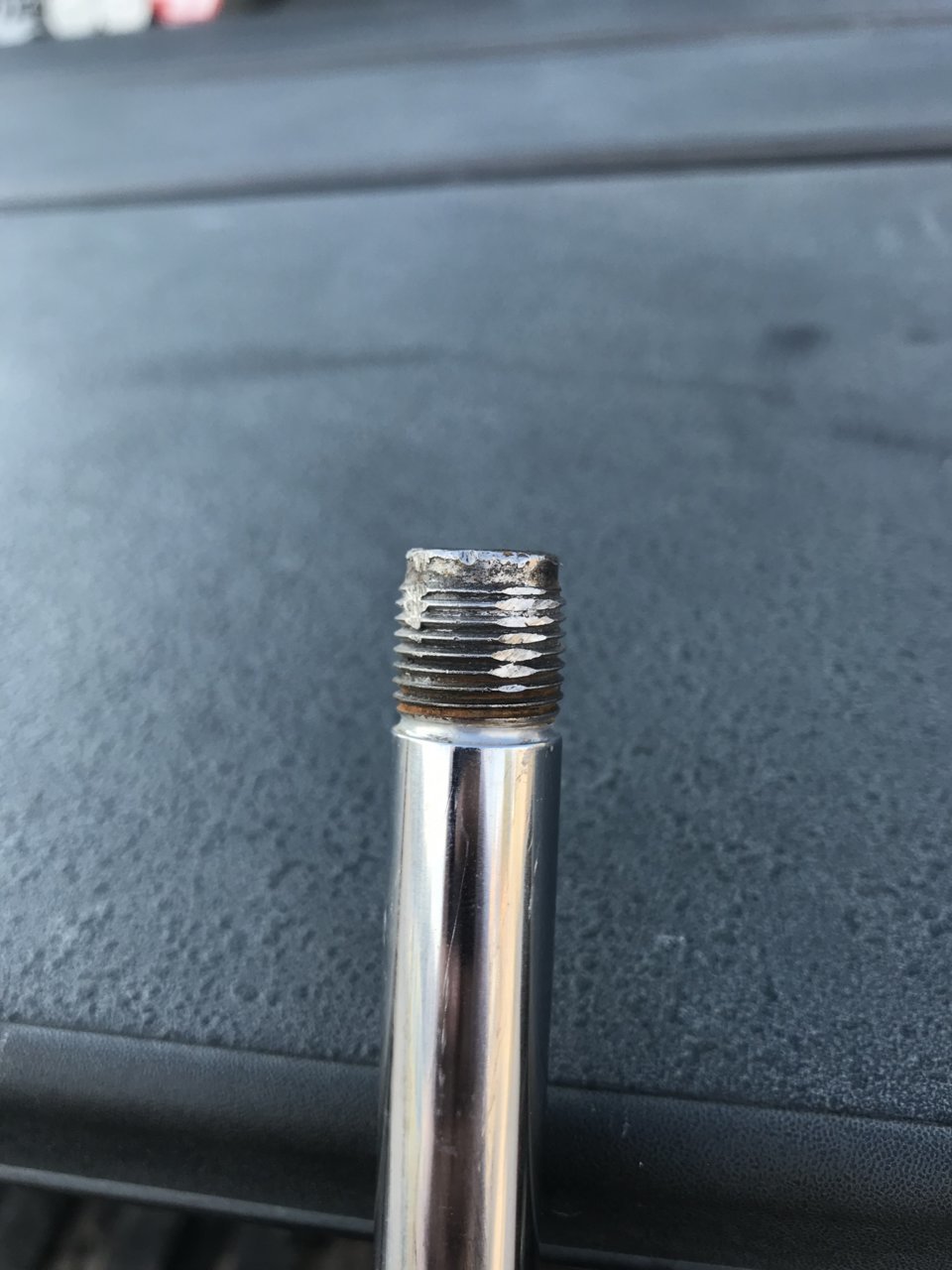

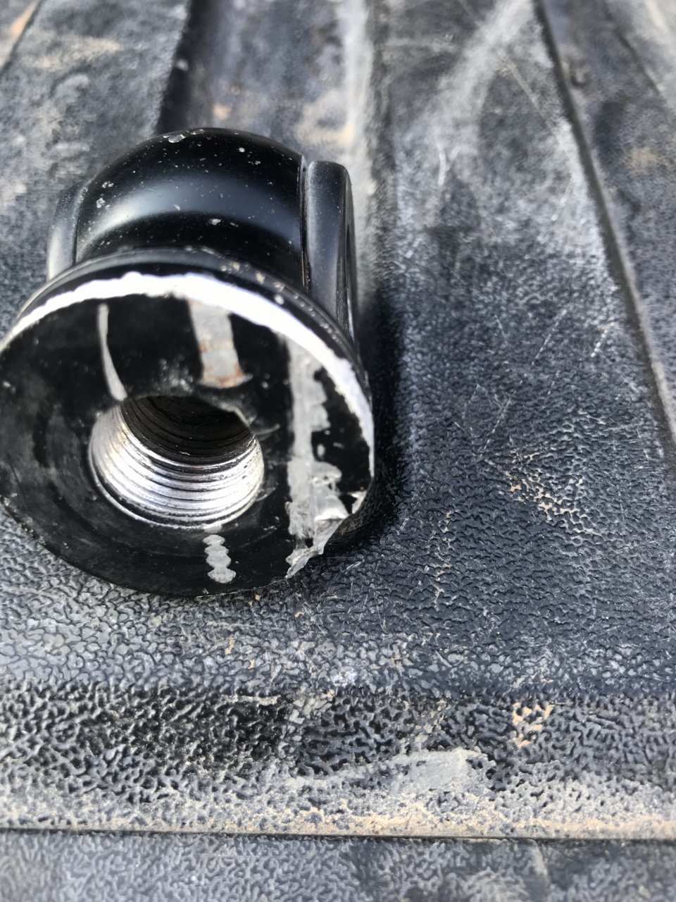

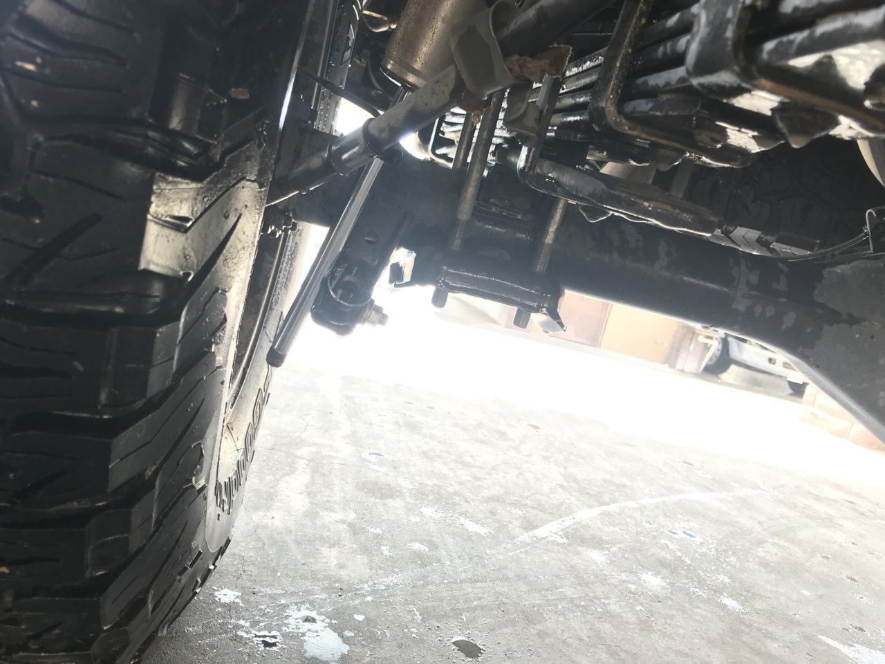

    If they appear to have pulled out, its probably because you are lifted too high in the rear and ran out of down travel.
    The extended length on rears (985-24-117) is 23.80”
    If your up 2-2.5", your eye to eye ride height is probably around 21.5" leaving your 2.3 inches of droop. It's not enough.
    Measure eye to eye at ride height and subtract it from 23.8".
    For what it's worth, I had a similar problem with too little available down travel after installing dakars and switch to the Fox 985-24-108 that have 25.3" extended length.

    You’re right, it does measure around 21 from eye to eye. I asked the online store where I bought them, if the 23.8 were enough for the add a leaf that I have and they said yes.
    I’m still surprised though, I haven’t done anything extreme

    I’d send them to @AccuTune Offroad for repair ask them to build you a set with more travel longer - Then sell the ones you had repaired. An extra 1.5” doesn’t sound like a lot, but it really is significant.
    You could probably use a tap and die set to rethread both shaft and mount, but unless you already have a t/d set, a good bench vice, and a block of some kind to hold the shaft in the vice, it’s probably easier and cheaper to send them in.

    I was thinking about that but the repair may end up costing more than the shocks.
    I thought about repairing the shaft but I can’t seem to find the part number for the mount 3619BACE-9A0B-47E0-91D2-E7CBCC51B28B.jpgA9E05D44-BB62-4588-8D08-D74E3095D24F.jpg
