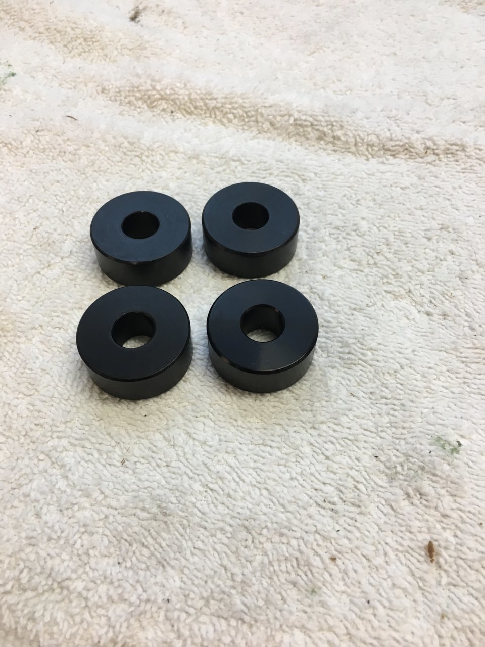

    IMG_9328.jpg Installing my 2.5 extended travels and I didn't know they came with the sway bar relocation spacers. Everything went together smooth. Just wondering what these are for...???

    Don't make me read back through all of this but will I need a sway bar re locate to clear the 2.5's up front?
  11. Apr 4, 2018 at 6:38 PM
    #171
    MCDavis
    MCDavis Taco life is over. Full time 4wd for the win.
    Nov 24, 2017
    #236768
    664
    RIC, VA
    2017 TRD Sport 4wd (SOLD) - Currently in a 2016 GX460
    It’s recommended, yes

    Yes. And the Fox 2.5 come with the sway bar relocate.
