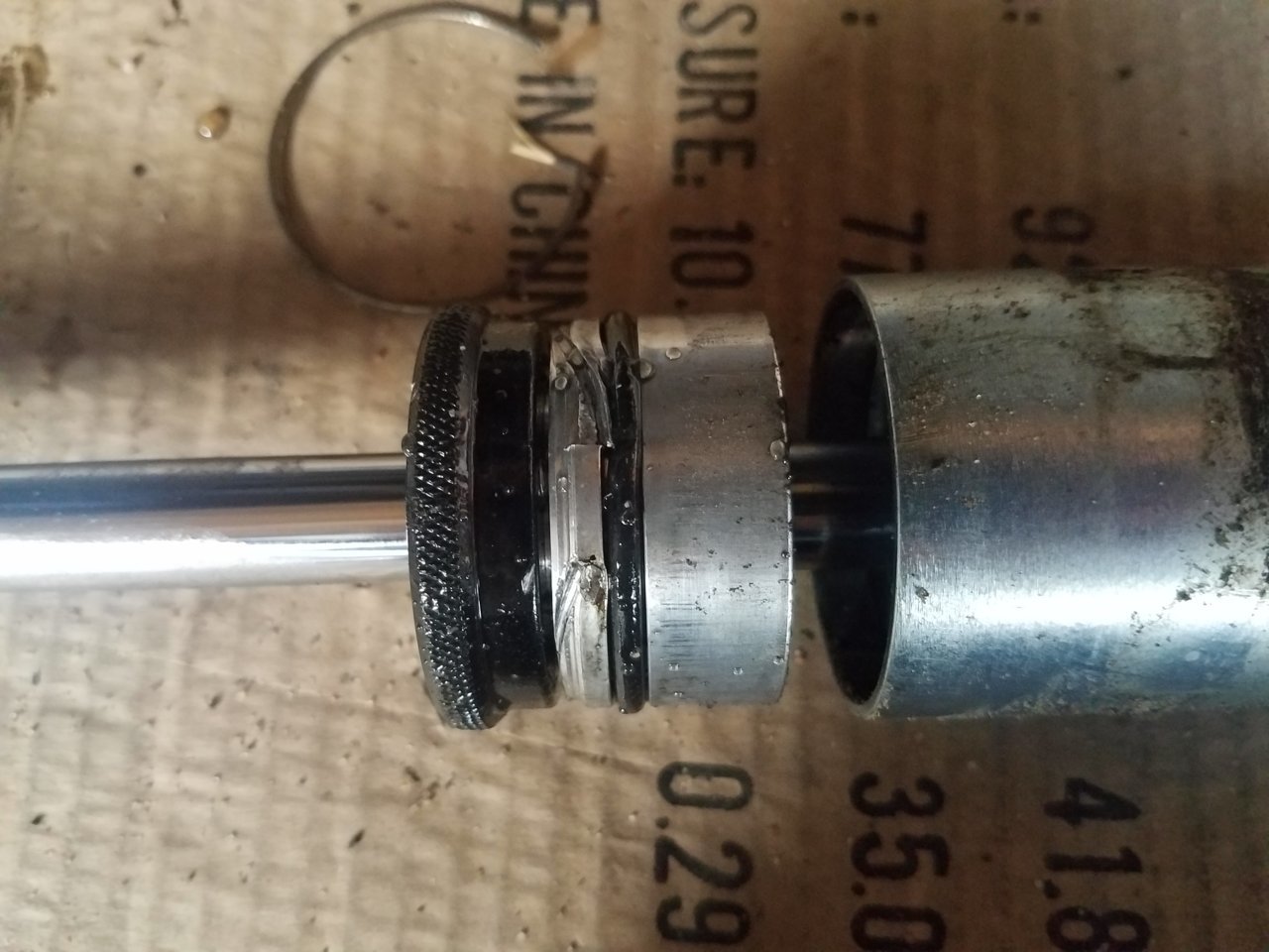

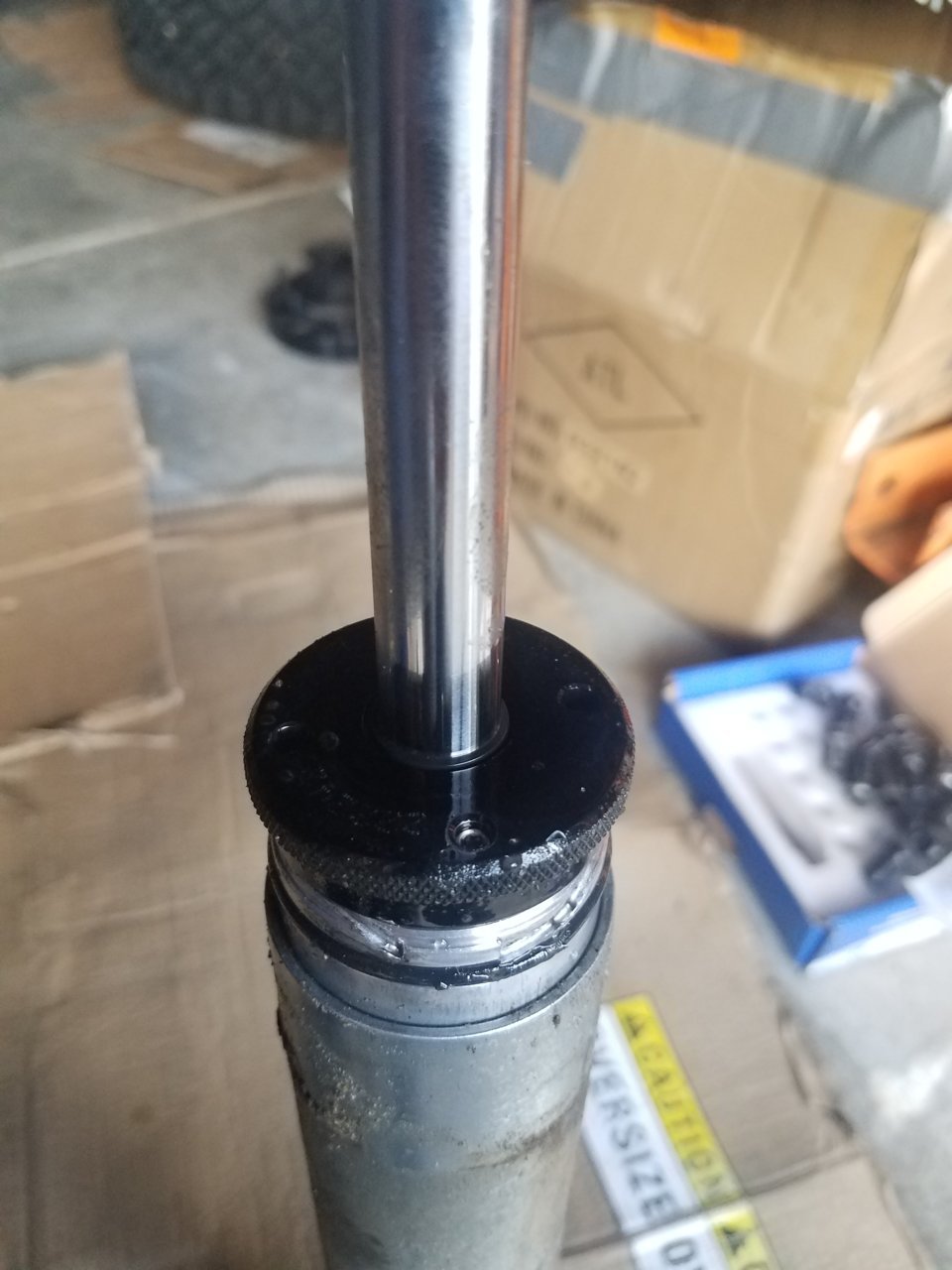

    Hauled a two ATV trailer this weekend and blew out one my rear 2.0 Fox LSC Remote reservoir shocks... Was this my fault? Or was it a defective shock?
    There was enough downward force that the aluminum cap snap ring groove completely deformed, snap ring came loose, and allowed the cap to come out of the shock body. Are Fox shocks not rated for towing? If not, maybe I was supposed to go with Kings?

    That doesn’t just happen cause you were towing. My guess is you were not bumped properly and you bottomed out hard with the extra tongue weight.
    Care to elaborate more on what exactly you were doing when the shock blew?

    It looks like it was improperly assembled, the snap ring wasn't fully seated.
    With a new seal head and they can be rebuilt.

    That's kind of what I was thinking as well. I purchased these from Accutune back in July during which they were doing free revalving on all new shocks and these shocks were revalved. I'm hoping to hear back from them with some good news...

    We've received your email, and will definitely be taking care of you.
