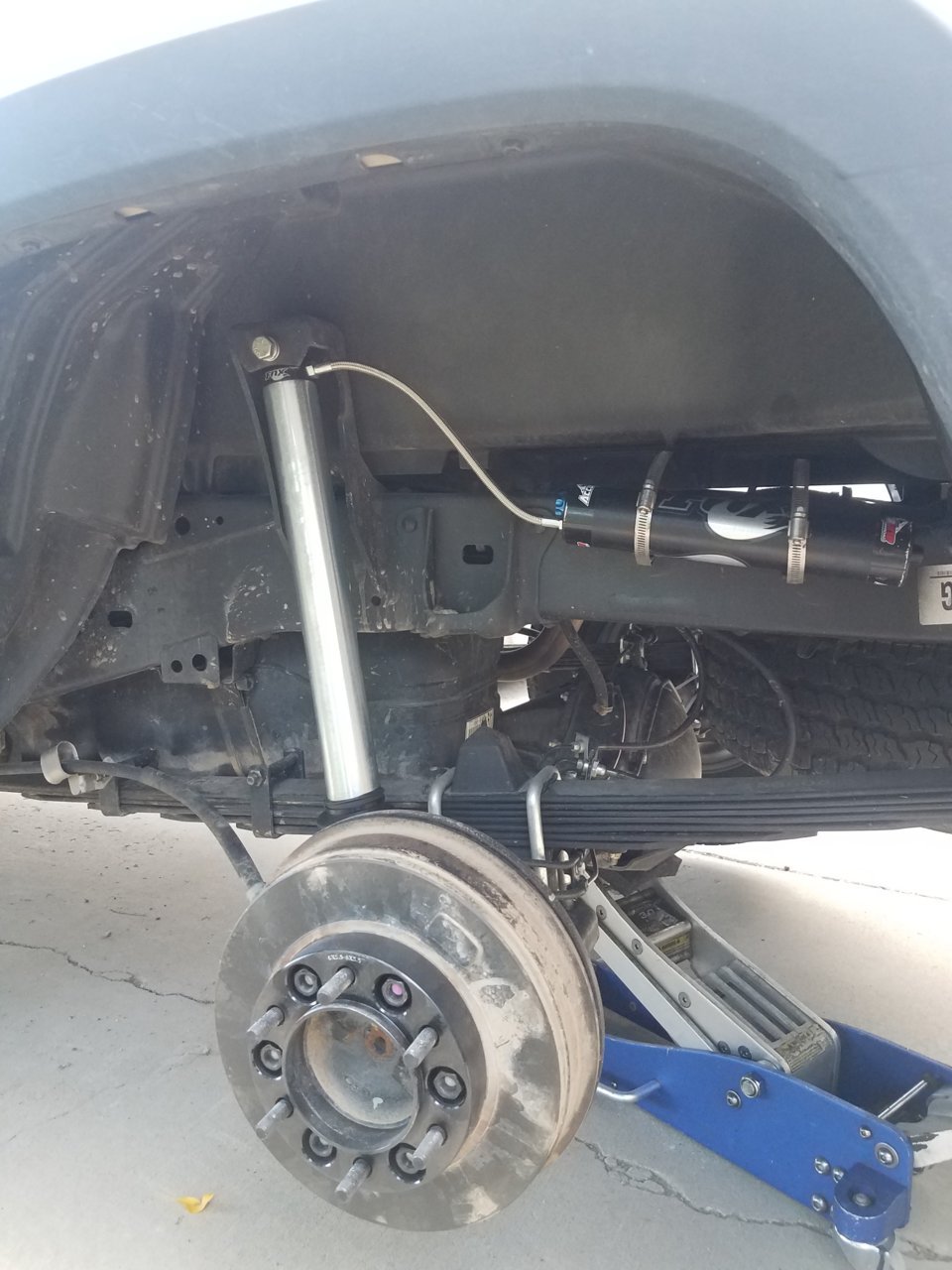

    Cant wait to install my front 2.0 IFPs and rear 2.0 adj res!
