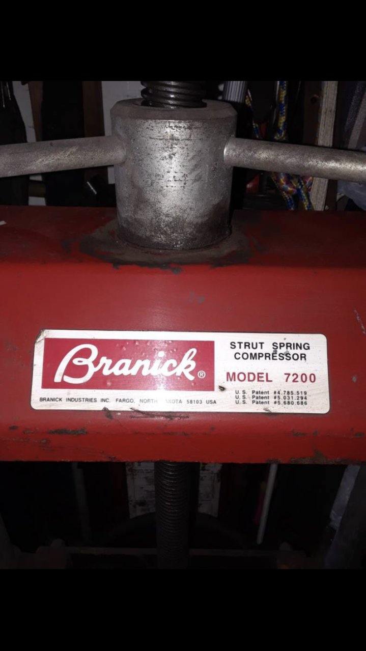

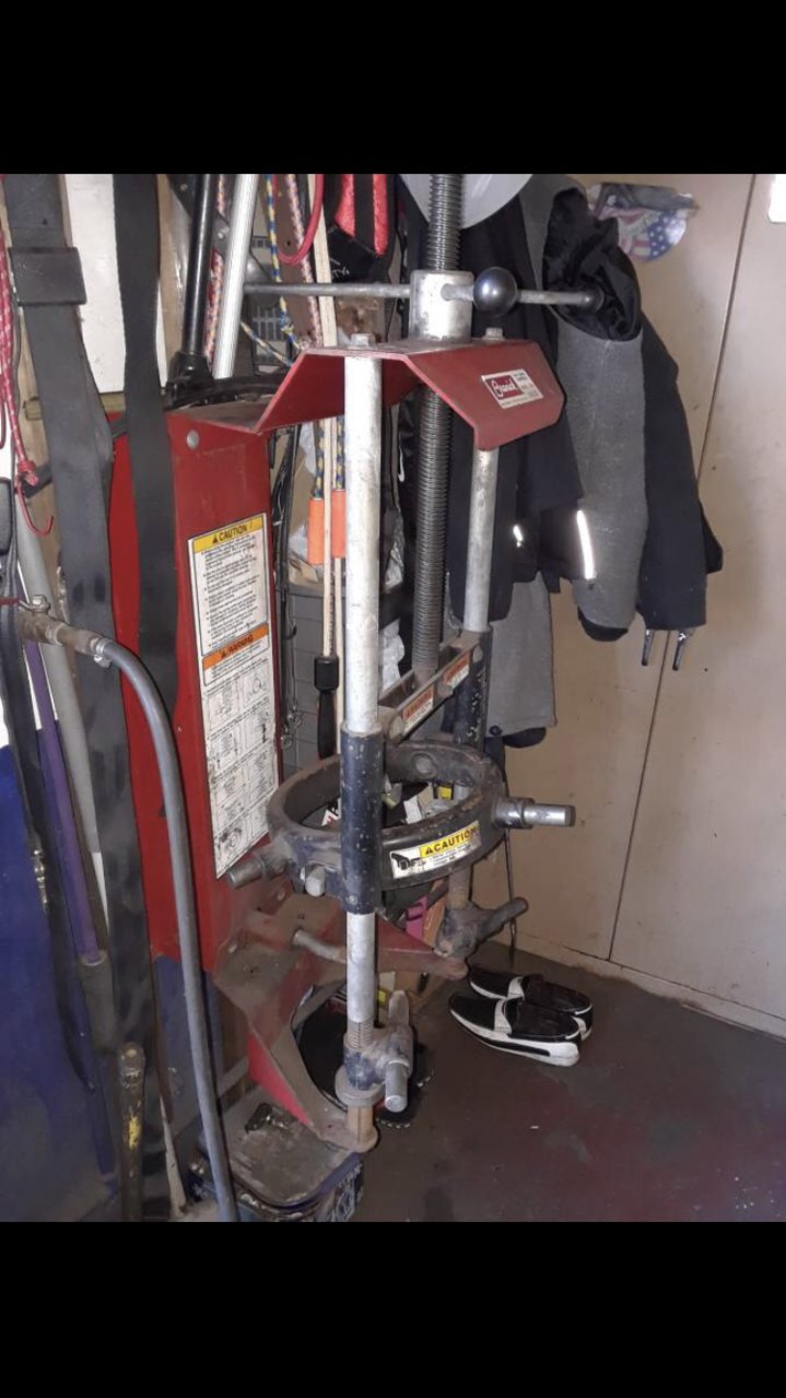

    I ended up fully closed on HS and 1 click from full open on LS for now. The extra caster I added to clear the 275 really has a negative effect on everything.
    I did the CMC last week and am having the truck realigned on Saturday.
    Also picking up a spring compressor tomorrow to mount in my shop so I can experiment with different spring rates.
