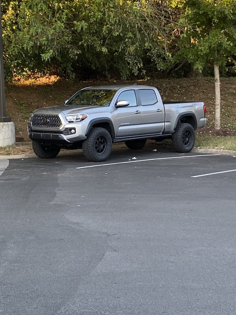

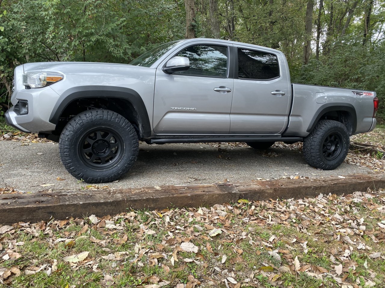

    ~Second post regarding my lift~
    2019 Taco OR QCLB
    2.5 Fox with DSC resis x4 corners
    Camburg UCAs
    Pro Comp ada leaf
    So I took some measurements today and my rear is sitting 2.5 inches above the front. I took the measurements from the ground to the edge of the fenders on all four corners. My rear is sitting at approximately 39 1/4, FD is sitting at 36 3/8 and FP is at 36 3/4. I’m looking to raise the front up to the max that Fox recommends at the 1.9ish inches of coil, but it sure does seem like a lot more rake than most right out of the box. I also have a Pro Comp ada leaf in the rear...but geez!
    Any advice welcomed. Getting the front adjusted Wednesday and a BMC, and I’m also having them check the caster and obviously the rest of the alignment. Any idea why the back would sit so off level outside of the front needing to be adjusted? Do these ada leafs give that much lift from the stock take? I was thinking maybe 1.5 inches and with the front being lifted would close that gap.

    Looks good to me. Put some weight in that bed and mob around for a few weeks, it should settle a little bit.

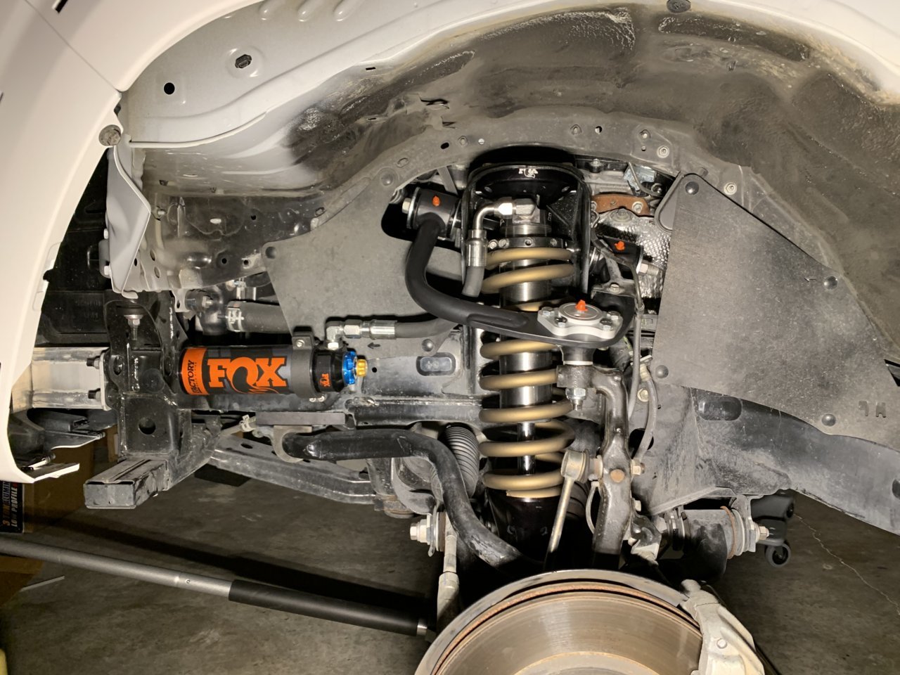

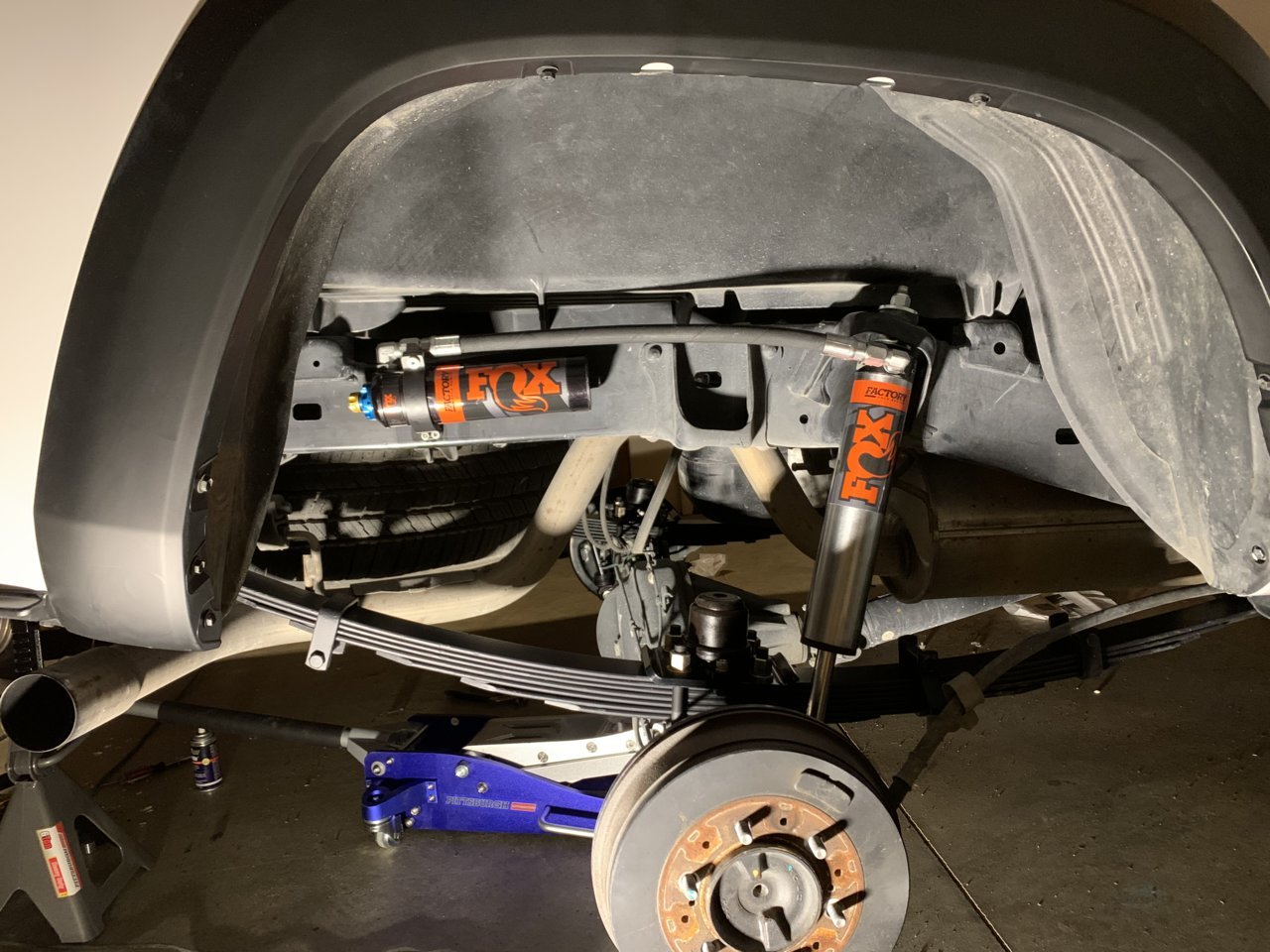

    By the way those that are thinking about cerakote, I cerakoted mine clear (MC-157Q) before installing, also cerakoted the springs and JBA UCAs. It's really not that bad to apply. I put 3M protective film on the resorvoirs and rear shock. Hopefully will keep rust away.
    1C7BC389-45FA-446E-9CC8-FB23795B1A4F.jpg 3839ADA1-4F09-4D86-B7E2-460793C6E7BB.jpg

    looks real good
