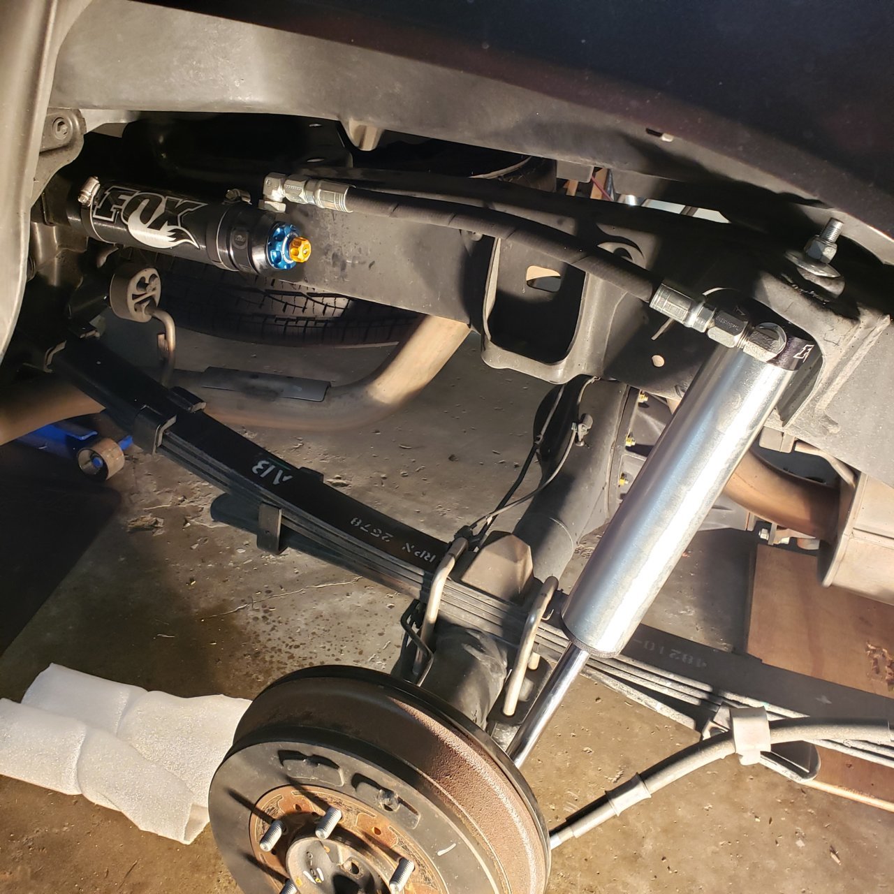

    finished install tonight. headed to pismo this weekend

    You don't have to have the top mounting nut so tight. There's a measurement in the installation manual. Back that thing off a little.

    the Fox Install Booklet said 5/8" shaft showing...seems way too snug to me also.
    Did I misinterpret the install instructions?

    Technically this is true, install guide however we make sure its snug enough, but not too tight.

    I think mine are right around there. I just made sure the shock body doesn’t turn anymore.
