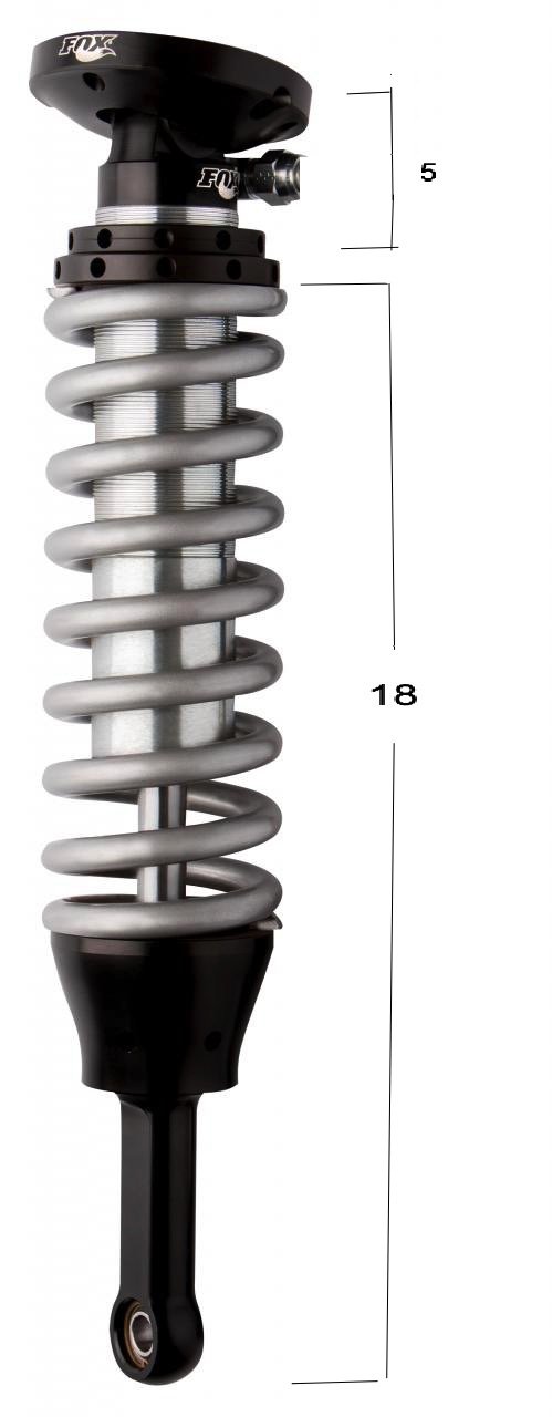

    23" from lower eyelet to top hat is way too tall and you are most likely topping out that shock. Max we recommend is 21". Measure those threads showing, how tall is that exactly?
    Do you have any additional weight up front or just want that tall of a lift?

    yes I have light bumper with winch, skid plate, rock sliders, and I would be happy if I could get 2.5" lift, that's why I change springs to 13" to 14" but the handling is horrible :(

    Did you get an alignment after adjusting? I have the same setup and 2.5” of lift made noise and ride like shit. First, the angles of your steering components are bad over 2” and can creat some binding. You might even be getting some coil bind. I came back down to 2” and my problems went away.

    Where are you measuring on the top hat from? I've got mine installed and having a problem getting the lift height I'd like. Hoping I don't need 14" springs as I asked for them 3 different times and was told I didn't need them.

    Hi, we are measuring from the top of the top hat (where it meets the chassis) down to the center of the lower bolt.

    So a little guesstimation then beings though the top hat sits up into the chassis a bit
