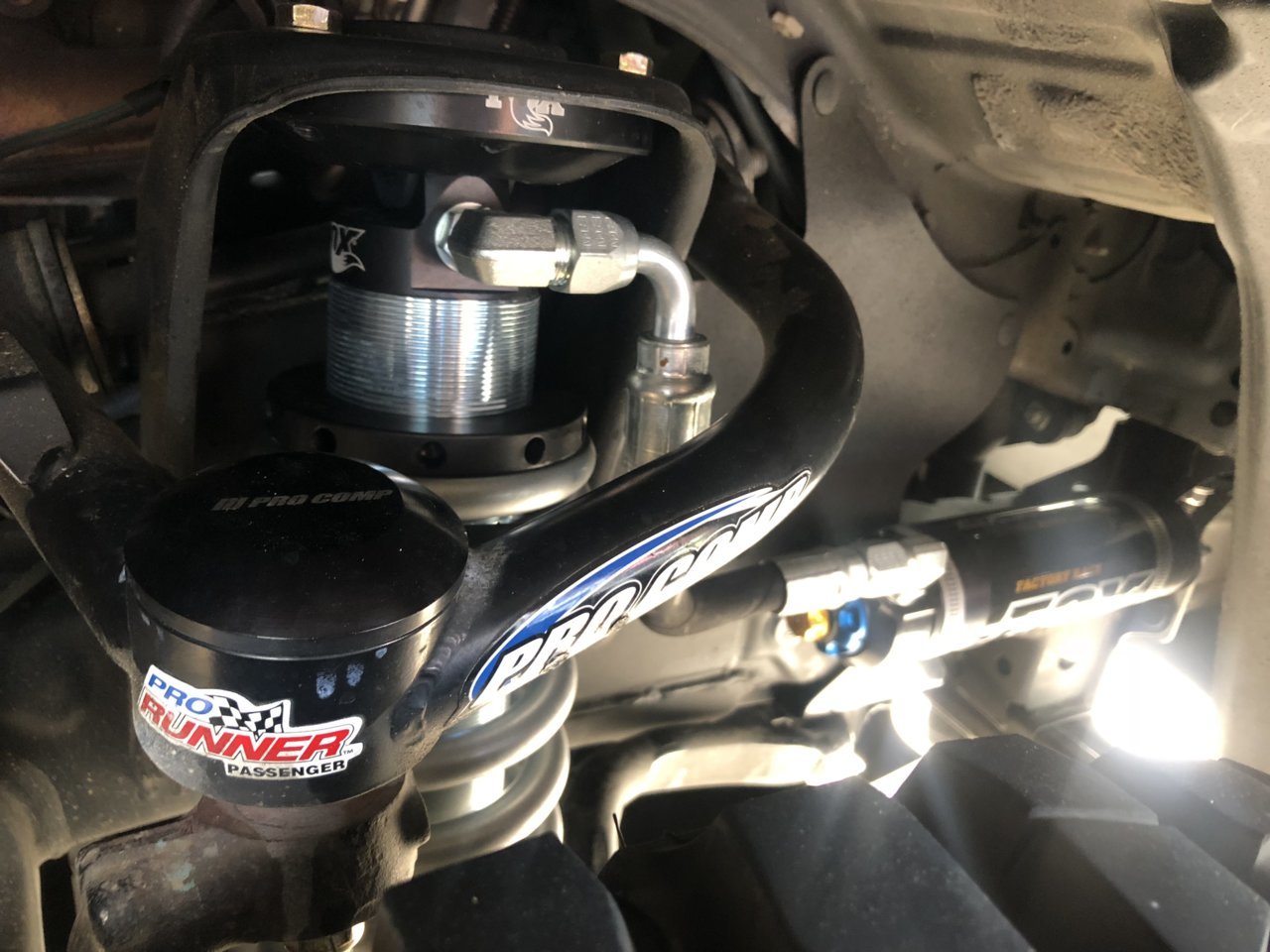

    I tested the continuity of the speed sensor and it’s good.. I took it off and it looks, clean, not damaged or broken.
    I removed the the wiring and tested continuity of the wires that run around UCA, there is a break in the continuity somewhere, the connectors or wire itself. I can’t find a break from looking at the wire.
    I tested the connection point under the hood and it’s getting 12 volts.
    So basically I narrowed it down to the wire, itself. 4WHEELPARTS had to have damaged the wire during installation of the fox coilovers. Pisses me off that they don’t own up to it.
    But I in the bright side I got to spend the afternoon under the truck with my daughter turning wrenches and getting our hands dirty.
    Does anyone know where I can get this wire?
    Watch the wires to the speed sensor(for the abs/vsc) they attach to your UCA. They get stressed you will run into what I’m dealing with. Can’t wait to get my rear suspension set up like you getting. Good luck

    Although I don't have any experience with it, I would imagine you will need to replace the wiring harness from the connection under the hood to the sensor unless you can find the break and splice or repair it. An illustrated parts break down should show the part.
    Hopefully someone with some experience in this problem will chime in.
    Edit: a quick Google search found this:
    https://toyotaparts.toyotaofclermon...g-Harness-Front-Left/48584149/8951604040.html

    @cmbondo I looked hard to find it.. must be under the sheath of the wire, or at one of the connectors. Both wires have no continuity. Both are broken somewhere..
    Is it possible to repair the connectors? The ones that plug into the sensor and under the hood.?

    Hell yeah thank you.. I may just order the sensor to just in case it is fried and I can’t tell.

    Take your meter and do a resistance check on the suspect sensor and compare it to a good one. If they show the same resistance reading then chances are the sensor is good.

    Good thinking, I’ll try it
