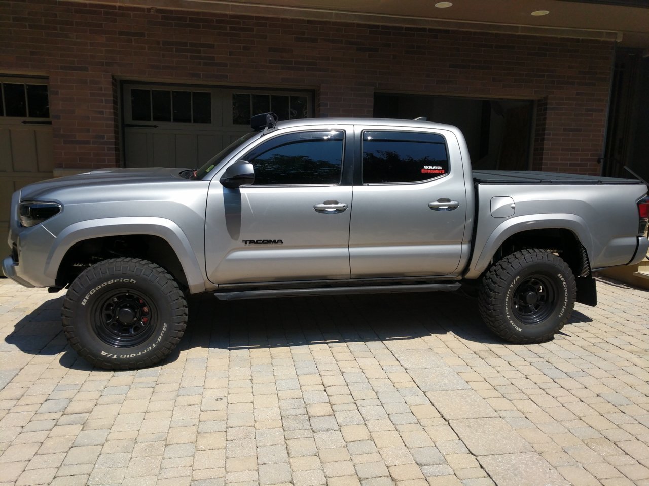

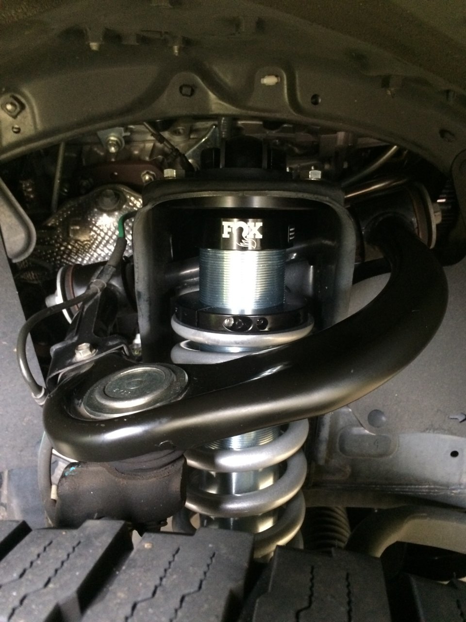

    I installed my 2.5’s right out of the box without adjusting them and ended up with 1” of lift up front. I’m still using my stock UCAs and my alignment shop had no problem getting everything within specs. The ride is great too.

    That looks like a lot of preload for just 1" of lift?? :confused:

    Those are the extended shocks so she preload is fine. :thumbsup:

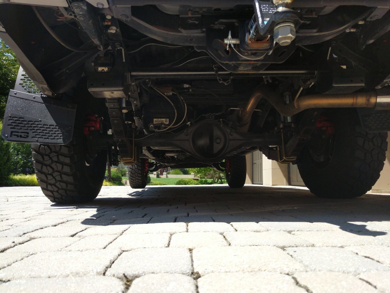

    Got some 700lb coils installed in my Fox 2.5 dsc/resi coilovers, and got all my rear suspension stuff installed a couple weeks ago with my Fox bypass shocks! IMG_20180731_095859_059.jpg

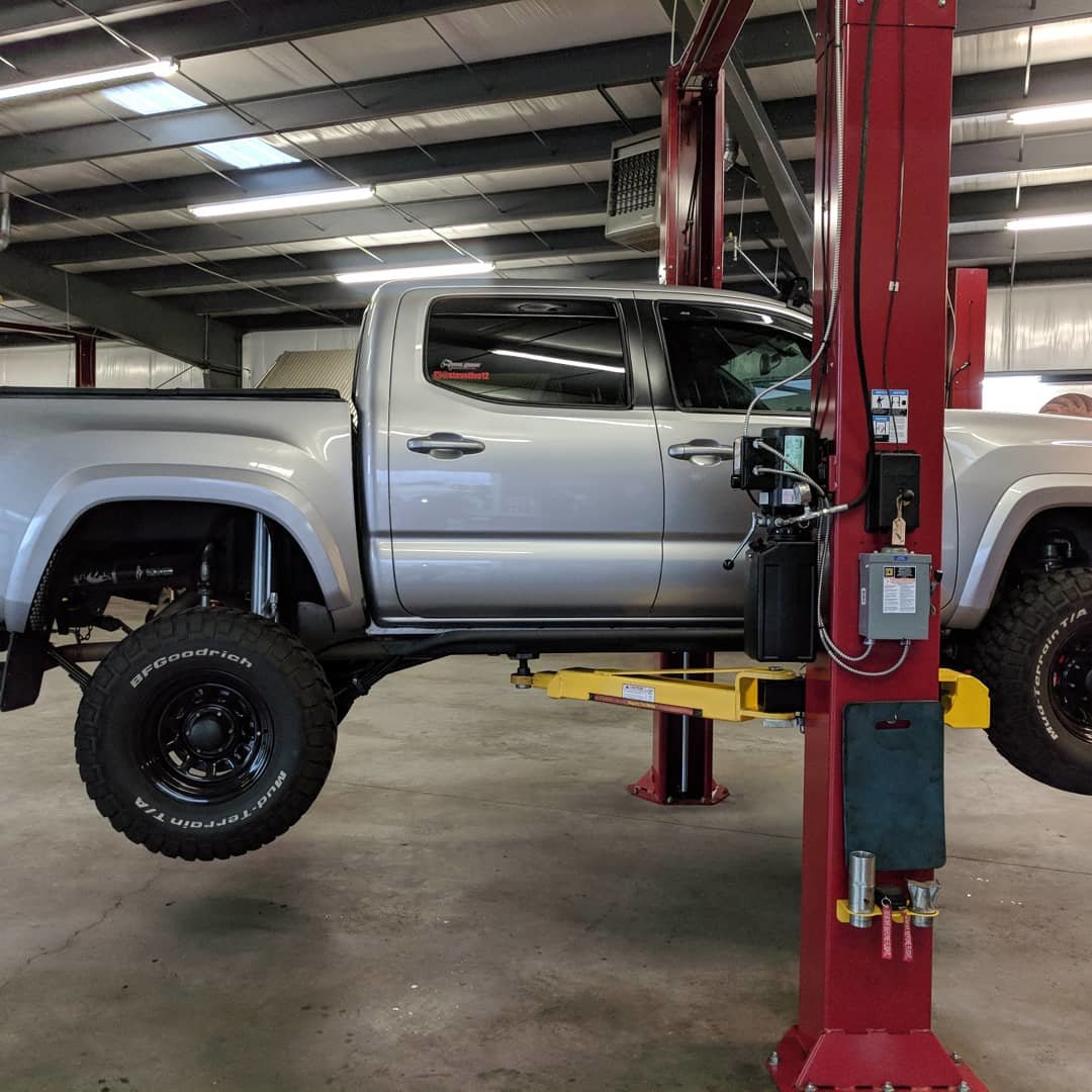

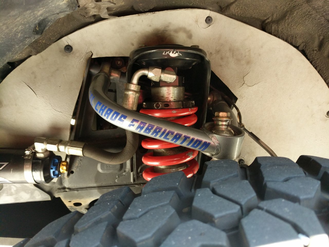

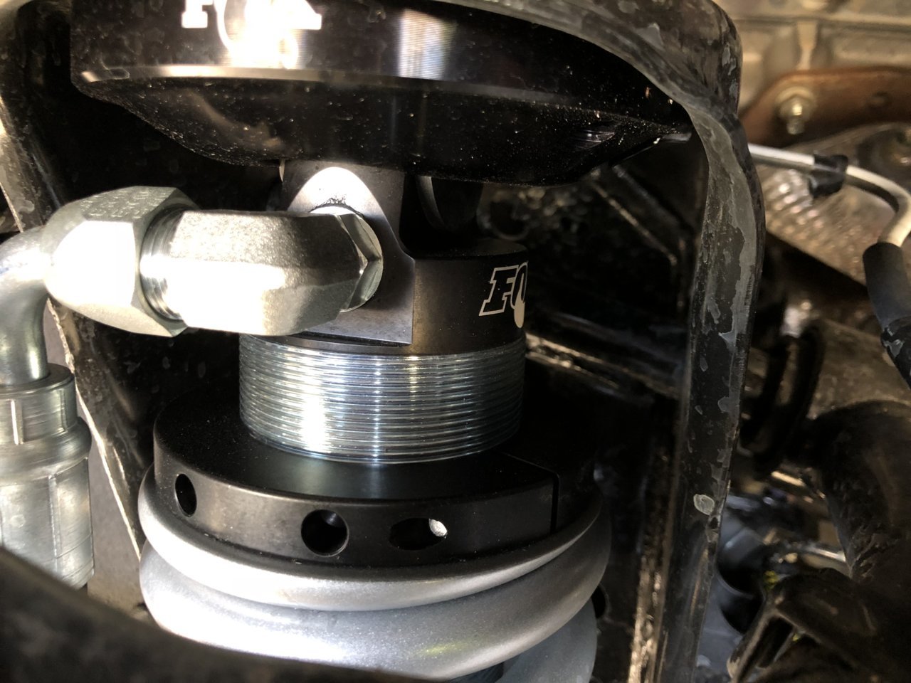

    No sir, all archive everything haha.15356499536186984865260848901943.jpg 15356500146078229726706378769802.jpg 15356500561883676975931527274650.jpg

    They are 14" coils on standard travel dsc coilovers just like yours. On my setup it's fine if just a tad bit stiff but I have a tube bumper planned that should do the trick nicely.
    Cornering is much more stable sans sway bar, less sway without affecting articulation or anything, and subjectively speaking it seems much quieter over bumps than before

    what is your preload at? how much front lift did you gain?

    Preload is pictured but it's set at 7/8" passenger side and 1" driver's side which is currently sitting at 2-2.5ish" of lift over stock. I'm not exactly sure but it's somewhere in there, good amount of lift with almost no preload and great ride quality! Best of all these springs should last longer I'm hoping thanks to the high spring rate and low preload

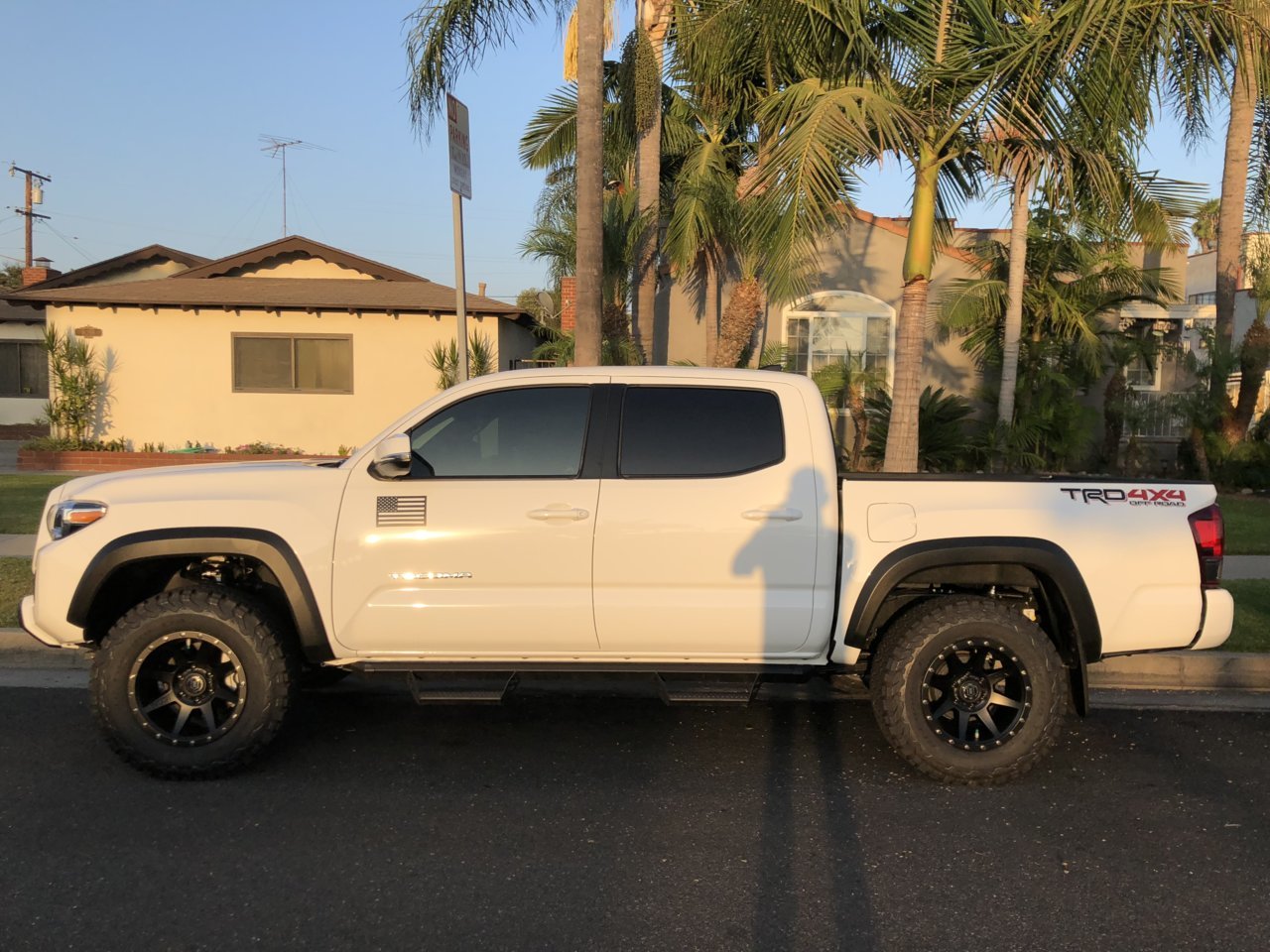

    Installed Fox Racing Shox 2.5 Factory Series Coilover Reservoir Shock Set - 880-02-376 in the front and 985-24-116 in the rear and I love the ride. I got 1 more inch of lift in the front then stock to be close to level.

    That is definitely over 1 inch and a good amount of preload. What is the thread count?
