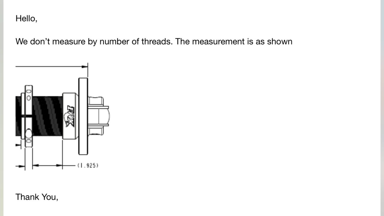

    You said you & others got different info. from Fox. What info.did Fox give or tell you?
    Do you have any armor?
    How much down travel do you have w/it cranked to 2.9? (I'm guessing ~1")
    Do you get coil bind?
    Do you ever bottom out the shock?
    I'd like to lift mine a little to get closer to level but I'm @ their max recommended height (1.925" exposed threads) & don't want to screw them up.
    You say you had to crank them that high to get it level. What if you put taller springs on the rear, would you keep cranking it to get level?
    Did Fox tell you to crank it as high as you need to to make it level with your rear lift, regardless of how tall your rear lift is?
    Thanks!

    Fox stated that we were at max lift on those coilovers and said it would be fine w/o issue. I have no armor or weight on the truck at all. It is completely stock except the suspension. There is absolutely no bind and the cv's look perfect. I run these every day and purposely hit speedbumps among other things to test the front coilovers. Like butter.
    I would not go any higher on the front or rear. I do think i am at max lift though. Like i said, working perfect.

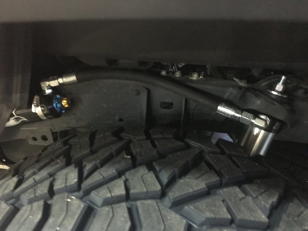

    Looks great. I'm looking at going with the same shock setup. How do you like the Fox's? Are you running the 2.0 or the 2.5 in the rear?
  15. Mar 18, 2018 at 8:57 AM
    #95
    Tacomamike mike
    Tacomamike mike Just that, nothing more.
    Sep 6, 2016
    #196650
    3,960
    Michael
    2017 DCLB TRD OFFROAD 4x4
    Working on it, dissent offroad racks, shift sense pro, pedal commander , ARB twin, rigid SS dually's , dual batteries, ARB fridge , 2.5 Fox coil overs wResi , 2.5 Fox rears w resi Total chaos UCA , deaver packs , Nitto trail grappler's 33" .

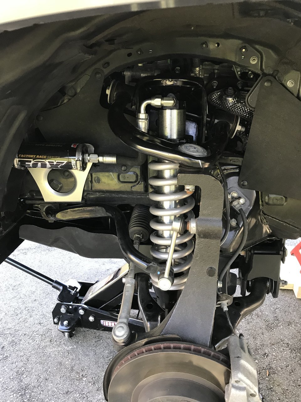

    2.5 F6B93AC1-2FA7-403A-B9EC-062B6976C211.jpg77A6C510-2AC1-4DCF-8C79-B198BCF2A2D5.jpg
    hotrod 15 likes this.

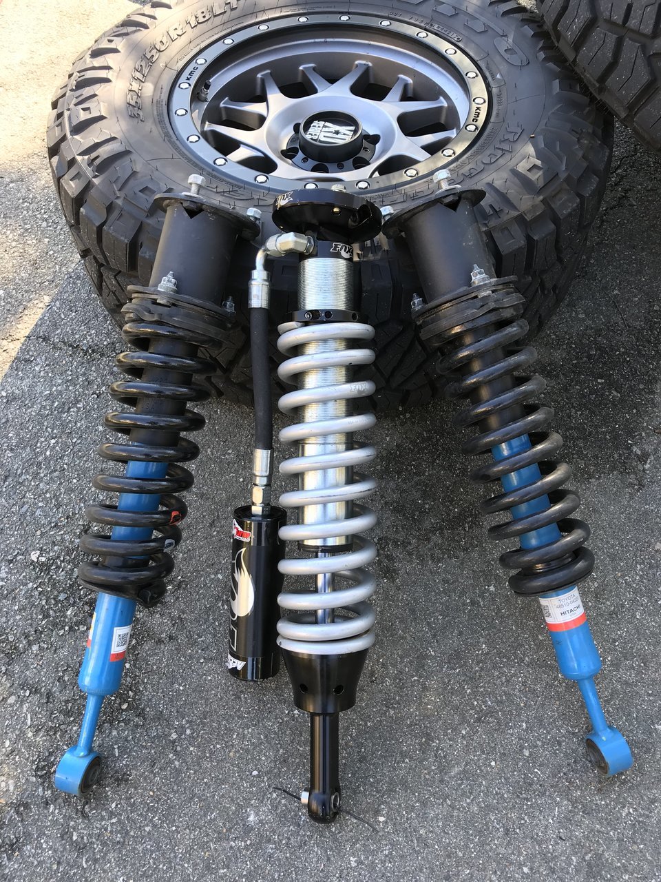

    Stepped up my drop bracket game today.

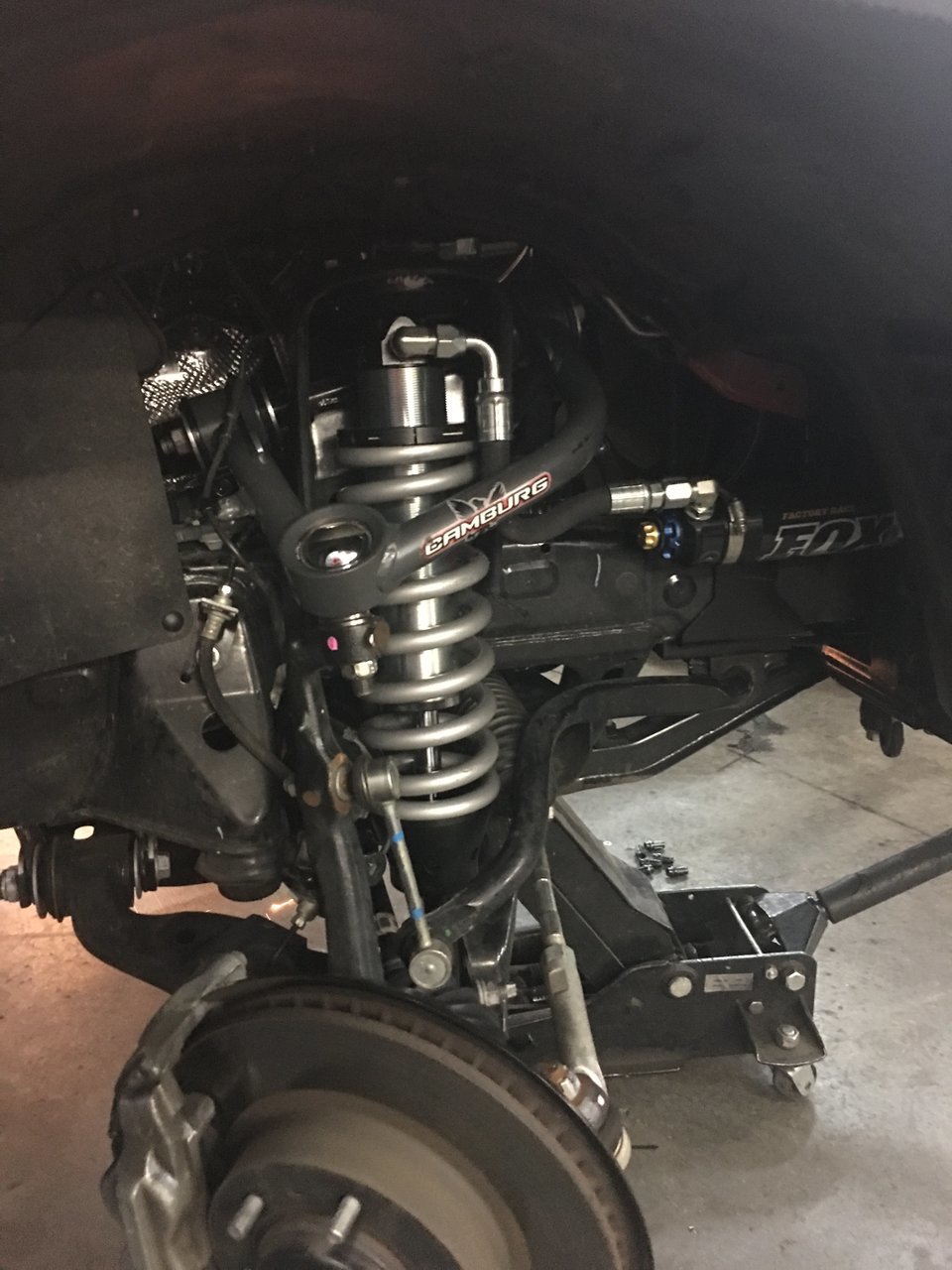

    CFAE1A04-E805-4C83-8A14-74B9A1464C84.jpg CE9D31F9-9165-4DB2-A249-1FDC0B23FC9A.jpg
    FinnJ, Biscuits, scottalot and 3 others like this.

    Peeps will say that is a lot of "preload". Looks normal to me on a set of foxes. My threads are just like that and my truck rides dreamy. Ive even seen ford f150's with fox set ups and theirs are just as jacked up.
