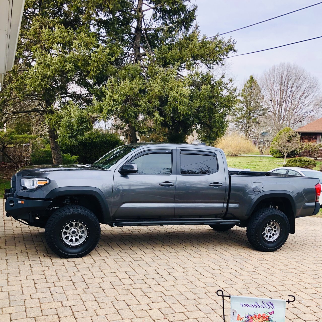

    Very nice setup I have a DCLB as well. How much preload do you have on that setup. Your setup should give me a decent starting point. The Accutune folks made the recommendation shoot for 21" from the top of the coil bucket to the the bottom on the coil where it bolts to the LCA under the eight of the truck for my ext travel 2.5s

    I’m traveling this week but will take exact measurements for you when I return. I believe I set for 2” of spring preload. I don’t worry about the number of threads showing since it’s hard to for me to count them. I measure the spring.
