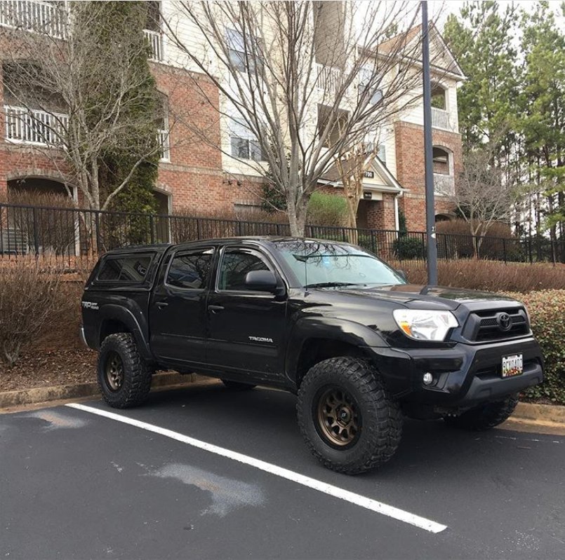

    #1356
    bax
    bax Well-Known Member
    Jun 4, 2014
    #131258
    336
    Tyler
    Georgia
    Black 2015 DCSB TRD Off Road
    1) yes
    2) I have the same kit as you and otherwise stock as well. I installed how they shipped, then they settled down to like 1.25" with some driver side lean. I'd suggest drive on them for a few days to let them settle, then adjust, THEN get an alignment once you're happy with the height.
    Just an FYI when adjusting mine on the truck I would lower the weight back down and stand in the door area to settle them down after each small adjustment. Otherwise you'll be chasing your tail like I was. For some reason mine would need to be settled a little after each little adjustment.
    I left my overload leafs in, and I have basically the factory rake which I like.
    3) Check your rear shocks. Mine came with the wrong bushings (common issue) and the correct bushings were in a bag. Luckily I was able to remove the incorrect ones with needle nose pliers working them out slowly, then pressed the new ones in with lube and using sockets like a press.
    Picture for reference of my height:
    Thanks! Maybe I'll try the 14" 600 springs first, before going to 650 and possibly regretting it.

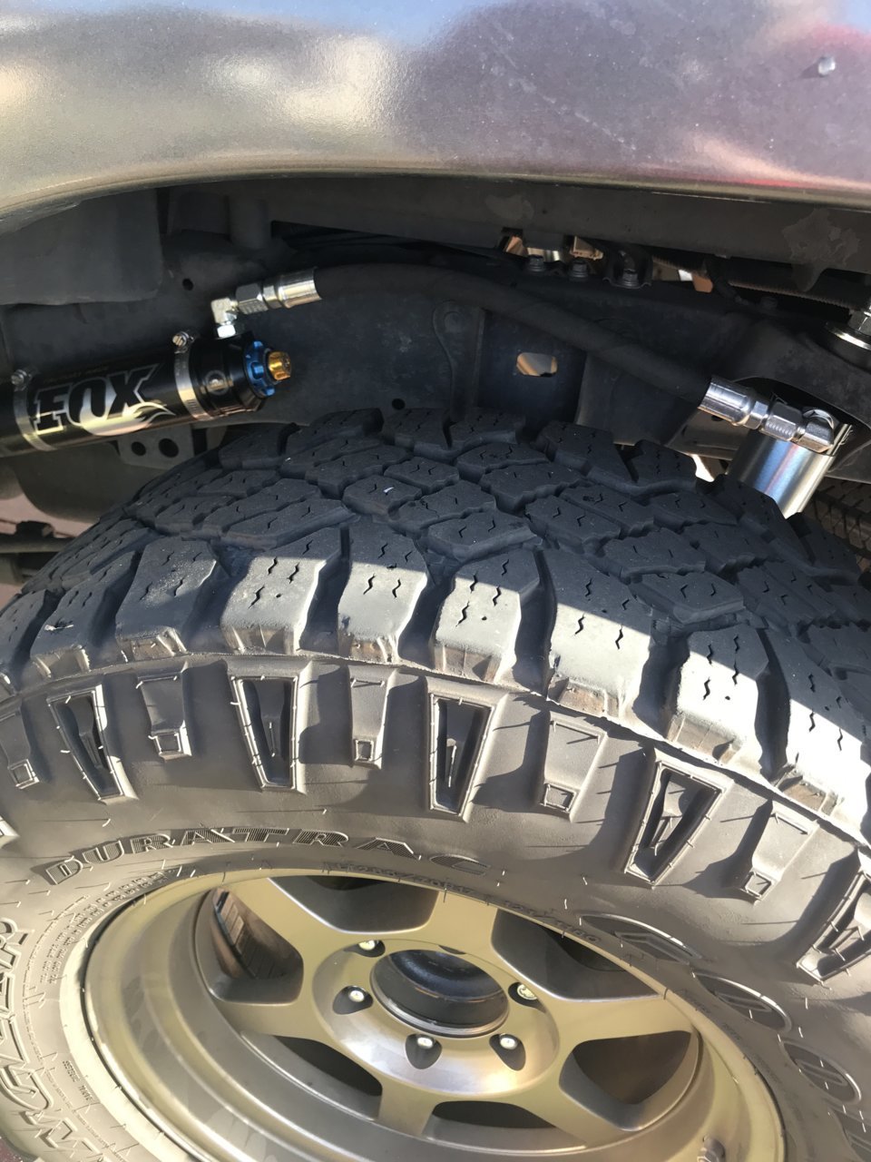

    iRepLONGBEACH
    iRepLONGBEACH SoCal Reppin
    Mar 7, 2011
    #52506
    782
    SoCal
    10 MgM dcsb TRD Sport
    6F1C4E66-0EBF-4B90-B4B9-E45AEA73E7FF.jpg 69DAB7AD-098C-43E1-80B8-7EE87871C5BD.jpg
    Hey guys! Just got my suspensions on with 13” 600lbs springs. I was just curious what settings do you guys run for “on road”? Currently running 7 high, 2 full turns clockwise on low. And how about off road settings?
