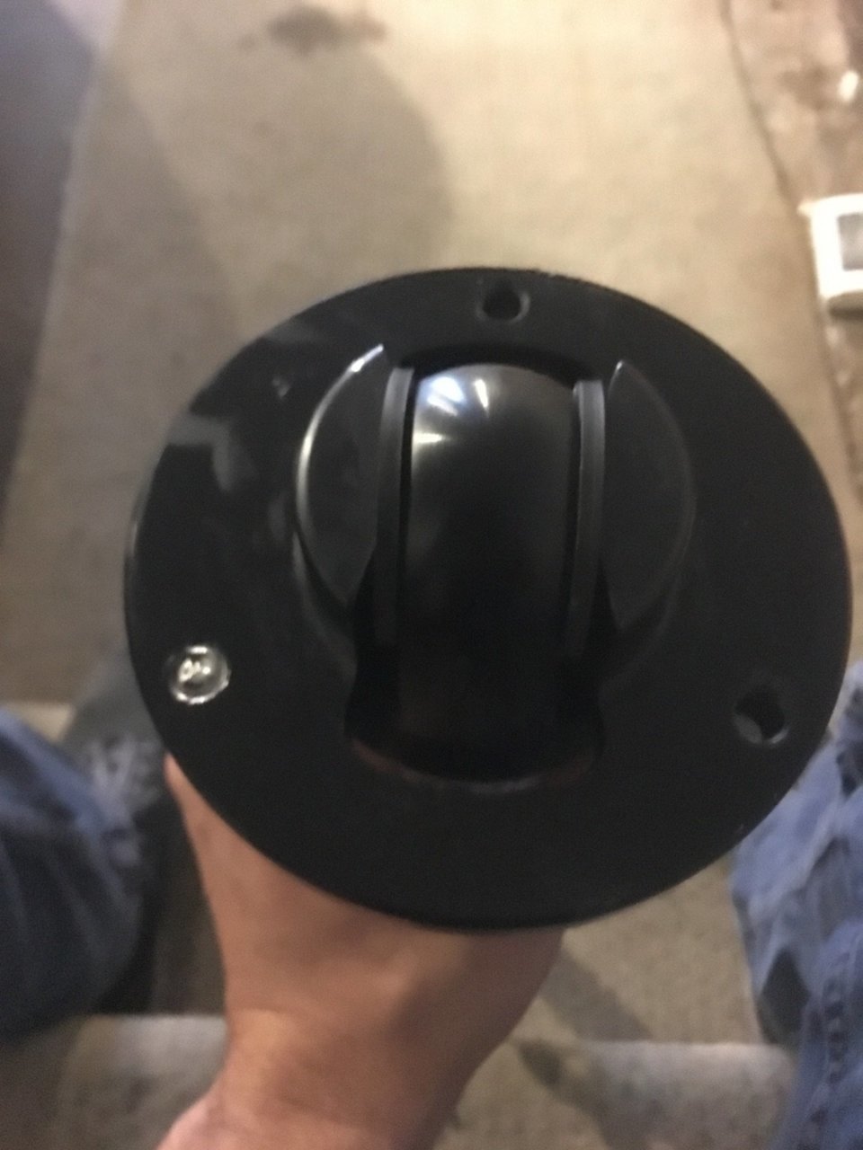

    Hoping someone can here me. Looking to finally install my fox 2.5 coilovers with resi. I misplaced the bolts that secure the top hat of the coilover into the coil bucket. Does anyone know what size bolts to get?
    I'm pulling off icons 2.5 coilovers. Would these bolts work on the fox coilovers?
    Thx

    For my Fox 2.5 Extended Travel Coilovers:
    Fastener, Standard: Bolt [3/8-16 X 0.750 TLG] Alloy, Hex Head Cap, Grade 8
    I had to order some of these after I accidentally put the wrong bolt in one my top hats and it sheered off when I went back to re-torque everything. Was a PITA.

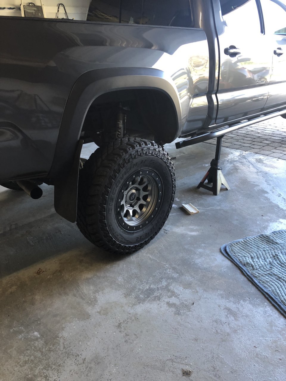

    Removed the two Dakar overload springs and put my 1.5” block back in. The Tacoma simply does not have enough weight to flex an overload spring let alone two of them. Truck now uses much more of its travel instead of slapping into a wall steel in the first 1.5” of up travel. The ride is SO MUCH BETTER! Look at that droop.
    29.5” hub to fender at droop, and
    23.5” hub to fender static sag on
    10.1” travel Fox DSC (15.2” compressed /25.3” extended)
    = 4.1” up and 6.0” down which is freaking awesome.

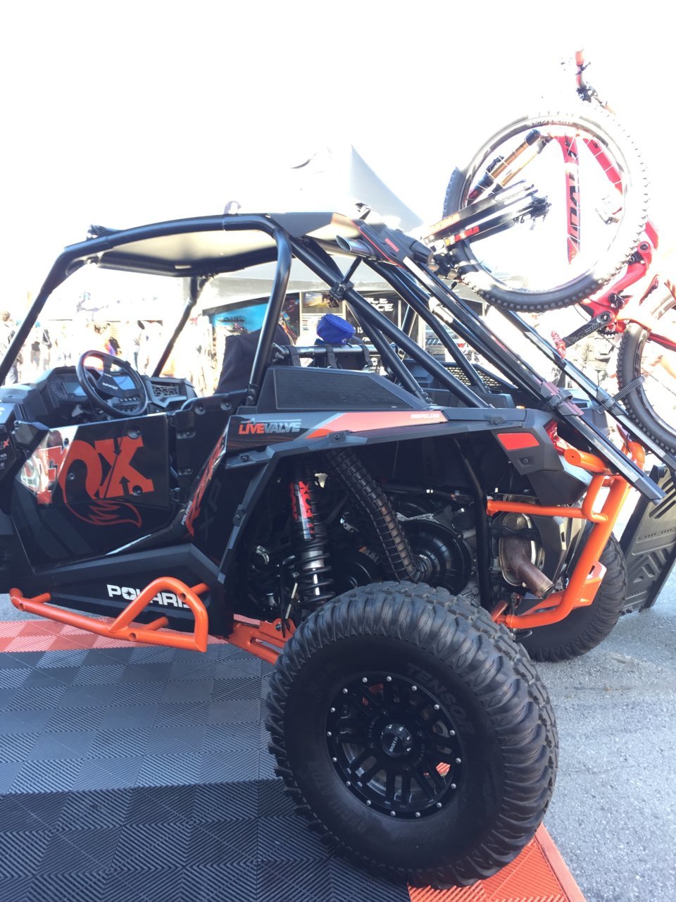

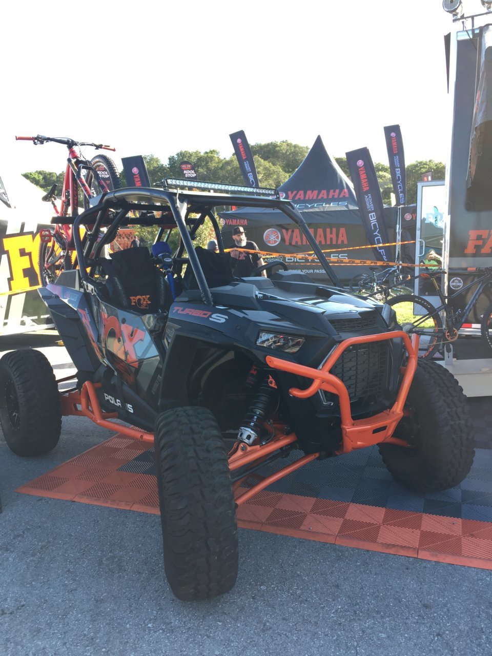

    nice, i was there friday too... ripping the ebike course up on the bosch demo fleet. They're fun, but i really wouldn't want to see them all over our trails. that fox tent always make me stop and drool for a bit. last year they had this beast...IMG_2449.jpg
