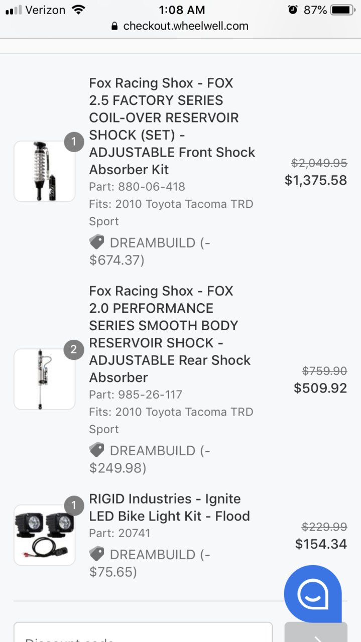

    How are you getting this type of discount?
  18. Sep 27, 2019 at 5:40 PM
    #1858
    clemson4rnr
    clemson4rnr Well-Known Member
    Oct 10, 2018
    #268918
    62
    2018 Tacoma TRD Off-Road 4x4 DCSB
    It was a discount code that is no longer active

  20. Sep 27, 2019 at 7:21 PM
    #1860
    Tacompa
    Tacompa Well-Known Member
    Mar 10, 2019
    #286094
    231
    San Jose, CA
    2019 Toyota Tacoma OR DCSB 4x4
    Thanks for sharing! What kind of discount were you getting with the expired code? This site seems to offer some really good deals. What's the catch?
