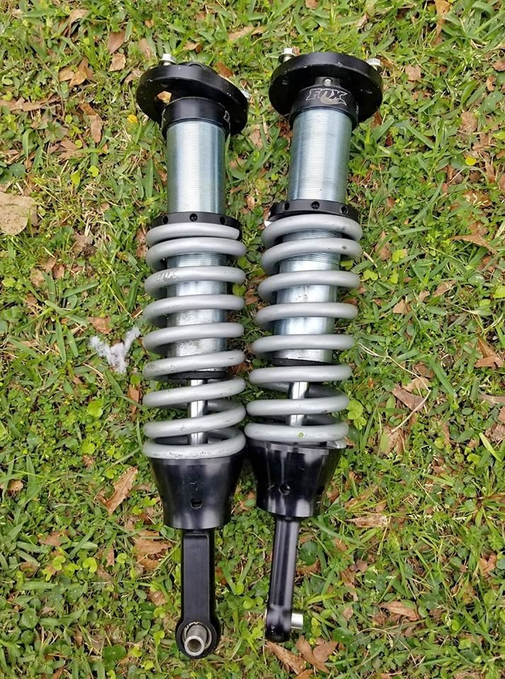

    Can someone help me out with identifying if these are extended or standard travel 2.5s?

    Part #?
    Will be engraved into the bearing cap. Right where the shaft goes into the body.

    140081
    983-02-025

    AccuTune Offroad
    AccuTune Offroad Well-Known Member Vendor
    Jan 28, 2019
    #281012
    1,563
    El Cajon, CA

    tacotoospicy
    tacotoospicy Well-Known Member
    Feb 11, 2019
    #282605
    357
    Luke
    P'cola, FL
    2019 TRD OR
    sirius xm
  20. Nov 22, 2019 at 4:36 PM
    #1980
    AccuTune Offroad
    Jan 28, 2019
    #281012
    1,563
    El Cajon, CA
    :D Thats one reason I'm sure.
