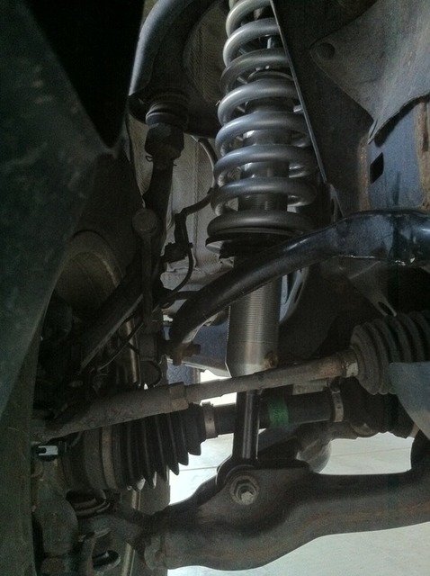

    Does anyone know if you can add a spacer for suspention lift onto of the fox coilovers? Like a 2 inch spacer to give it up to 4 inch lift rather than 2 inch adjustable?

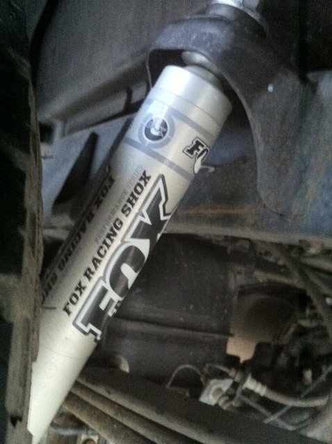

    I've had them about a month now. My truck was the test-dummy for Fox.
    They are a better ride than the stock Off Road suspension.
    600lb spring rate.
  13. Nov 6, 2011 at 4:08 PM

    Chances are, you can. Would not recommend it without aftermarket UCA's though. It would be incredibly out of alignment.

    I plan on getting UCAs anyways. But I really like and want the Fox coilovers that are adjustable. But I wanna leave them at 1 inch lift than put a 2 inch spacer on it as well to give me 3 inches and not having a super stiff ride. And than getting a leaf pack for the rear and putting the fox shocks on the rear as well. What UCA do you think I should get for that?

    They are a big improvement over stock. That's all I can compare it to. I don't have experience with 5100's or any other aftermarket suspension for that matter.
    No, I haven't maxed them out. I prefer function over form. Without aftermarket UCA's, they are going to stay where they are: pretty much level front to rear. I don't want to mess the factory geometry up anymore than I have with 2" up in the front.
    I may adjust for the taco lean though. The passenger side front sits ~0.5" higher than level.

    Tc ucas seem to be a favorite, especially for price. Icons look beefy and cool as shit, but you will spend a fortune, light racing have had bushing issues, but I know people who love em. Have not heard alot on the all pro ucas.

    Is the ride smoother? (obviously an improvement from stock) but is it worth the price? Or should a few hundred bucks be spent to get the normal expensive ass coilover? To me, these look similar to a Billie with an 880's type coil.

    I do have the rear shocks. They are stiffer than stock to help the soft leafs.
