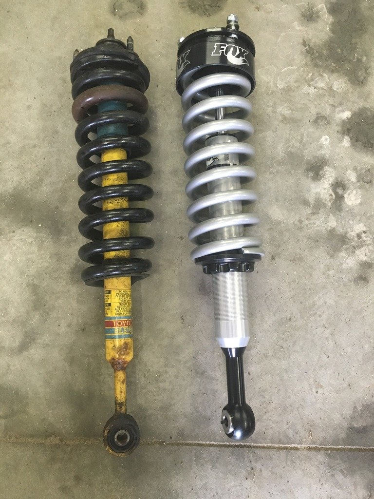

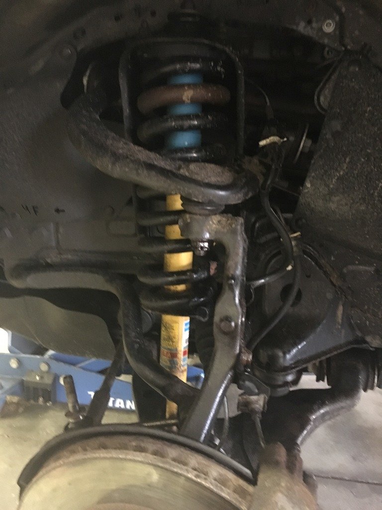

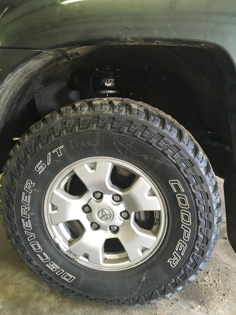

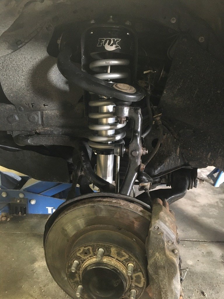

    Installed the front coilovers today on my 13' dcsb. Took a little longer than expected getting some old bolts off and when I was doing the passanger side I had to use a vise to press the bottom eyelit bushing in further so it would fit into the lca bracket. Had to give it a little persuasion to get it to slide it and straighten up so the bolt could pass through.
    I chose to run the toytec lean spacer on the drivers side versus adjusting the coilover. Ended up working out perfectly as they came set from Fox, all sides measure up to 22" with the tsb leafpack in the rear.
    Questionable if my needle bearing got any worse, we'll see how it goes but i'll eventually get that done aswell.
    Ride seems wayyyy more plush than stock, the stock ones were really stiff and these just eat bumps. Also took some shake out of my steering wheel that I was getting with the factory billsteins, they actually ruiened my tires they had some really bad cupping on the treds.
    Also tried to put on the wheelers offroad superbumps at the same time but the first one I tried to take off the bolt sheard clean off in the Frame. Going to have to take a look at that tomorrow and get it out, no bumpstop on the passanger side right now.
