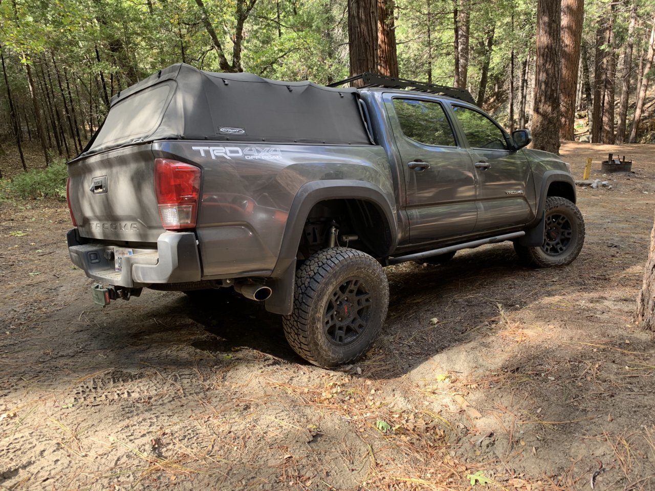

    Took these out today. I was out flexin!
    I’m sold on these 6112/5160. Sold!

    MGM OR, T4R 17s, and 6112? Exactly what I'm shooting for as well. Looks epic!
    Tacohumper13 likes this.

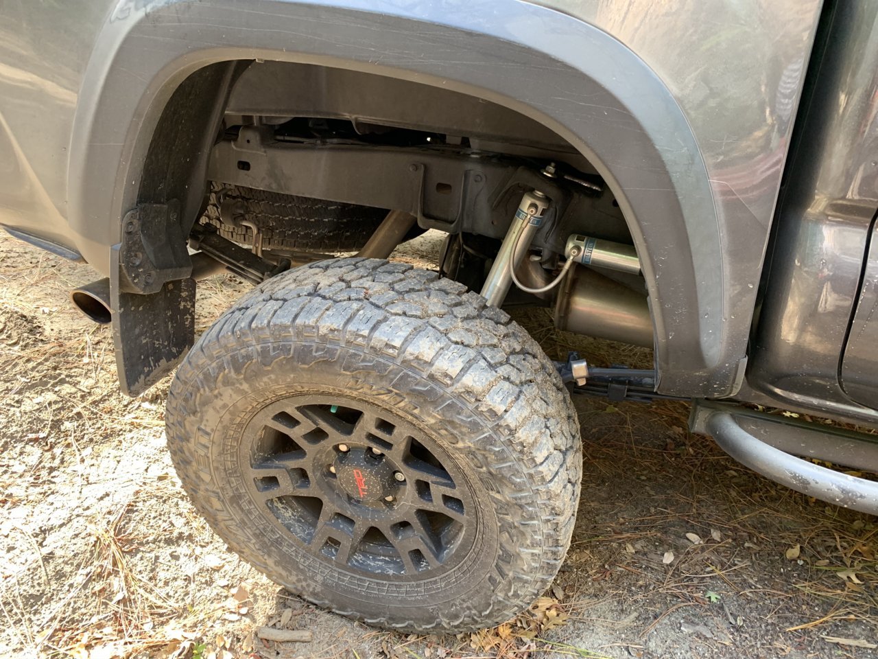

    Here’s from the other side
