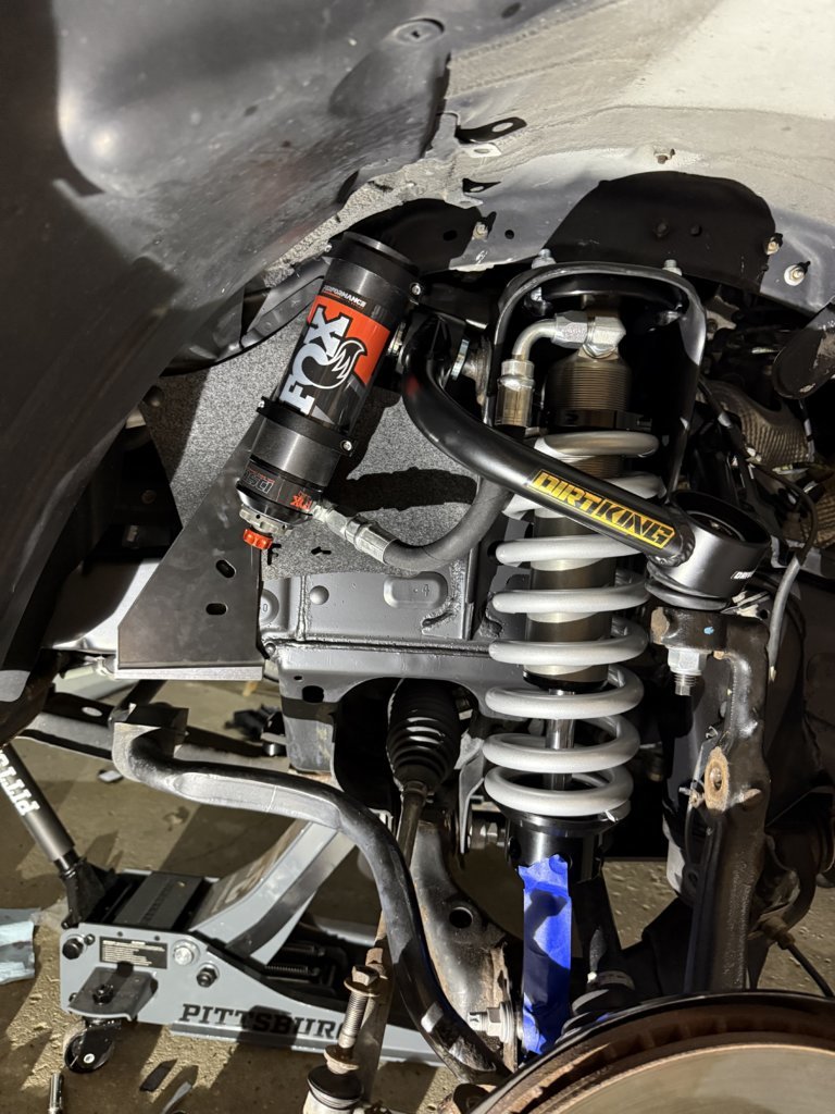

    Just wanted to let you guys know, picked up my Fox 2.5 PE 883-06-178 today and it seems like Fox have updated the reservoir mounting brackets however that has led to a new set of issues.
    The new bracket from Fox is similar to the Accutune Offroad one and tilts the reservoir on an angle however now the problem is my reservoir hits the top of the fender/wheel well and I cannot get it to line up with the bracket in order to install the clamps because this bracket moves the reservoir about 1" higher than the old version. The older version probably would have worked better for me because I am not running a sway bar therefore I would not have contact with it during full compression.
    I am going to try and contact Fox and see if they can send me the old brackets instead or my other option would be to take a big hammer and beat the fender to clear the reservoir which I don't really want to do. The 3rd option would be to mount the bracket on the bottom of the sway bar relocation bracket instead of sandwiched between it and the frame as pictured in the 1st photo, however doing so would move the reservoir bracket downward and the hole on the side where the provided bolt is supposed to secure it to the side of the frame through the dust apron would no longer line up. Another note on the new bracket is that the bottom clamp has to be fed through the smaller slot on the bracket whereas the older version did not have a smaller slot. The Fox instructions are a bit confusing at this step because it states "do not feed the clamps through the slots in the brackets" even though on this new version you have to for the bottom clamp otherwise it will not work since that's the only way it will fit, I think maybe they didn't update their instructions for the newer bracket.

    Anybody selling there old bracket before the slanted version?
    I can trade for the updated Fox version or buy it, whatever! Looking for one just like the one in this pic..
