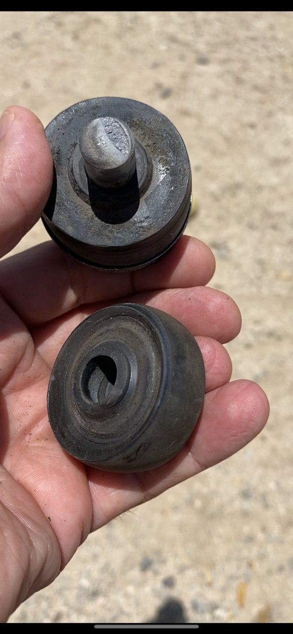

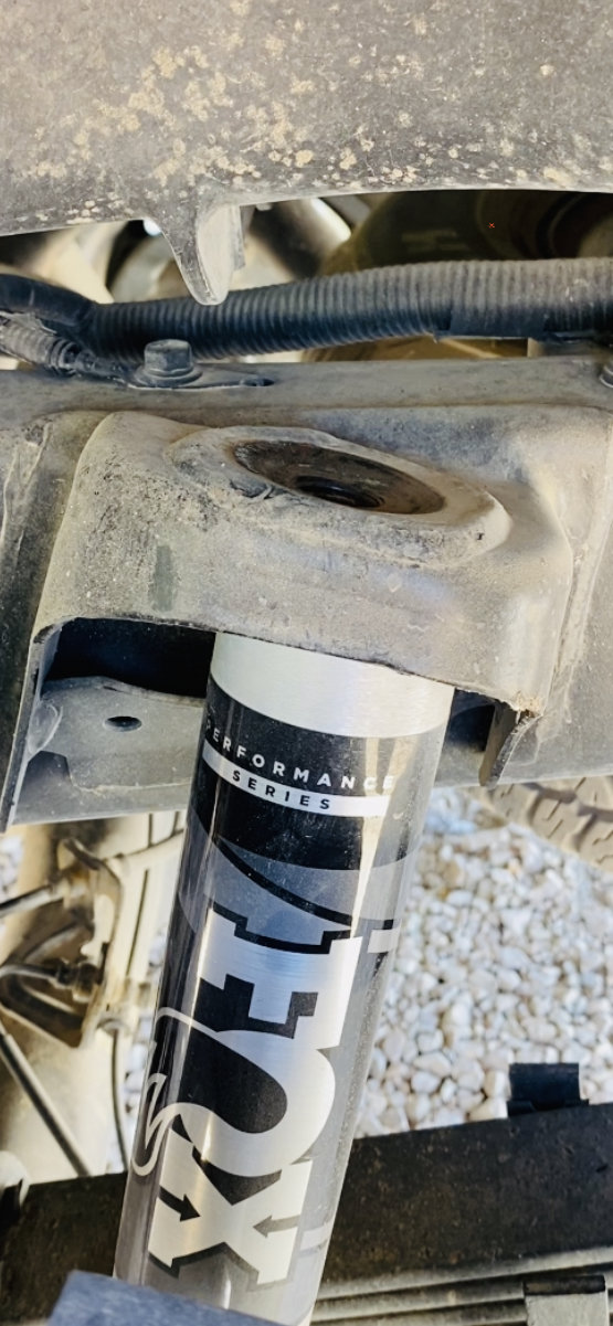

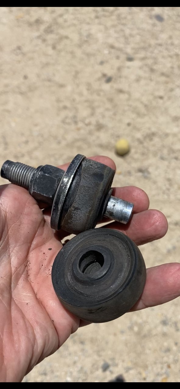

    I have a 2013 Mexican Built (Baja Norte) Tacoma sport 4x4. I live in Southern Baja and I wanted to upgrade from the factory shocks to the something better. I went with FOX 2.0
    Coilover front shocks and rear shocks. This was for my around town truck, not doing any prerunning or off-roading, just wanted a tight suspension for all of the bumpy roads where I live. I've had to rebuild the front drivers side shock, it started pissing oil after two months (I paid for a rebuild kit and had that done here) and now the top pin on the rear shock literally severed off on my way to taking my wife to yoga class (see videos below.) Now Fox wants me to send the shock all the way from Baja Sur to Baxter Minnesota, so they can review it and determine if it’s a fabrication issue. I have to pay shipping both ways on this. Or I can pay for another rebuild kit and rebuild this shit product. I’m fucking over it.

    Could be from overtightening the top nut. Looks pretty far down on the stud. Some companies give a torque spec, some companies say to measure the threads showing, to obtain proper torque. Not blaming you OP, but could be from improper installation.
