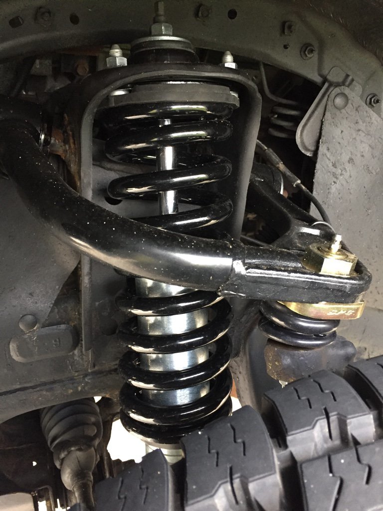

    Front (Fox 2.5 remote reservoirs + DSC):
    The reservoir is extremely difficult to maneuver and mount. This is partially caused by the angle of the hose fittings and the stiffness of the hose itself. I called Fox and they told me that the fittings are angled from the factory to make the shocks fit in the box and they usually require some adjustment for installation. I backed out the lock nuts so the fittings could move a bit, and used a little force to get the resis mounted.

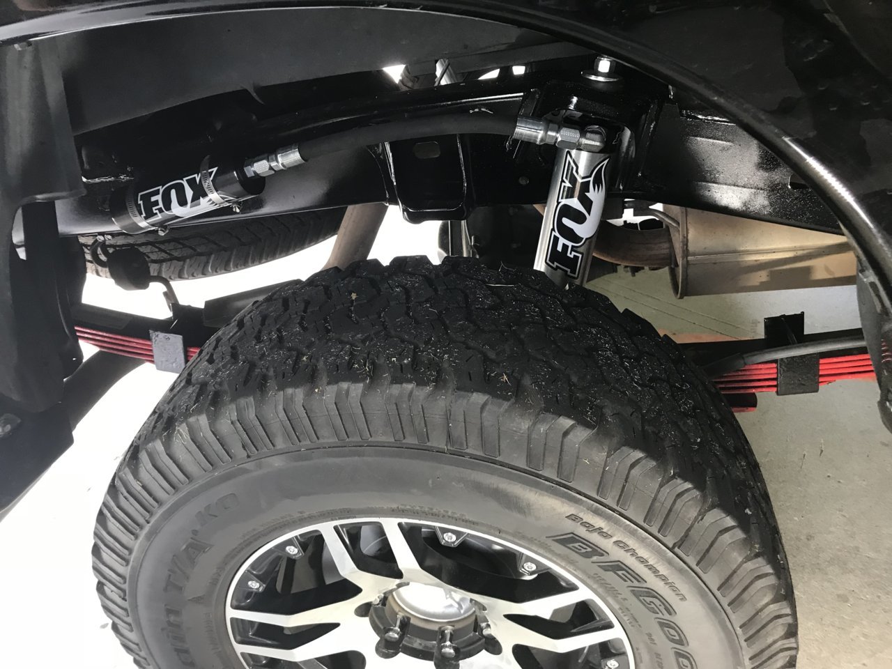

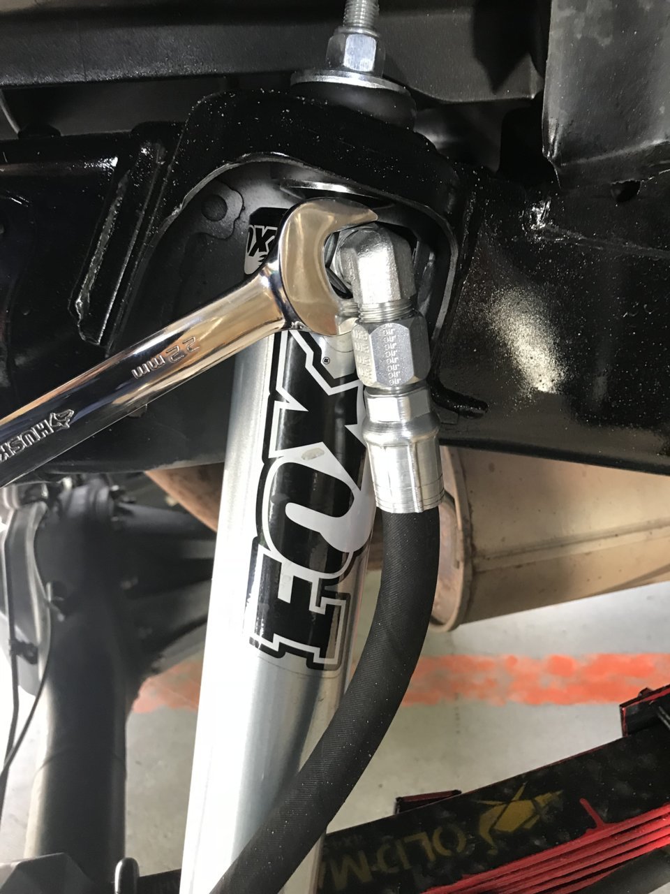

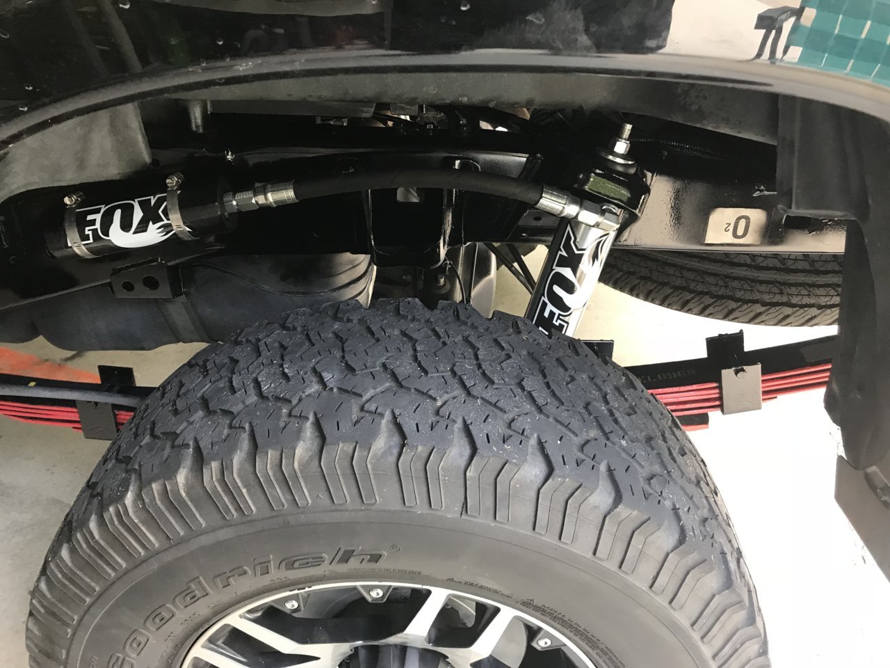

    Thanks for the Info as I don't find much install info on the FOX 2.5 Extended Shock 883-24-006 for the taco.
    Lesson Learned :
    • Take Fox Instructions (Meant for Tundra) and shit can.
    • Bottom Shock Bushing is wider as expected for tundra fit - Sawz all will do trick- Trim it put it in a vise and hack away.
    • How the Reservoirs are coupled to shocks (Both reservoirs need to be moved 180 Degrees).
    • On the shock Loosen that lock nut slowly then start moving the Hydraulic 90 degree fitting where you want.
    • Drivers Rear Shock - Reservoir faces the Front of Truck.
    • Passenger Rear Shock- Reservoir faces Rear of Truck.
    • Reservoir Fox Stickers removed since it is upside down and installed new sticker supplied with fox shock.
    • Use some POR 15 Black Gloss Spray to get that frame nice with those new toys.IMG_2872.jpg IMG_2889.jpg IMG_2899.jpg
