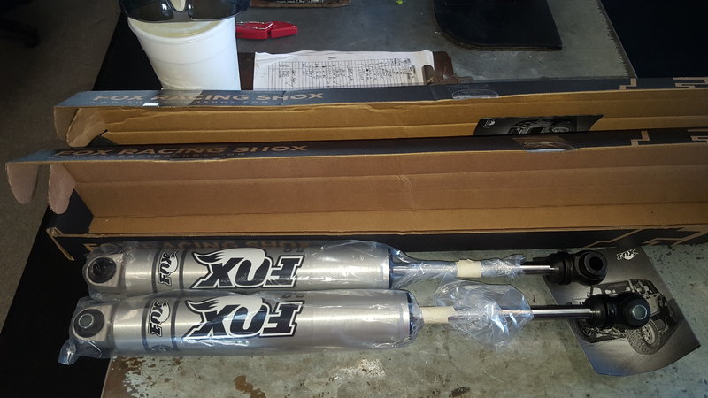

    First off, they are different lengths. One is about 3/4" longer then the other. So my question is which shock goes on what side. Most directions came stating and the shocks don't say either. My current shocks are both the same length so I don't have anything to go by.
    Secondly, one shock came with metal bushings while the other didn't. Why is that?
    Lastly, I mocked one up last night for shits and giggles and was pretty disappointed to see that the mounting hole/bushing on the fox shocks are WAY smaller and will not fit. I didn't get any other inserts or bushings.

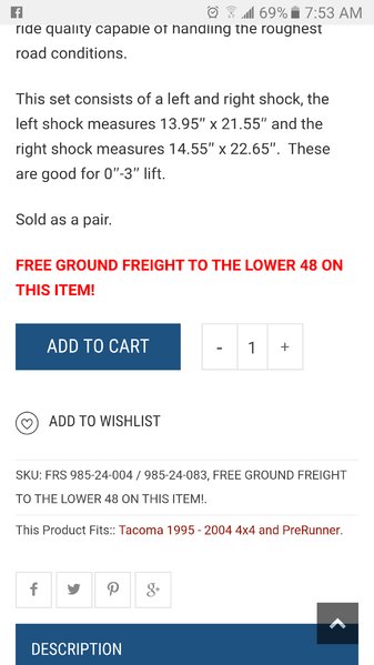

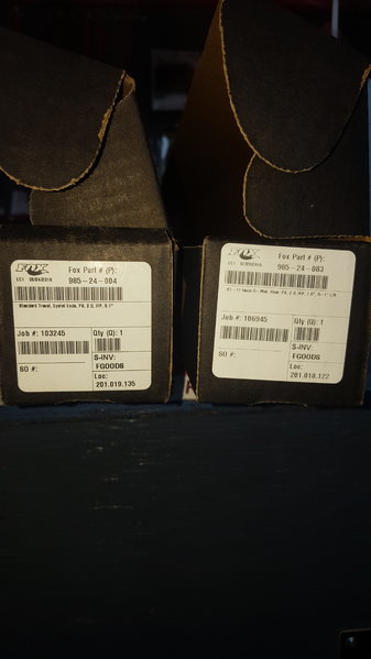

    These are what I got. Clearly states two different length shocks for first gens...WTF

    I had a mechanic friend come over and look at them, he said no way they are fitting in those eyelid bushings. The holes on the fox shocks are like half the size they need to be. The one with the metal bushing is a good 1/2" to small.

    Pass side is longer on 1st gens. You may need to have new bushings pressed in to make them fit cause we have 18mm diameter mounting pegs. Wheelers sells the right bushings.

    Metal bushing gets removed.
    Its tight but it should fit. I used grease and pushed on shock with my foot to get my 5125s on.

    I got a can of silicone spray. My mechanic friend said the other end shock with metal bushings, those do need taken out. But why did one come with them and the other not. Never got a straight answer there.
    Even with the silicone spray, no way those are fitting. My friend suggested maybe drilling out the bushing hole. About the only option I have to make use of them now.

    Ok I figured out what shock goes where. The longer one goes on passenger side. That actually makes sense after the 20th time I read the description, the left shock is shorter so it must go on driver, and right shock is longer so it goes on passenger.
    So I guess I'll call wheelers Monday and see about new bushings because I really don't see those going on, and I don't think I should have to drill them out, that's kinda BS I think.

    So it turns out I'm not as completely dumb as I look. They are indeed the wrong size bushings. They were suppose to come with 3/4" and the ones I have measure 1/2" and 5/8" Wheelers is checking with FOX so hopefully between the 2 of them I'll get the right size bushings this time around!
