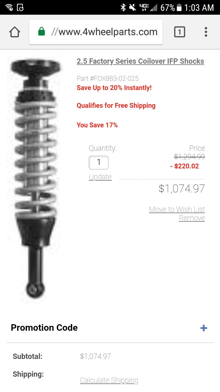

    %20 at 4wheelers right now. So basically loaded dsc foxs for the cost of standard resi. And I think the 2.5 standard could are $200 off

    Sick kit but Danm the price! !

    Here we go

    Ordered mine last week. Still waiting for a shipping order , but I'm not worried. Did it through PayPal. 6 months interest free ;)
