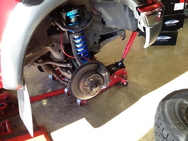

    I figure I would throw it out to you guys to see if anyone has some ideas to rectify my situation.
    So I have a 3 inch setup with an Allpro leafs and Fox Piggybacks in the rear and Fox 2.5 coilovers in the front with Total Chaos UCAs and LCAs. Because of the fact that the Allpro leafs lift the rear a full 3inches, the front sags quite a bit with the 2.5s at "0" ride height adjustment. When I crank the ride height up an inch and a half in attempts to match rear height, the ride sucks and is super stiff. Going over seams in the road and speed bumps results in a super loud "Clunk" or "Bang." It almost sounds like the shock is soo compressed that on the other side of the bump, the suspension punches down to full extension, thereby "Clunk." I know this is putting some significant stress on the CVs and struts in general.
    I have order the front diff drop and the swaybar relocation from Toyotec and plan on cranking the coilover back to an inch of ride height as my angles are super steep right now and know that can't be good.
    Are there any other ideas to achieve the desired ride height without sacrificing the ride quality and durability of these parts that arent cheap parts. I'm calling Fox today to pick their brains but perhaps YOU GUYS HAVE THOUGHTS?

    Coilovers are meant for 2.5" and even then the ride sucks. People get heavier coils but I think that is meant more for heavy bumpers. If it was me I would have stuck to 1.5 or even 2.25" rear lift.

    Send the diff drop back, its worse for the truck than leaving the truck alone.

    It doesn't drop the diff apparently it rotates it. Do a quick search on diff drop and you should be able to come across a few threads about it. I'm mobile right now sp it would take a while.

    unclear if you have the swaybar relocate block or it's on order, if it's not installed that may be your clunk.

    Just take the sway bar off, off-road your ride quality will be night.and day difference

    Or this ;) forget the sway relocate and the diff drop. The set up sounds good, no reason you shouldn't be able to match the front ride height with the back AP 3" leafs.

    Yeah thats what I want mine to look like, not cranked all the way down. That way I'll actually get the travel I need.
    Havent installed it yet, it is on order with the front diff drop, which is going right back after really reading the aforementioned thread
    The problem is that I'm on the road 90% of the time. I might take it off for s#*ts an giggles to check out the ride quality. I know my buddies XJ is way more plush and heavenly without the sway bar

    Clunk is probably the sway bar hitting the coil overs, take it off. The on road ride is kinda nice actually :)
    Edit: Look in there for paint missing on the coil overs...

    Now you got me thinking.....it had crossed my mind, but what are the downsides of taking the sway bar off besides being able to flip the truck more easily....lol

    I thought you have the All Pro Expo 3" leaf if not the it isn't a problem with the a standard All Pro 3" you should be able to remove a leaf or two granted if your sway bar trick doesn't work. Even then if you raise it full 3" the rear will still be higher.

    It is the standard pack as I heard the expo pack is 3 1/2'' which is crazy. Should still be able to take a leaf out I would think. I'm just concerned about over extending the CV joints, I know it is inevitable but with the swaybar off its almost guaranteed, No?

    Yep your CV will limit you. We are stuck with mid travel, drop bracket and SAS. Like stated worst case is trade your AP for something with less lift or take some leaf out if you want to go that route.
