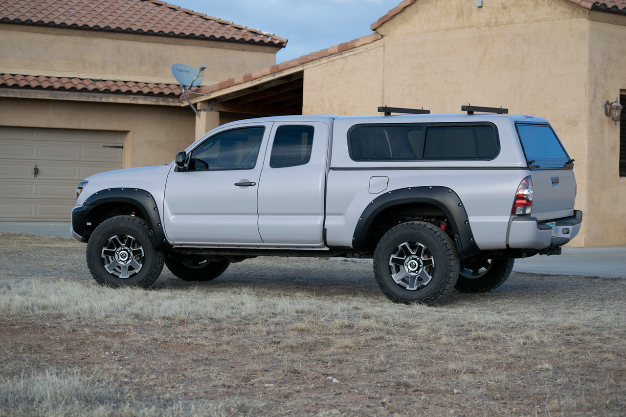

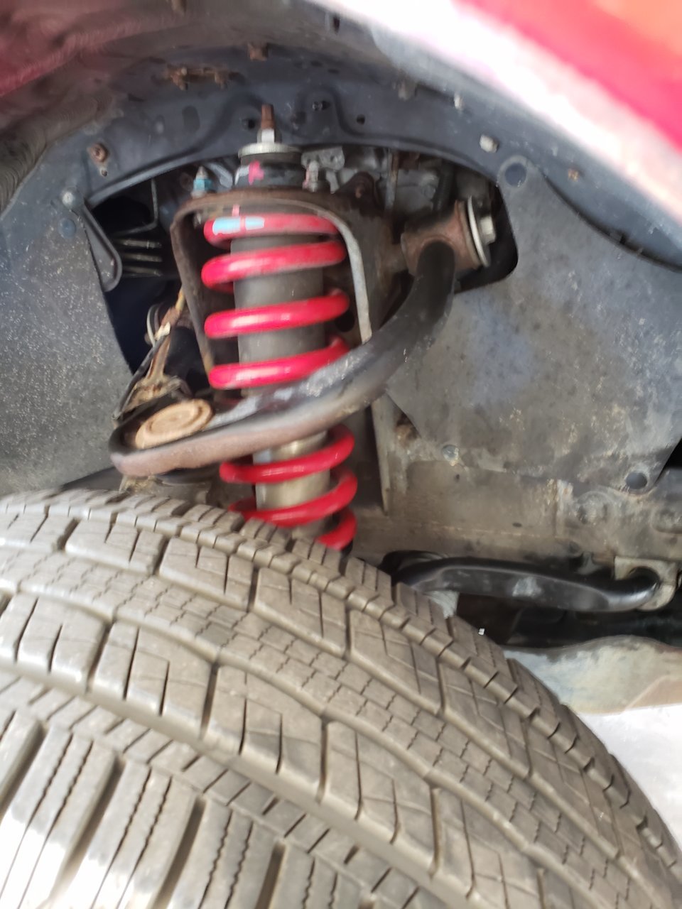

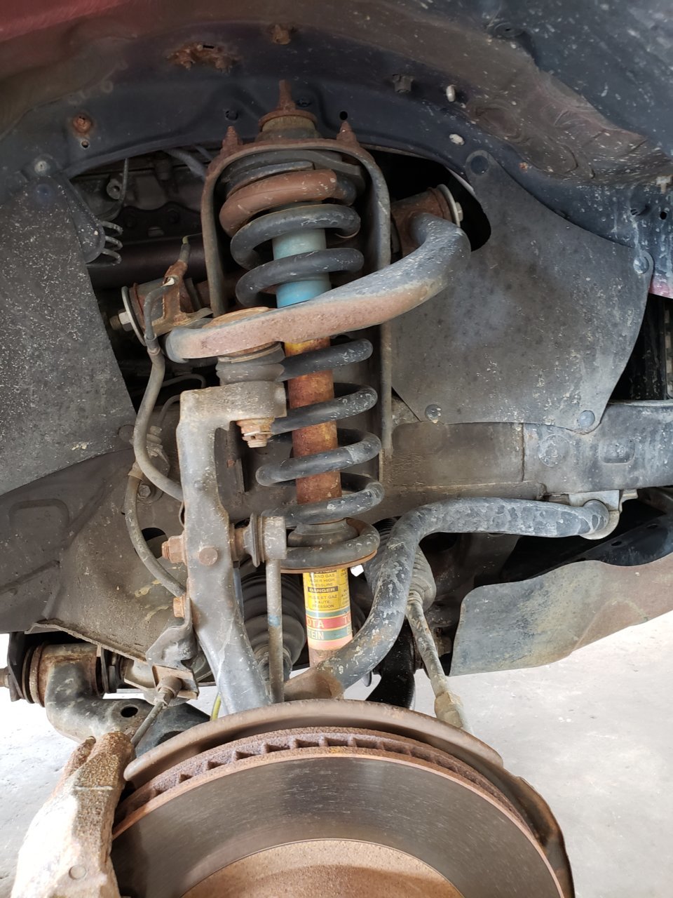

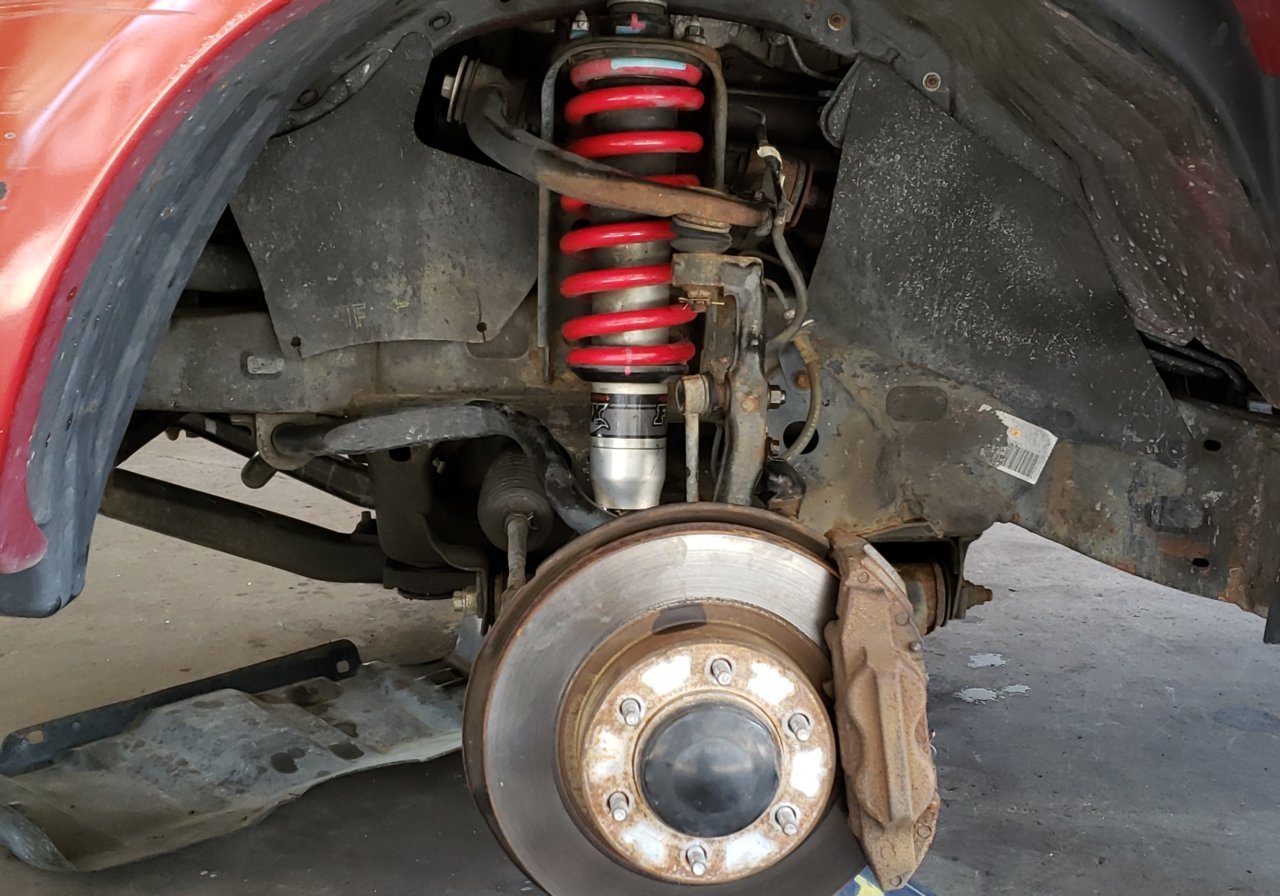

    I did a ton of searching and couldn’t find pictures of a 2nd gen with 3rd gen TRD pro suspension so I figured I’d post mine now that I have it installed. I bought them used with about 10k so any settling should have taken place already. I have an AAL in the rear that came with the truck that is supposedly a 3” lift. I think Les Schwab installed it. Unknown brand. The front is fox TRD Pro suspension with no spacers. Tires are 265/70/17.
    I need to fix the forward take but haven’t decided on what yet. I’d like it to sit level. My current leaf pack is pretty flat so I’d like to buy a full pack instead of a different AAL. Any recommendations are appreciated.

    I think it looks great as is!
    I've got the Pro Fox setup on my LB 3rd Gen with 1/2" spacers/blocks in front/rear.

    Did you set the fronts to 2" lift? How does it ride?
    Also how did you mount the reservoirs?

    The Fox Trd pro suspension isn’t adjustable so it’s just 2”.
    The reservoirs are attached to the rear shocks and the fronts don’t have one.

    So, how much lift did you get in the front with the 3rd gen. Pro suspension on your 2nd gen.?

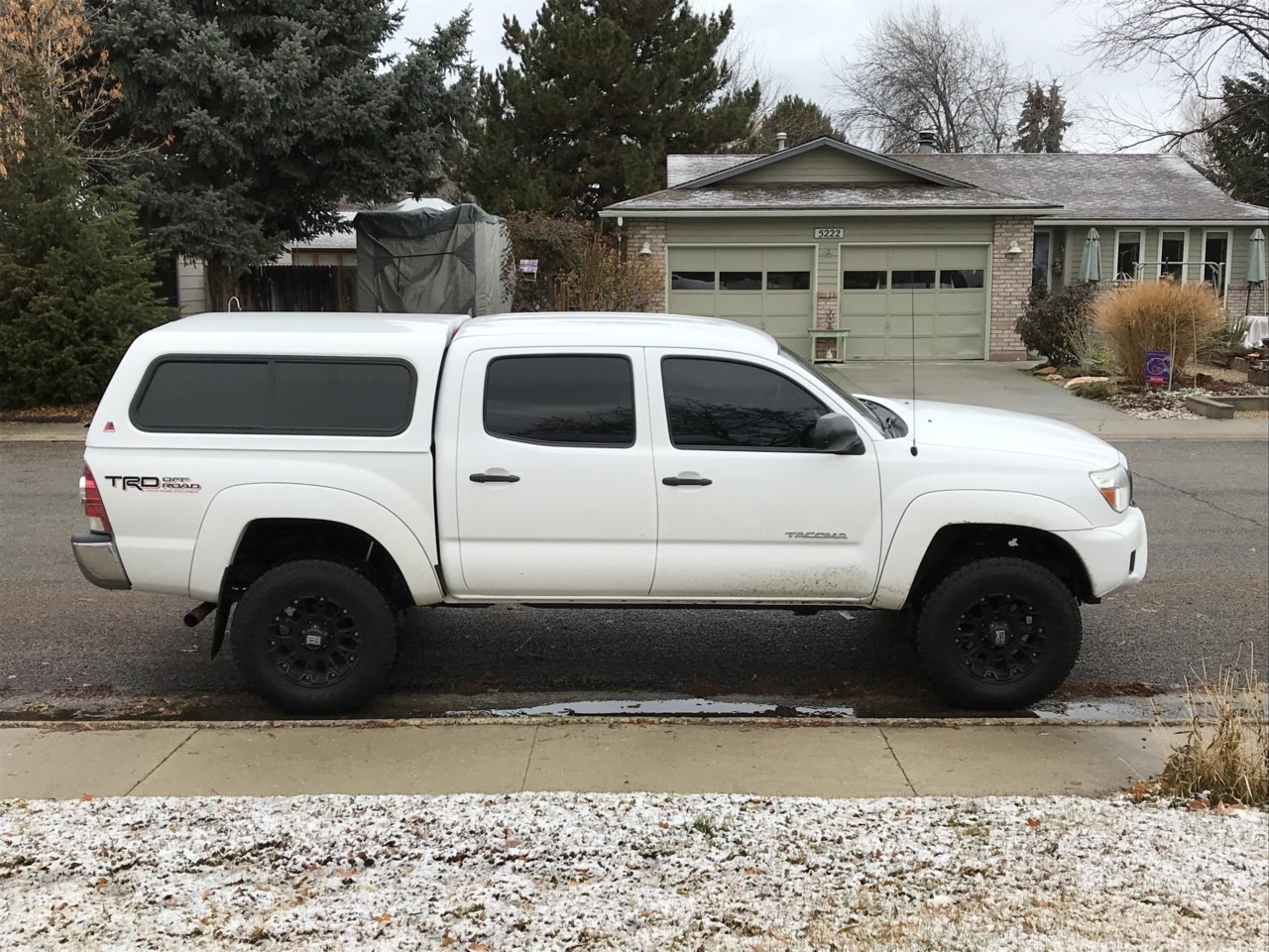

    I am thinking about this same setup! I bought a new Tacoma yesterday (2014 TRD off-road, access cab, 6spd, black, and only 27k miles!) and I just saw the 3rd gen TRD Pro Fox Shocks on Craigslist. I like the idea of staying with the TRD Pro suspension but I am also considering going Icon stage 3ish. I'm currently running the 2nd gen Bilstein TRD Pro suspension on my 2006 TRD off-road (same as above... Access cab, 6spd, etc) with toytec AAL and I love the ride. I may have to gamble on the Fox after seeing this post.

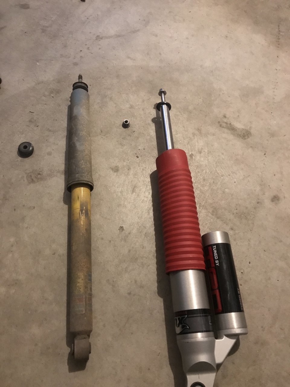

    I just finished finished my trd pro shock swap. It was a pretty easy DIY job. Gained 3in in front and 0in in rear. Will need a AAL in rear to look level. If any needs a write up. Hit me up

    3" in the front? Dang. I was hoping it was closer to stock.
