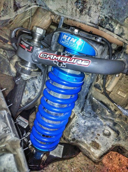

    They're for use with aftermarket control arms, they will give you extended travel. If you're buying total chaos UCA'S might as well make the most of them and run extended travel co's. I'm running the extended kings with camburg uca's, couldn't be happier.

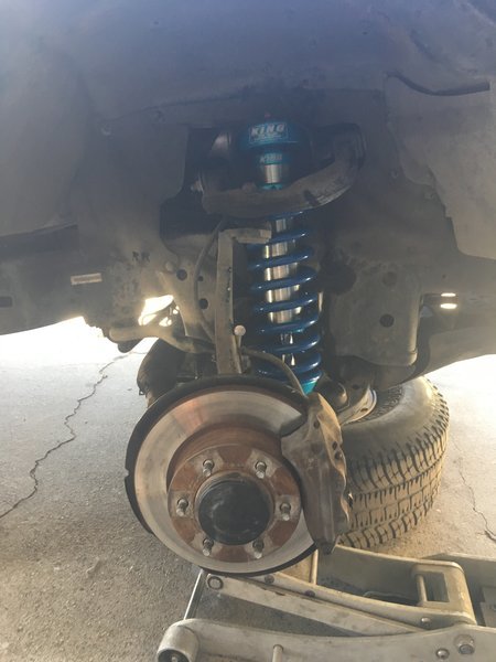

    Just put kings front and rears in myself over this past weekend. night and day difference:hattip:pretty easy with a friend and pb blaster.(trucks on stands btw)
    Got a speeding ticket ride was so smooth, no joke :ballchain:
