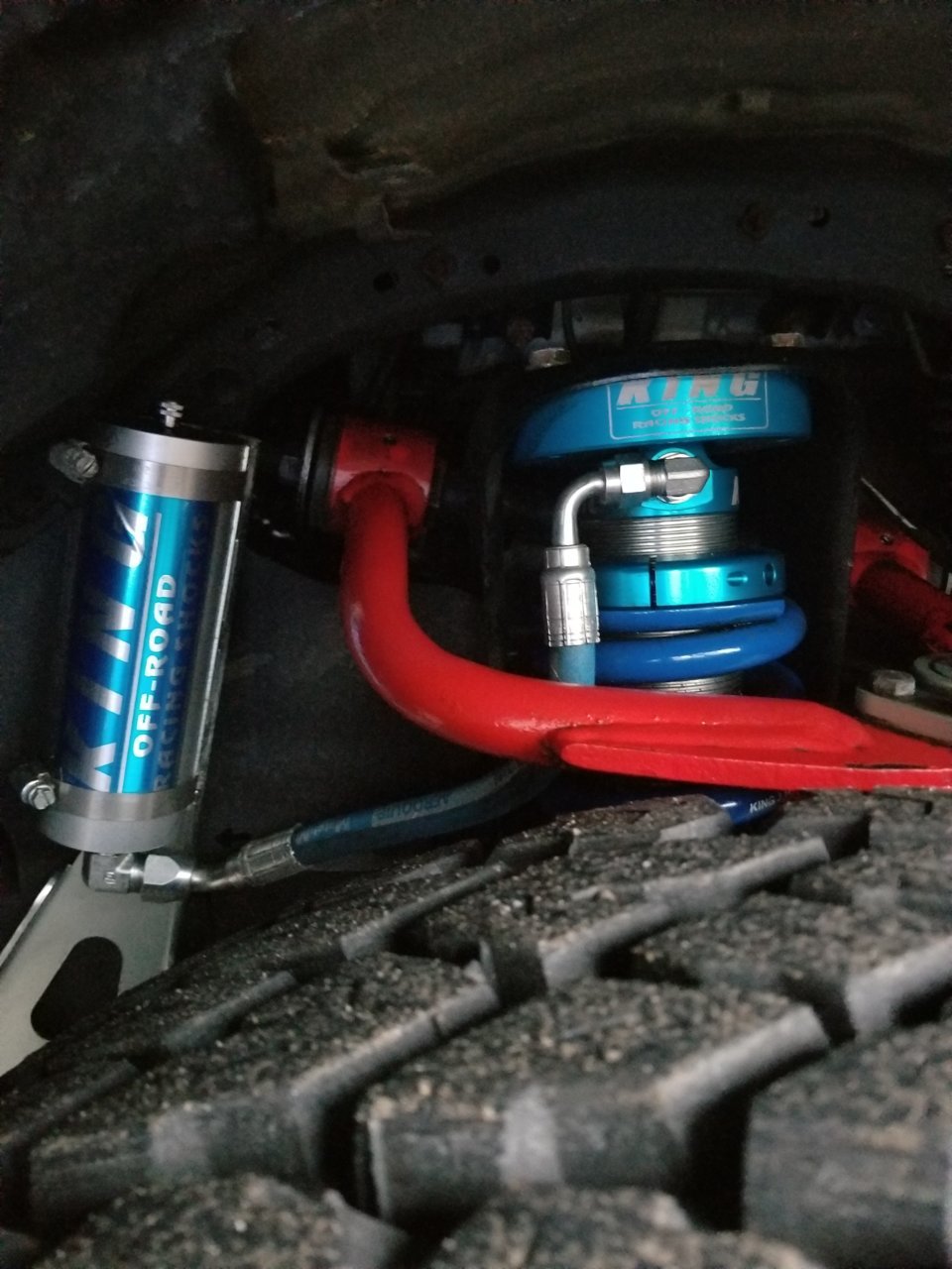

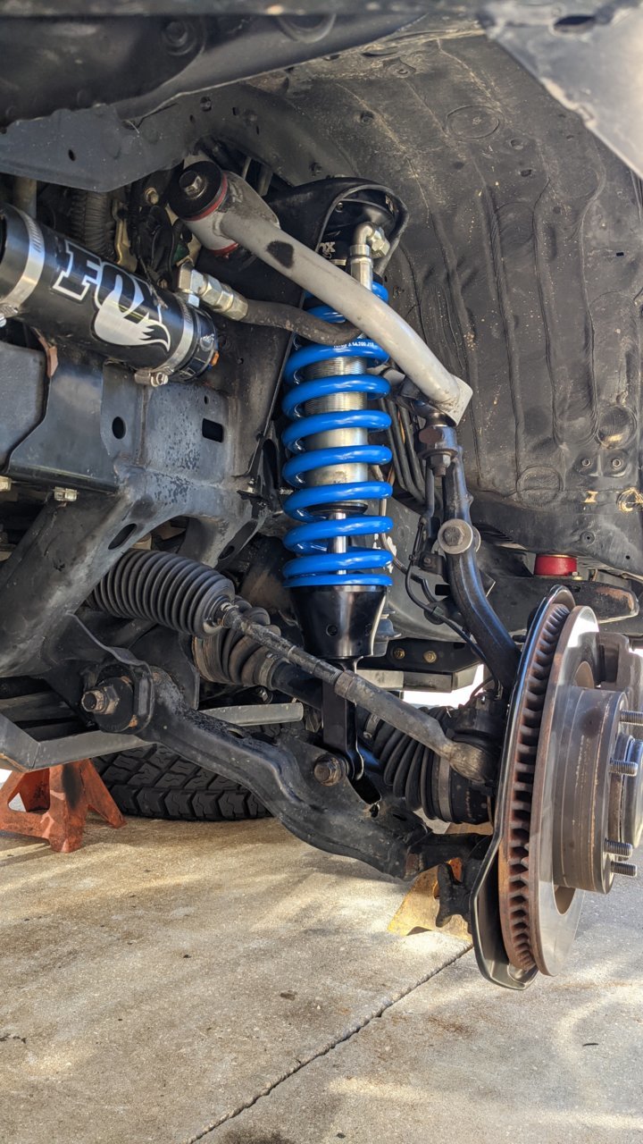

    We get this question A LOT, so we used a Tacoma front coilover as the example. Seems fitting for this forum :D
    Fox 2.5 Coilover, Remote Reservoir 0-3” Extended length with DSC (FOX-880-06-418)
    King 2.5 Coilover, Remote Reservoir 0-3” Extended length with Adjuster (KRS-25001-119A-EXT)

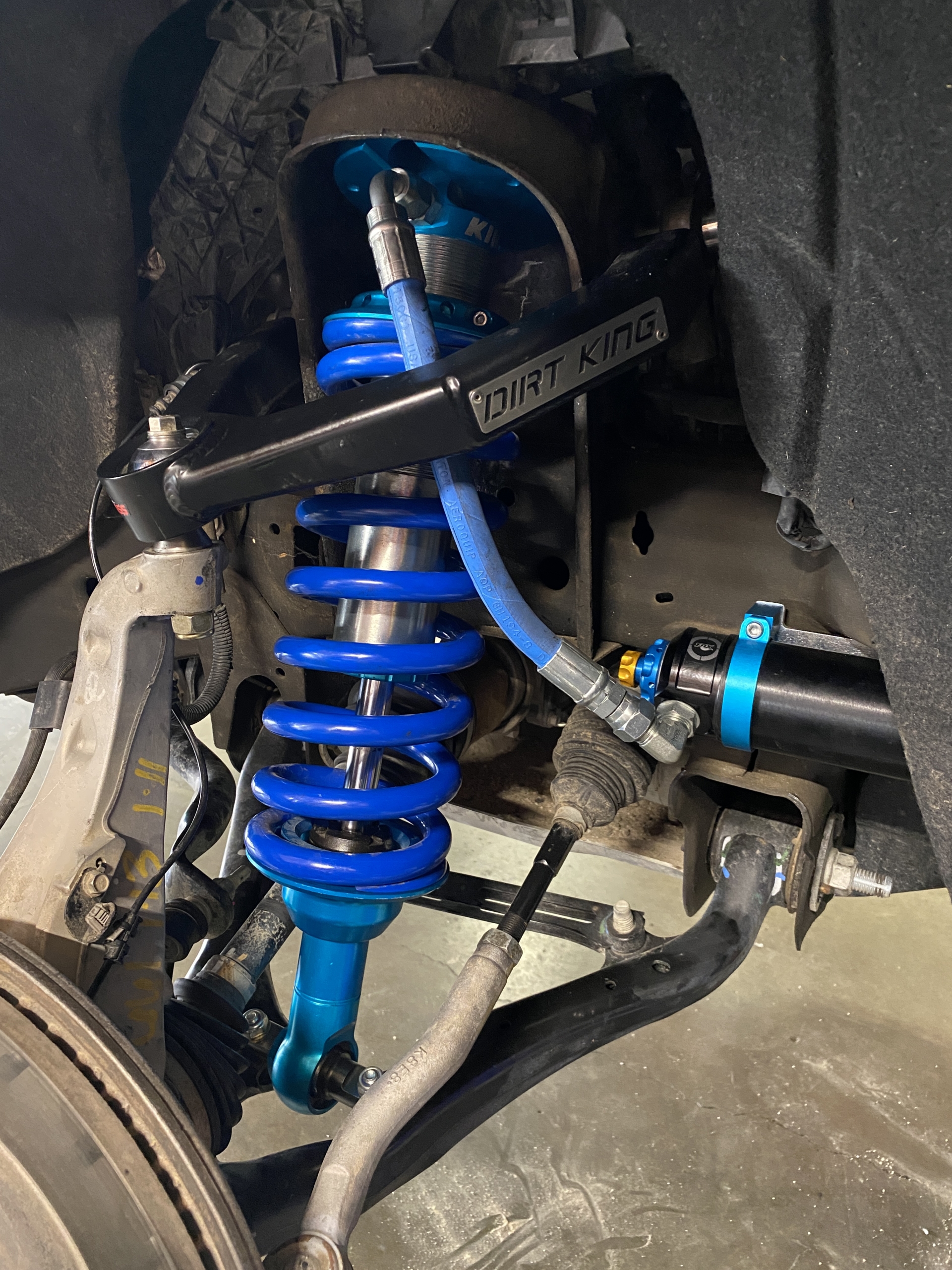

    How about this for some Kox Shocks: (Chevy TrailBoss)

    Took me a minute! That's sweet custom valving on the DSC's too I would assume?
    Never knew you could do that!

    Customer already had the King Coilovers, and instead of adding King adjusters, they went with the Fox DSC. I dont believe we valved the DSC on these ones.

    I've added DSC's to a few kings, great combo and you usually don't need to revalve the DSC it's self.

    This upgrade would be replacement of the entire reservoir, not swapping the adjuster units themselves correct?
