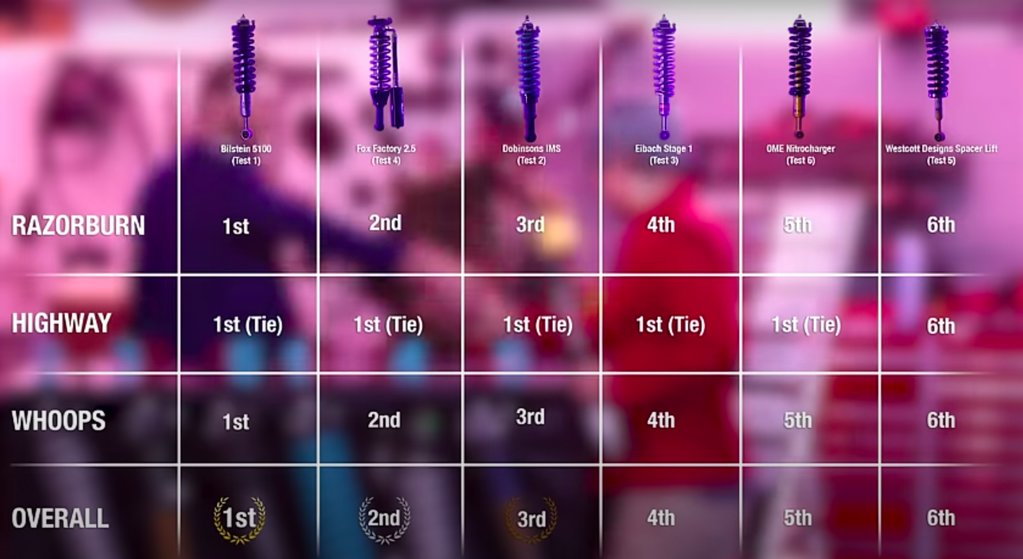

    Just do what us smart members do... Also great on the highway!
