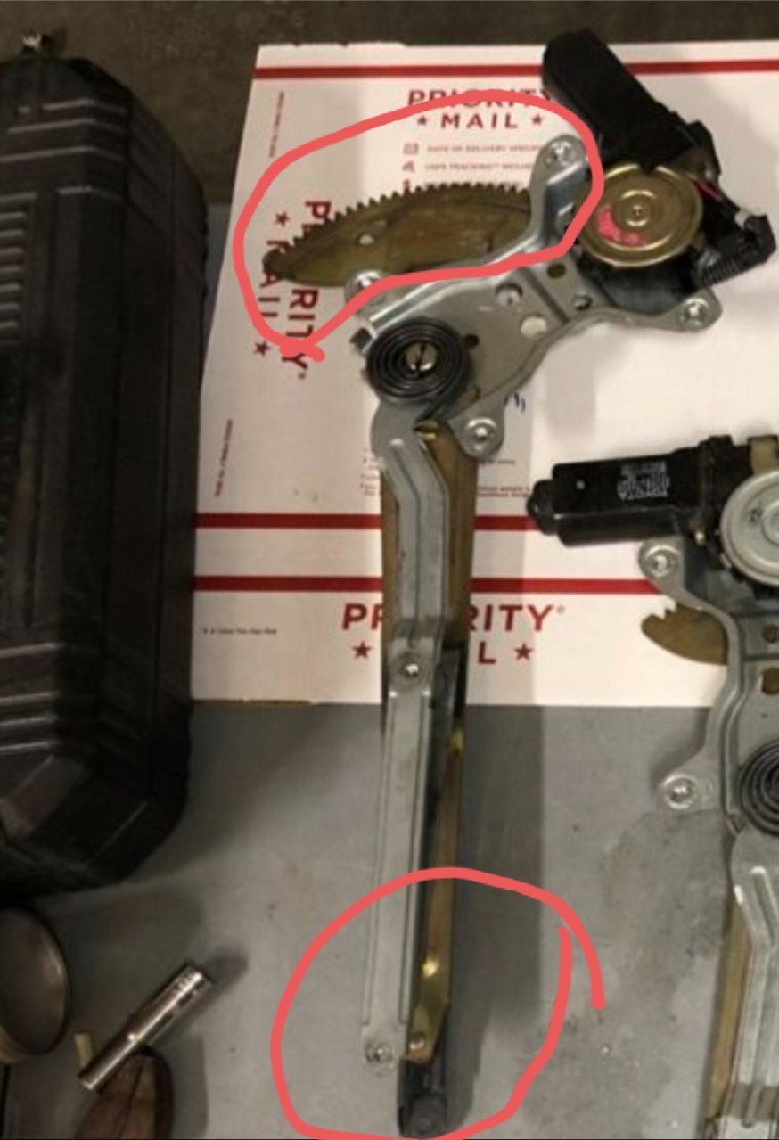

    is that aka the 'run channel' rubber piece?
  10. Nov 18, 2020 at 6:55 PM
    Abeyancer
    Abeyancer Not so secret, secret van guy
    Mar 28, 2019
    #288326
    13,245
    Jimmie
    PNW
    98 4x4 ex cab tacoma 3rz
    No I mean this channel circled in the lower portion of the photo.. not a bad idea to redo the gear teeth as well20201118_185410.jpg
