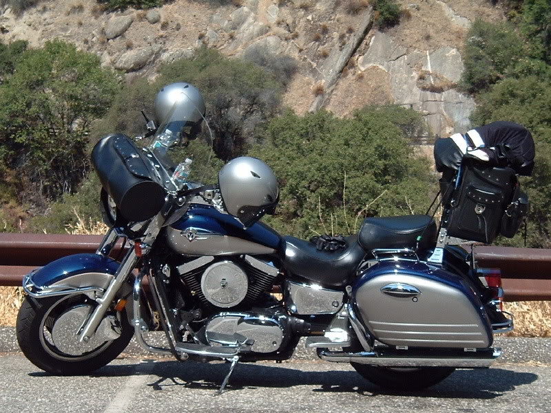

    My Nomad 1500 weighs about 800 lbs. With me sitting on it it's well over 1000 lbs.
    I don't DARE put it in the Taco!
