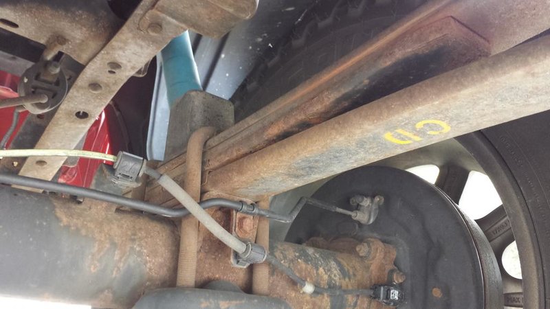

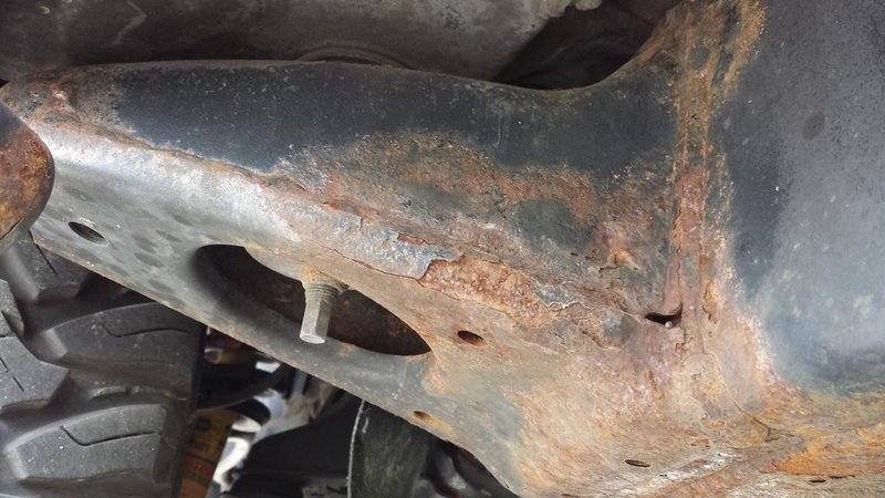

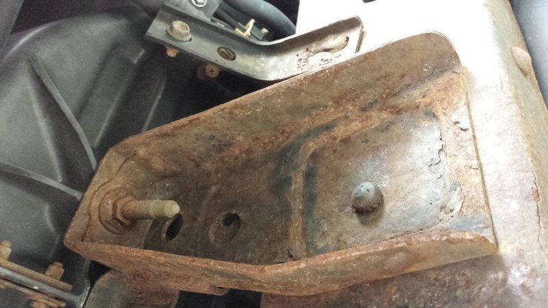

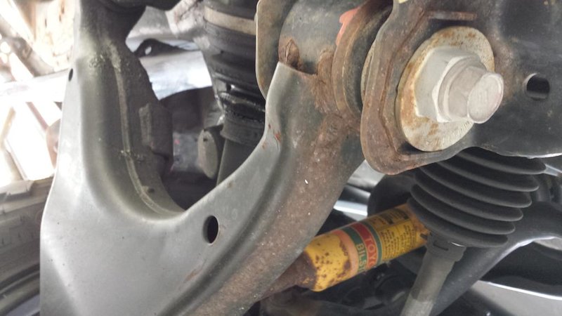

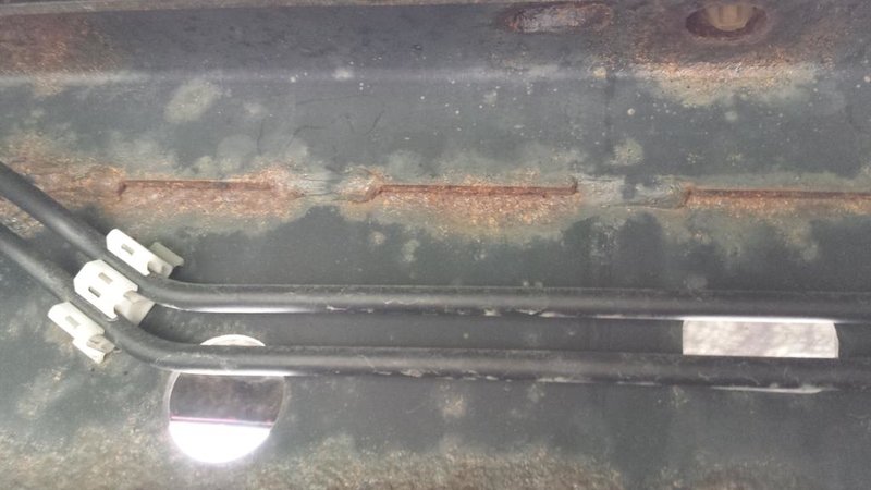

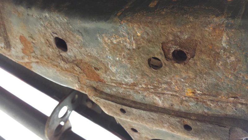

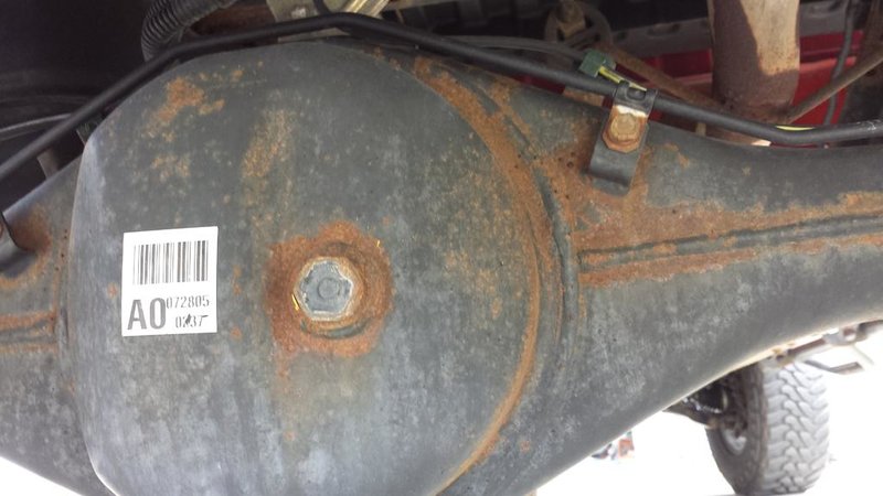

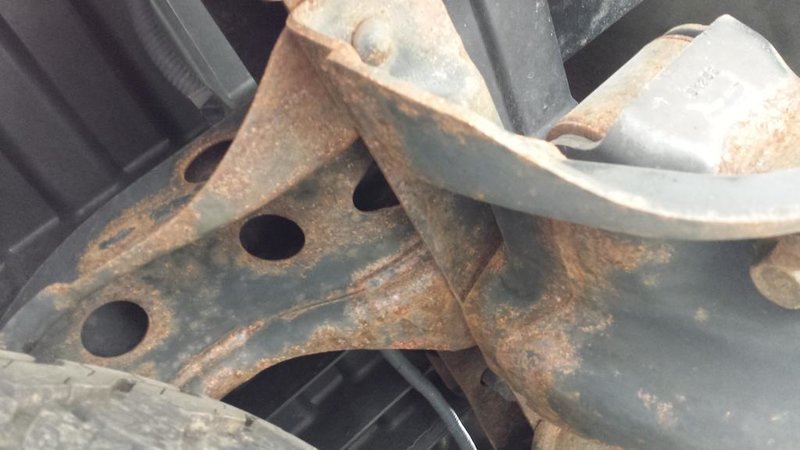

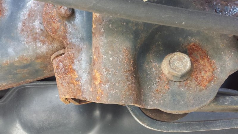

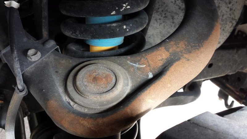

    I have a plan for next weekend. I'm going to get some marine clean, metal ready and one of those 6 packs of POR-15 gloss black with a rattle can to cover the frame near the wheels (to protect from UV).
    My question is, do you think I should use a needle scaler to remove this rust? It's flaky in some areas. I'm sure a metal brush is normally fine, but this is Salt lake, and the roads are hazardous to metal in the winter. What have you guys done that you find works well?

    I had lighter rust areas than that , I scraped, wired wheeled them, degreased the area, primed and painted. Some areas the rust started to come back a little, but most areas still looks good.
    I also started using fluid film and that stopped the rust in those bad areas.
    I think if I had it do do all over again I would just use fluid film every year.
    It's just really hard to get all the rust out in order to paint.

    Yeah that's why I was going with POR-15 - it bonds to rust and seals it up. As long as you have a top coat in areas that get hit by the sun, it should last quite a while. I'll post pics once I'm done.
