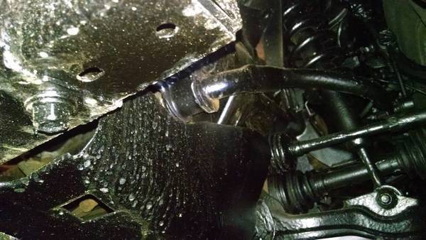

    Hello everyone, this is my first thread, so please bare with me.
    Since I live in the Northeast, and my truck came from southern NH and northern MA, there was of course surface rust on the frame of the truck. So me and my father tried to wire-wheel the frame, and then use Rustoleum undercoating from a can. Well, it did not last one winter. I don't have any pictures of what the frame looked like before I brought it to Auto Rust Technicians.
    Here is their website if you want to read up more on these guys:
    http://www.autorust.com/
    And another note, one day after I brought my truck to them to have the undercoating done, I saw that Toyota had released the LSC for 05-08 Tacoma's :rolleyes:. But since I had already brought the truck there, I was just going to stick with it.

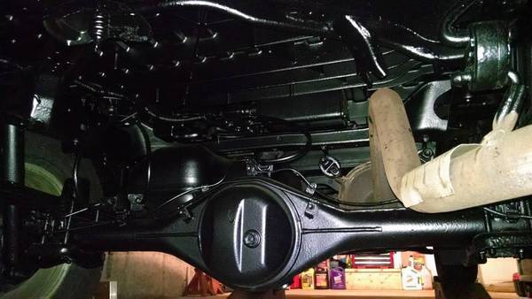

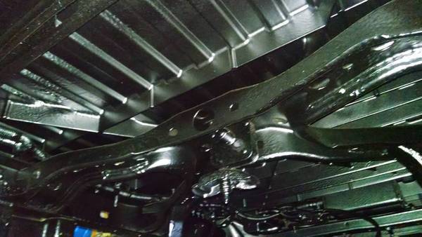

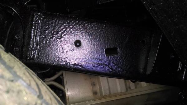

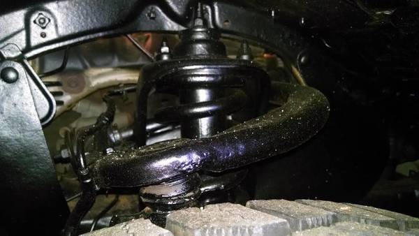

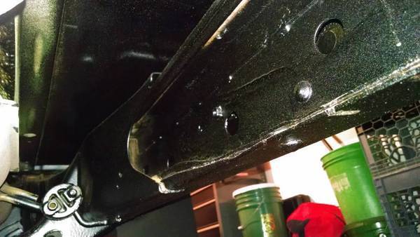

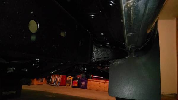

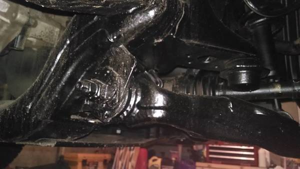

    Here are pictures of how the frame looks after they sandblasted and then undercoated the frame (don't mind the dirt, it has been raining here the past couple of days:

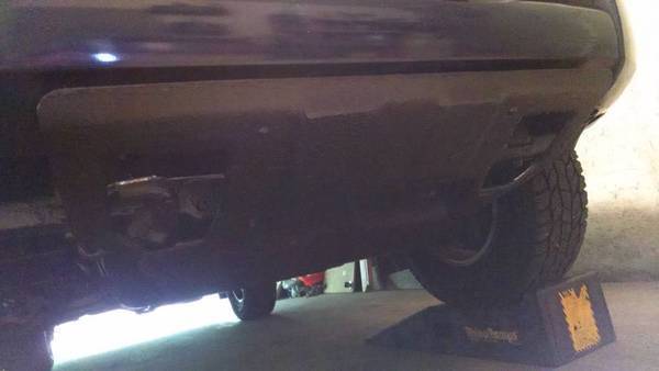

    And as a bonus :cool:, they undercoated my skid plate, which does look a little better than the grey:

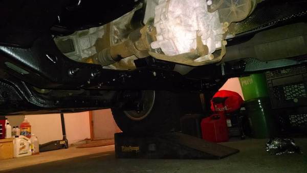

    As you can see, they got almost everything, including the wheel wells, skid plates, rear axle, under the cab, and even the bed (which I don't think they knew was plastic :rolleyes:). And from a couple pictures up above, they did not get into the boxed part of the frame, which is disappointing, but they did say they typically don't spray into there. I also found that there was a lot of blasting media on top of the skid plates and dust everywhere in the engine compartment, which I just cleaned today. If you do go here to get your frame coated, take off anything underneath the truck that you don't want to be coated, or they will coat it (found out by my skid plate).
    So overall, I am happy that I went this route than going to Toyota for the LSC. The big reason is that they sandblast the frame, rather than just powerwashing it. If you live in the Northeast, and don't mind taking the trip to Rhode Island, to get your frame coated, I would definitely call to make an appointment.
    EDIT: If you do decide to go this route instead of using Toyota, you should take off your skid plates and the rubber flaps in the front wheel well. They will hit those spots better if you take those off first (and so they don't undercoat them as well).

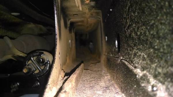

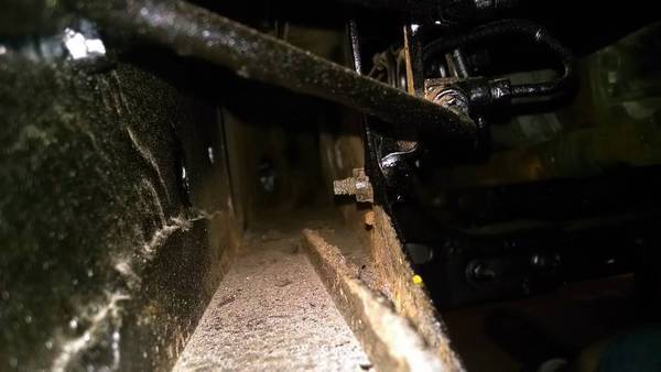

    looks like they did a really good job. Shame they can't inside the frame.

    I wanted them to, but they said their tools could not reach far enough inside the frame. I guess I will try out fluid film for the boxed section.

    They sandblast places that have rust, so you wouldn't have to worry about rust be trapped underneath the undercoating. I need to buy fluid film, so I can do inside the boxed part of the frame.

    Looks great. Would haved liked to see the before pics.
    After sandblasting, do they paint then undercoat, or just undercoat.
    It looks like a really good paint job.
    Are u going to use fluid film on everything, including the inside/outside of the frame?

    I wish I had taken pictures before I had this done, but I forgot to :facepalm:. But yes, they paint the frame before they use the undercoating. The company also fixes body panels if they rust through, and they use the same paint to keep the new panels from rusting.
    I actually wasn't going to coat everything with fluid film, as it seems like their undercoat repels water really well. I was just going to spray the inside of the frame, and parts of the frame that are exposed under the hood.
