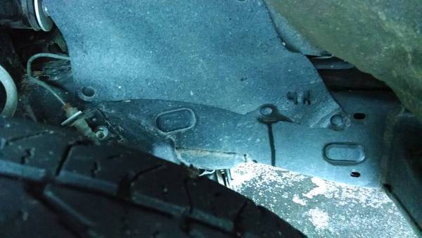

    vram74, here is the picture of where the plugs I bought go into the frame inside the front wheel well:
    Its just the reverse on the other side (picture is of driver side).

    ^^^Thanks :) It may be the way the pic is taken, but it appears as though the plugs are two different sizes.
    Going to order these. I live in the South, but they do occasionally use salt here, and I do go up north a couple times a year to visit family.
    Stupid problem to have, really :rolleyes: Even in southern states, they should at least perform a frame inspection, spray the wax on the inside of the frame and plug every hole afterward.

    Don't worry, they are both the same size plugs. I think its just how the water was around the back plug that made it look bigger.
    I agree, they should at least do an inspection in all states, not just in the cold climate ones.
