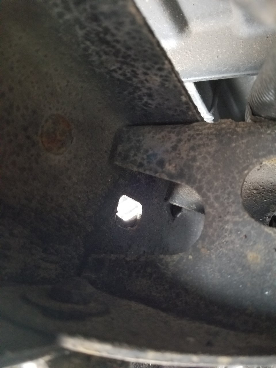

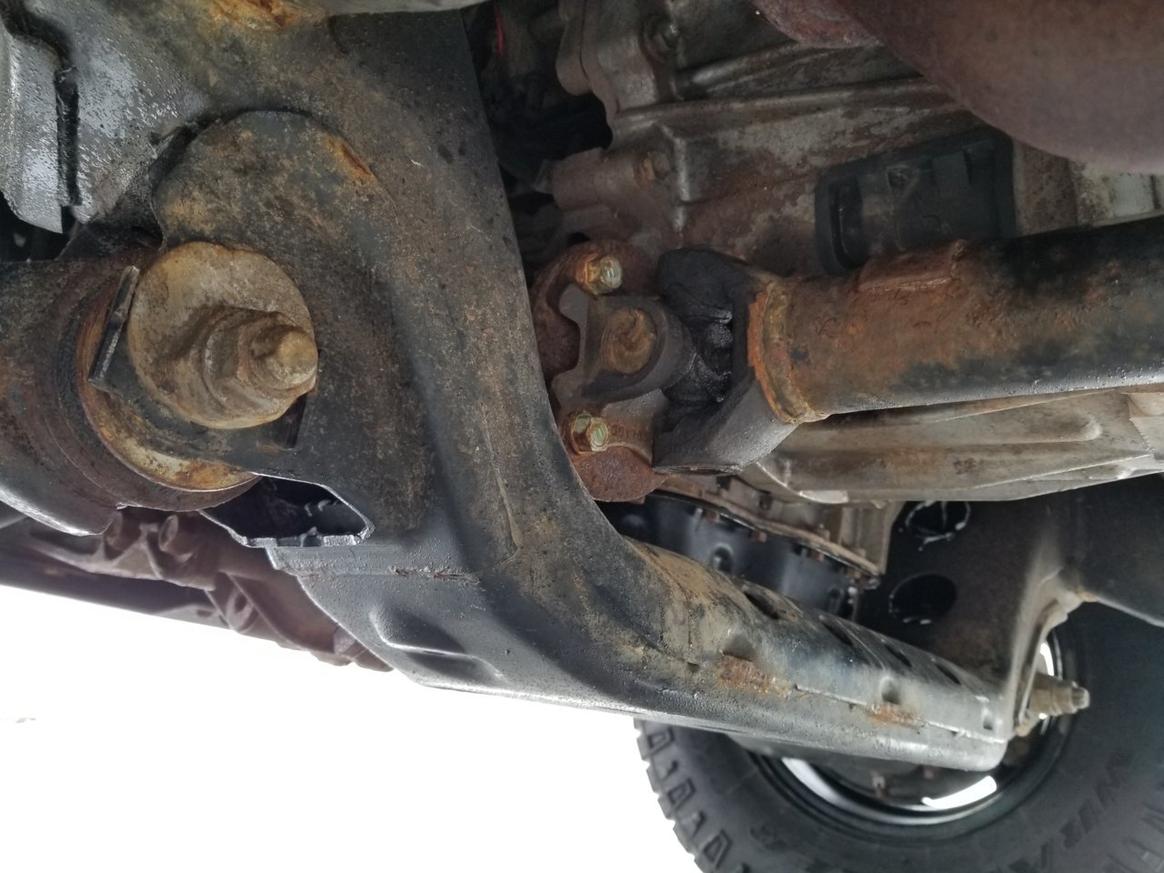

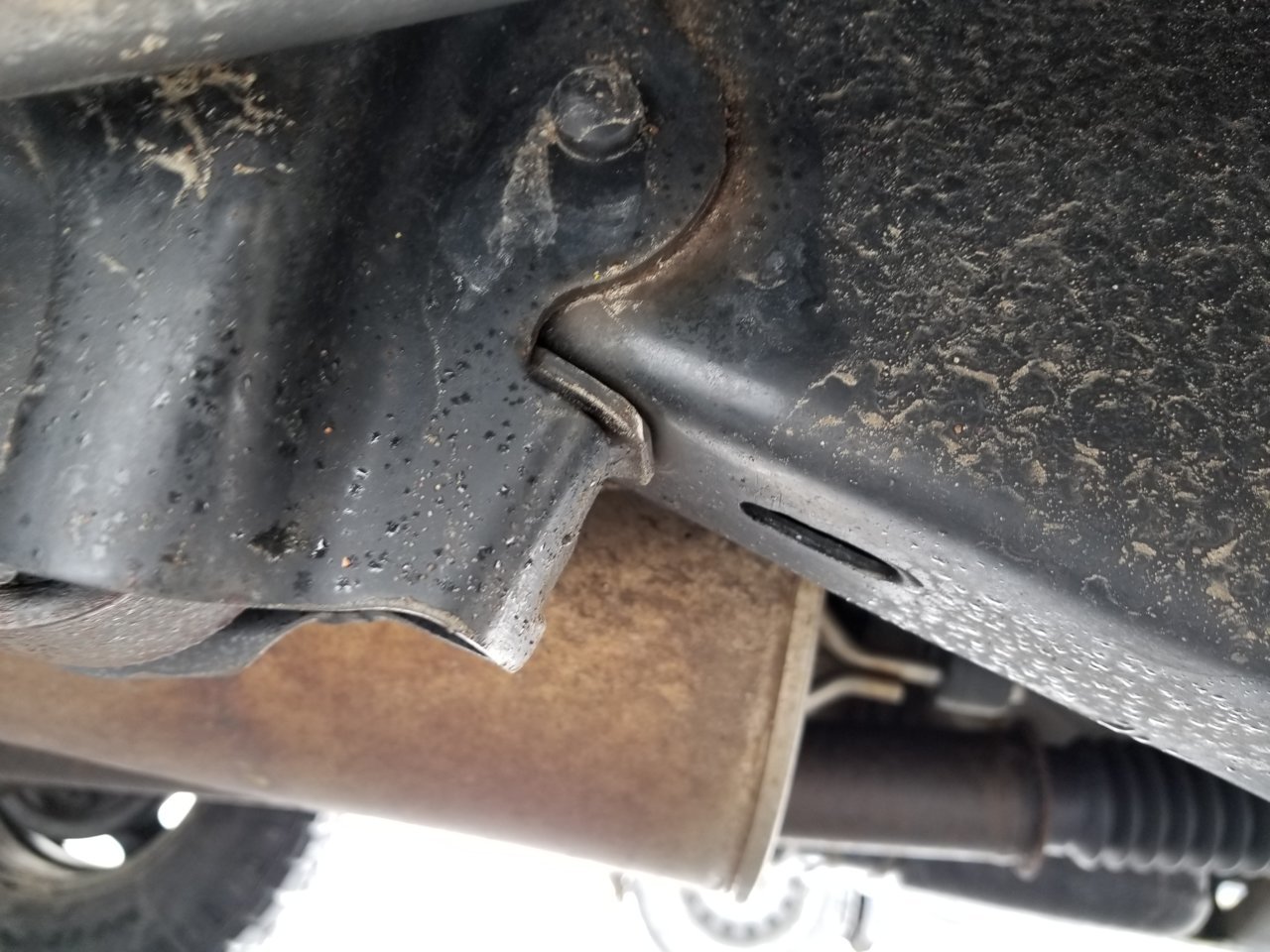

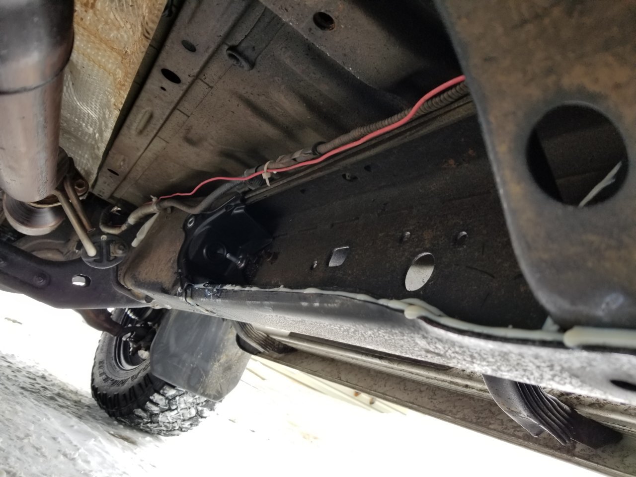

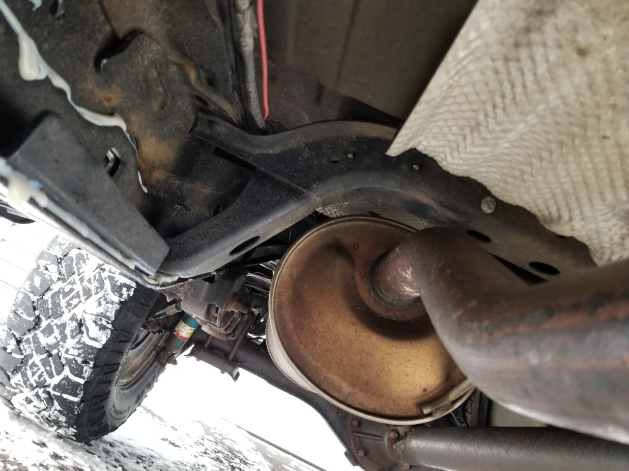

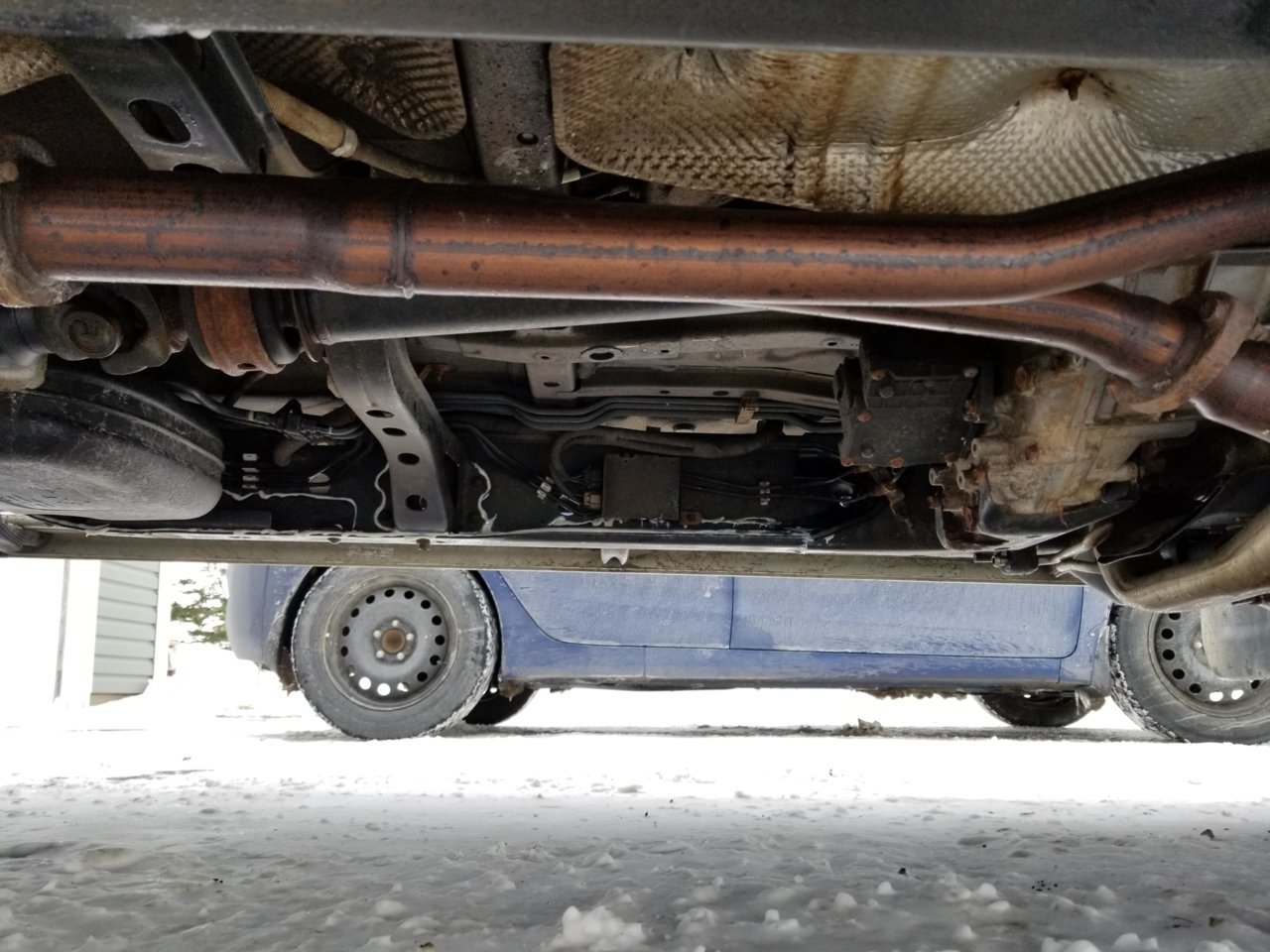

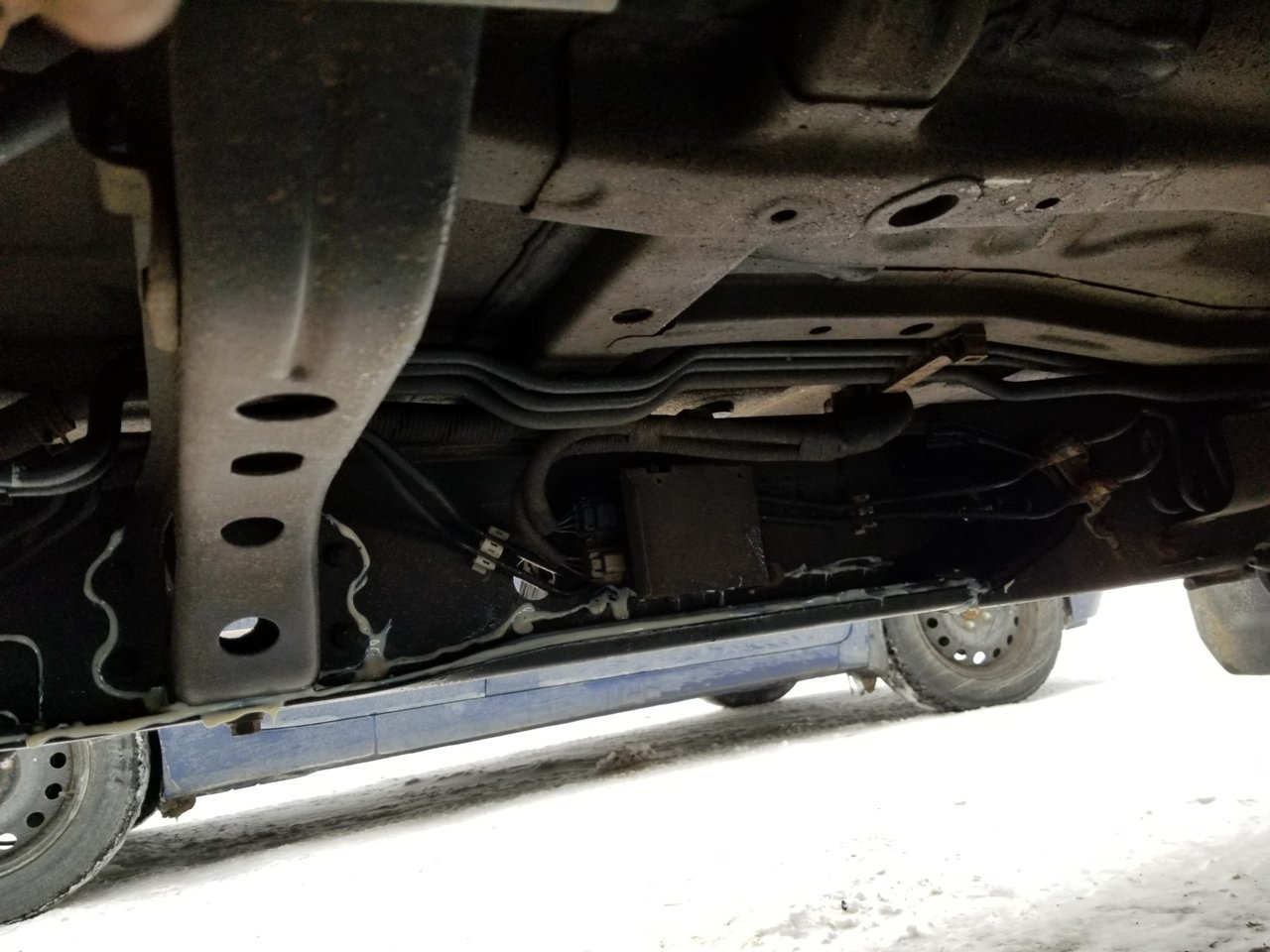

    Sent my 2016 in for the frame inspection and coating: campaign L32.
    I was under the impression this was a wax like coating on the entire frame and would take 24 to clean/dry and 2nd day for coatings.
    Got truck back within 24 hr of dropping it off. They dried it overnight, put what looks to be a gum substance on the inside seams only applied some end caps/plugs and dried 1 hr before pickup. Curious if this is what everyone else is seeing or if theyre shortcutting here. See pics. No exterior seams treated just inside the frame.. 20200201_111135.jpg 20200201_111120.jpg 20200201_111135.jpg 20200201_111135.jpg 20200201_111135.jpg

    Damn that thing looks beat haha. That coating looks abysmal at best.

    Where do you live? That looks like it has seen a lot of salt

    Shit man I live in the Chicago suburbs (tons of salt here) and my 2012 has less than half the rust your 2016 does. Even the 3rd gen frames suck- come on Toyota

    You at least satisfied Toyota crc recall campaign to maintain your future eligibility if you should need a new frame. If that was my truck I would wait until spring hose / power wash frame to remove the salt build up. I would wait a day to ensure proper drying, use wire wheel to remove rust use Ospho rust neutralizer, Eastwood primer, Eastwood black Chassis paint and finish off with Amsoil heavy duty metal protector. Eastwood also makes an internal frame protection spray. This is my regime that I use for my frame. I find by using this regime I'm doing less touch up as the years go by. I find fluid film washes away to easily. My .02

    This looks like a case of "its a truck, it should be dirty" but turned into salt removal neglect.

    That's exactly what it's supposed to look like once done. The campaign only coats a section of the interior of the frame. Then plugs are installed. Looking at some pics, they may have gone a bit further waxing additional areas for you.

    The frame was power washed friday as part of the crc application.. thats 1 day of salt/dirt... appreciate the suggestions seems thorough. Eastwood pricy?

    Maritimes. I drive across a causeway daily so the truck is routinely exposed to salt spray..

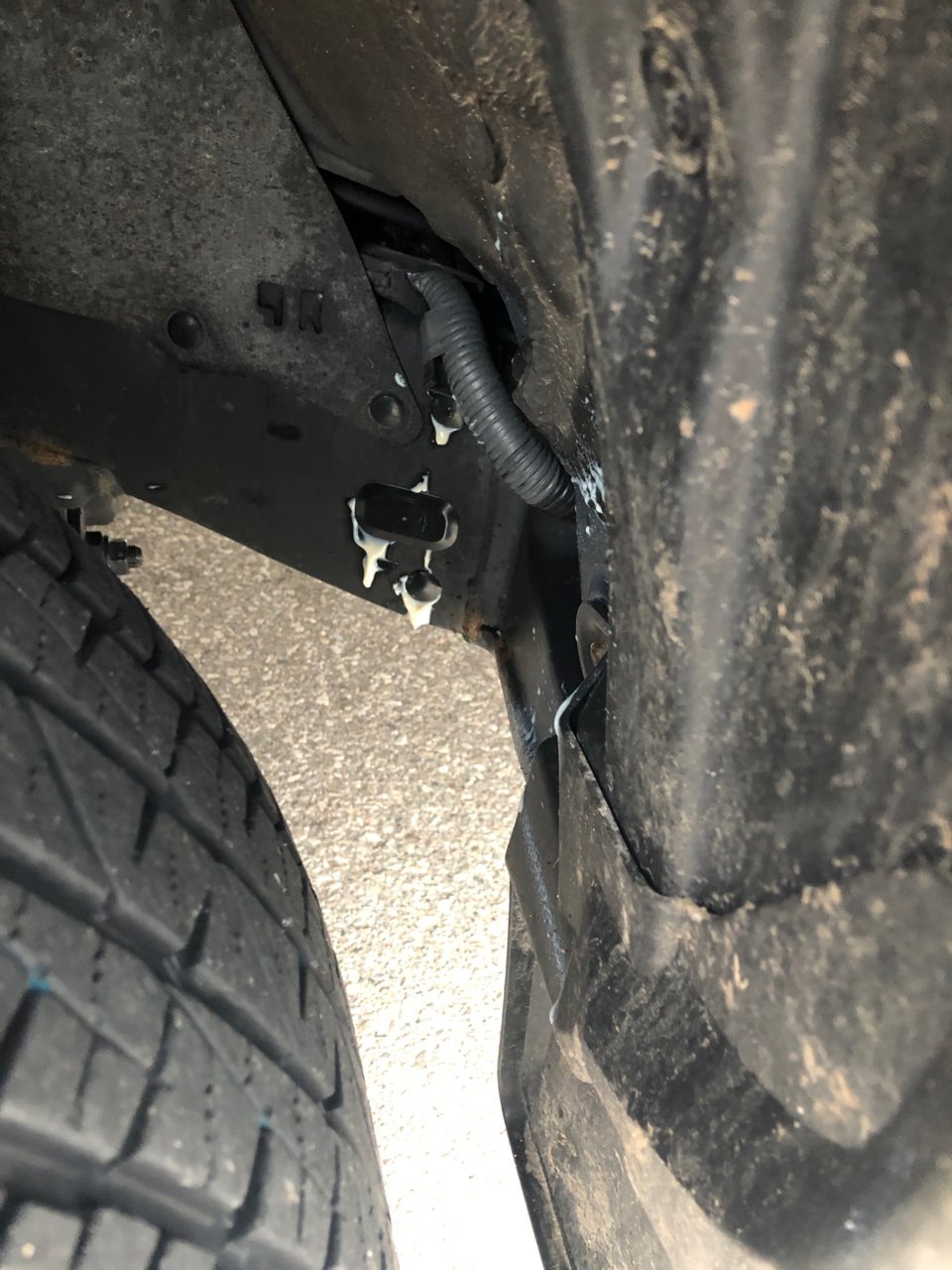

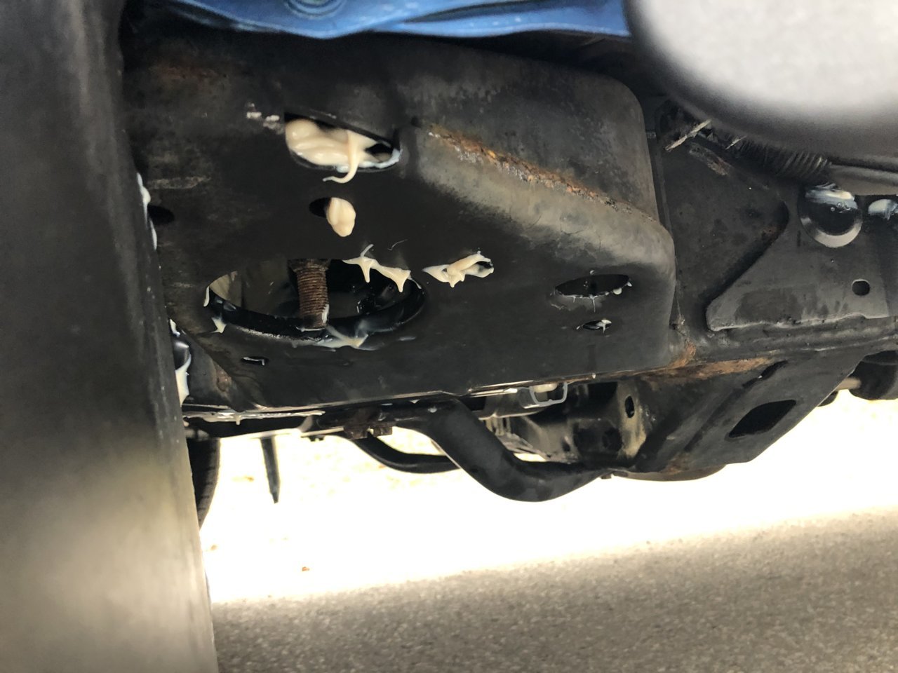

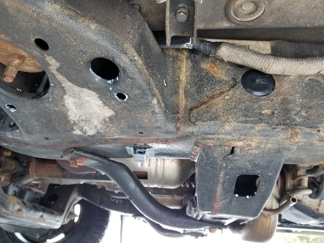

    Here is how my 16 looked right after it was done a few days ago.
