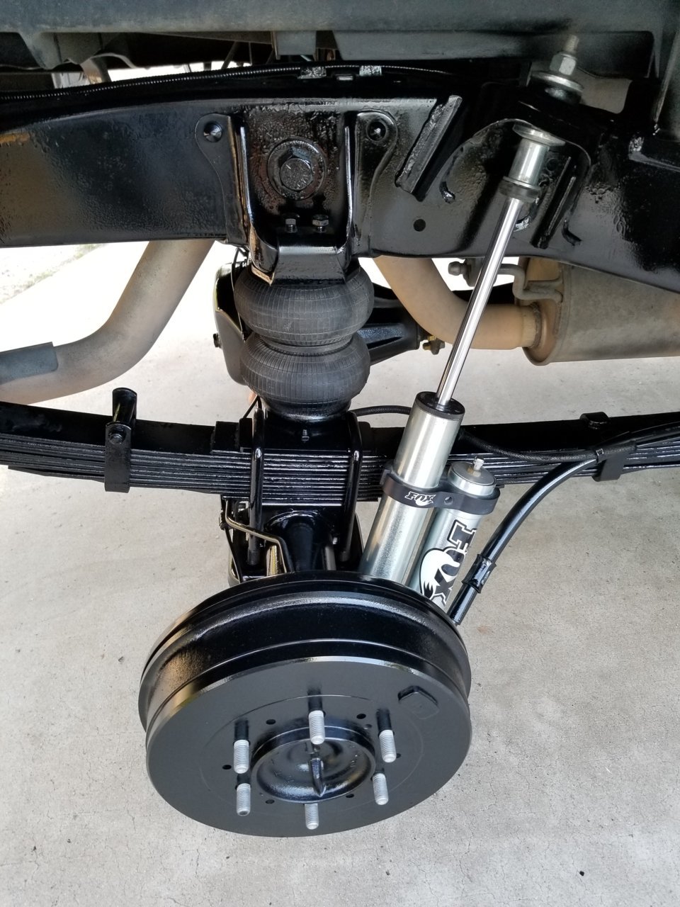

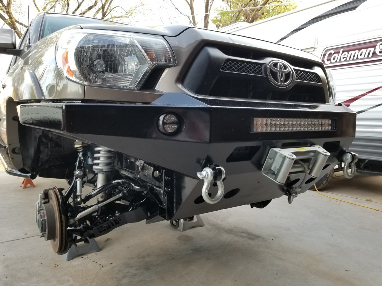

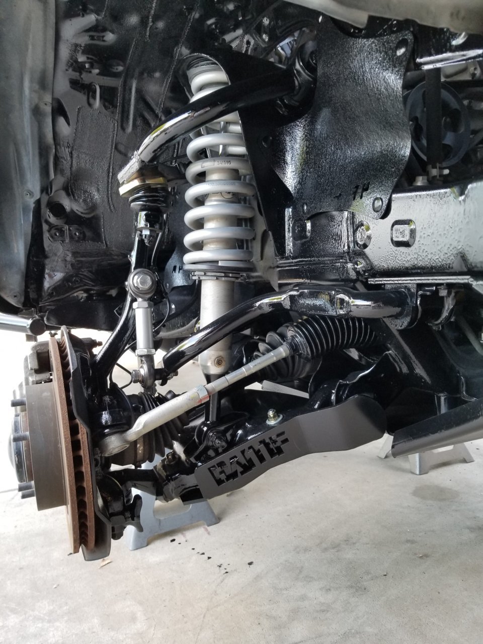

    Harbor Freight spray gun or better will work, just use a large tip, it's thick. Sprayed it all up inside the frame holes where I could until it was dripping out, let it dry and did it again. I have stepped up to Kings, did my spindles, skids, cross bar brace/side plates for BAMF hangers, and some spot touch ups. This stuff last for years.

    I spent about $65 bucks and did my complete truck. Good luck with your truck and that treatment they did.

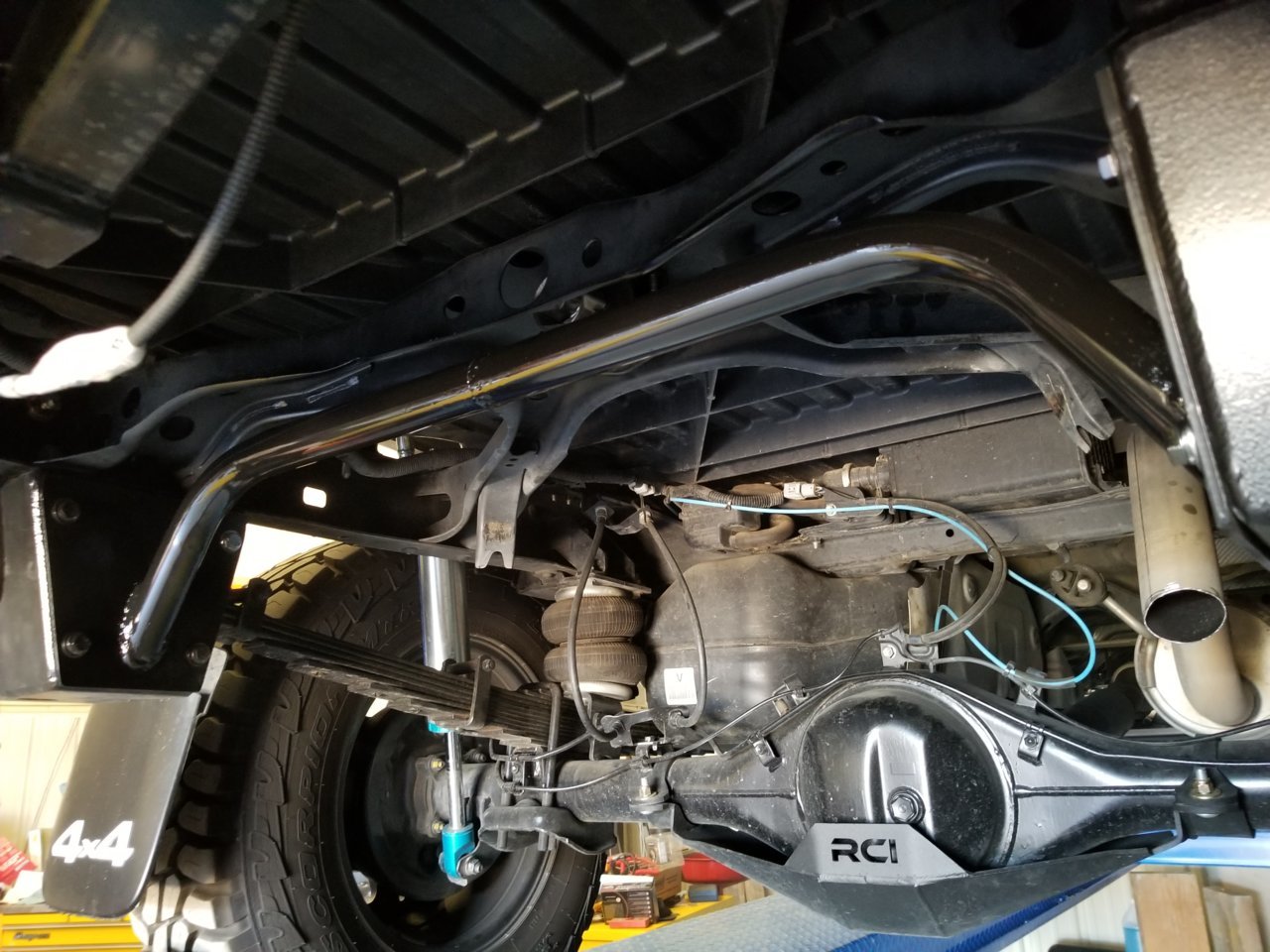

    I have posted this process out here somewhere, don't remember the title. Here is the cleaner I start with, don't let it sit on aluminum. I use it on my bumpers and side bars also. Zoom in on side bars, this is the completed process. Been using this epoxy paint for over 30 years now on many different vehicles. Good luck.
