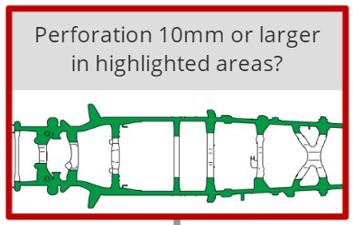

    Inspection:
    • An inspection will need to be performed before replacement. Contact your dealer's service department to make an appointment to have this inspection done. I do not know if you will be receiving any letters in the mail for this support program.
    Inspect for Frame Rail Seal, If installed there will be no further action. If no Frame Rail Seal is found than perform inspection for a 10mm or larger hole. If a hole is found it will be submitted to Toyota of approval. After approval, parts will be ordered and the frame will be replaced.

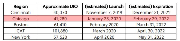

    Spray Coverage:
    K0D will be available fall 2019 for a period of 2 years and only to vehicle registered or regularly operated in these cold weather states.
    Cold states: District of Columbia (DC), CT, DE, IL, IN, KY, MA, MD, ME, MI, MN, NH, NJ, NY, OH, PA, RI, VA, VT, WI, and WV.
    Warm weather states will not have the CRC coating applied.
    Once campaign K0D expires, if a cold climate state vehicle has not had K0D performed, the vehicle will no longer be eligible for ZKA and will be marked as expired under ZKA. ( Once the 12 years from Date of First Use is up the frame will not be replaced. )
    Region Availability:

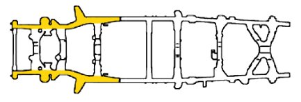

    CRC frame application:
    The frame will have a CRC coating performed inside the front half of the frame, this includes the inside of the front boxes section and certain areas of the open mid section ( C channel ). There will be no coating at the rear frame sections. The inside frame rails will be dried with a frame dryer for 3 hours to ensure any water inside the frame is removed before the cleaning process can be performed. After the cleaning process is performed the technician will use an endoscope to inspect the inside of the frame before the CRC application can proceed. A heated wax based CRC is used to coat the inside of the boxed frame and locations of the mid open section. There will be no exterior coating in this campaign like used in the 2010 and previous years.
    The front wheels, suspension braces and front bumper will be removed for the cleaning and application process.
    This will be very similar to the previous year frame replacements. If there is no hole found the vehicle will be coated as previously stated in this post. If a hole 10mm or larger is found it will be submitted for a frame replacement. If approved the process will move further and the frame replacement process will begin. Be advised with this program being released there may be a waiting list depending on your dealers schedule and depending on how many vehicles show the need for replacement.
