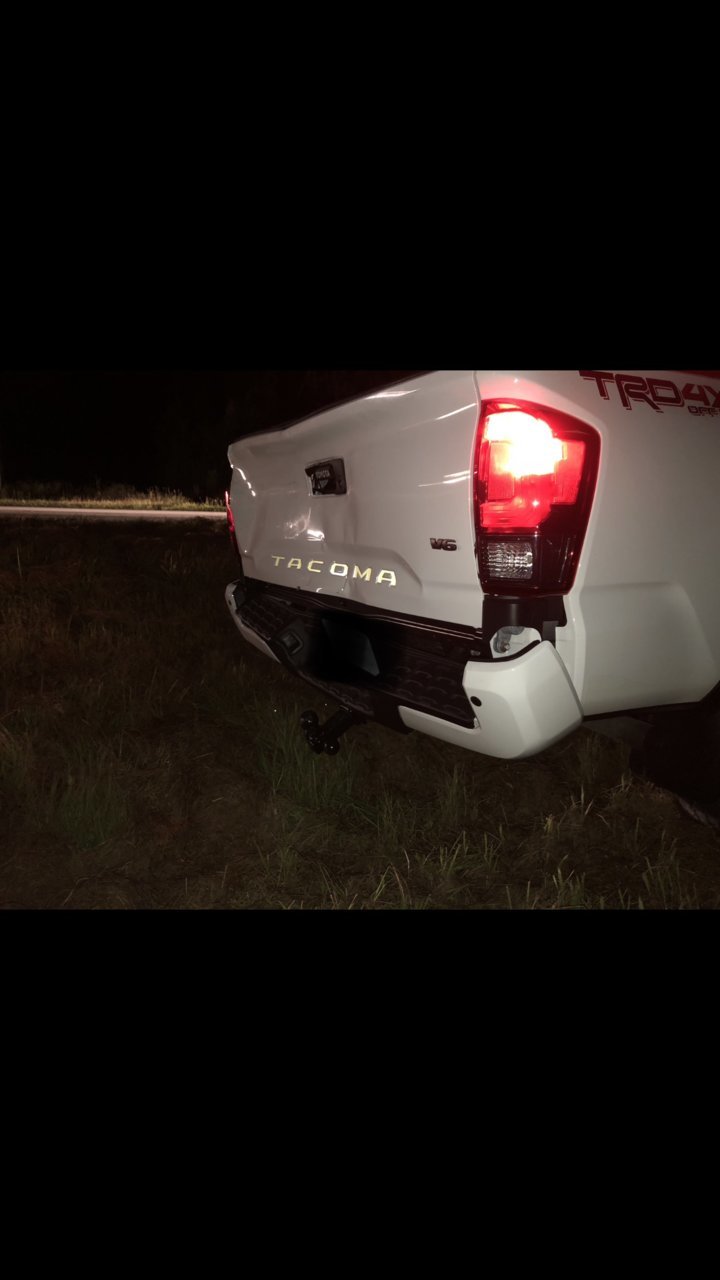

    Update: After a whole month of going back and forth with the collision shop and my insurance adjuster, I was told a frame replacement was needed. ETA for the frame is 30-60 days, this is for the frame itself, DOES NOT include the repair time. All said and done, my insurance adjuster still would not total out the truck. On top of that, my insurance over covers up to 30 days of rental, that coverage is coming up soon. The adjuster told me to go through the other party's insurance since they "should" cover more than 30 days. I'm caught on the fence of filing a lawsuit. 4-6 months to repair my truck?
    Any advice is greatly appreciated as I do not have much experience with this.
    I just got word back from the collision center for the damage on the truck. I was told that it would need a completely new frame, but the car still wouldn't be totaled. $17k in repairs and still not totaled?
    Hey guys, I talked with my insurance agency and was wondering what the best course of action I should take.
    1.) Go through my insurance and have them handle it with the other parties involved (Ford + GMC).
    2.) Go directly to Ford's insurance (One who rear-ended the GMC who hit my car).
    Any help would be greatly appreciated!
    Update: Went to the tow company to take more pictures. I was nearing an intersection with heavy traffic. I was stopped. The GMC was either coming to a stop or was already stopped. Ford driver was speeding/not paying attention but claims he was "nudged" from a car behind.
    Got my 2018 Tacoma back in June. Just hit 5k miles on it today. Was coming back from a concert and got rear-ended. 3 car accident Ford, GMC, my truck. Ford rear-ended the GMC. I was in the front and was hit by the GMC. I thought the truck was not as bad, but looking at it closer I worry that the frame is damaged. The lower portion of the truck bed is almost touching the sides of the cab. Tow-hitch is bent downwards. Would that be an indication of frame problems?

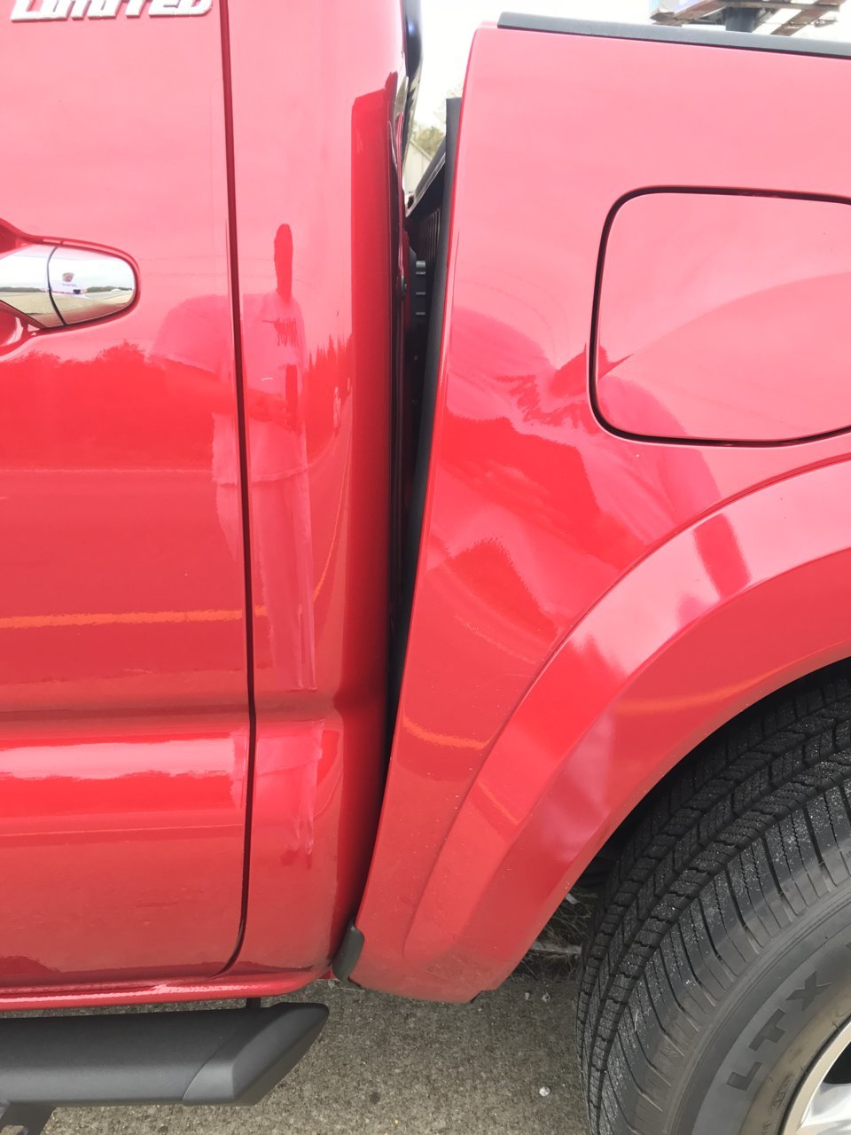

    The bed not matching up would have me worried about a bent frame. The frame maybe bowed at the cab and bed space causing the bed to be closer at the bottom then the top. Or it could be just a bed misalignment. Have a different body shop look at it.

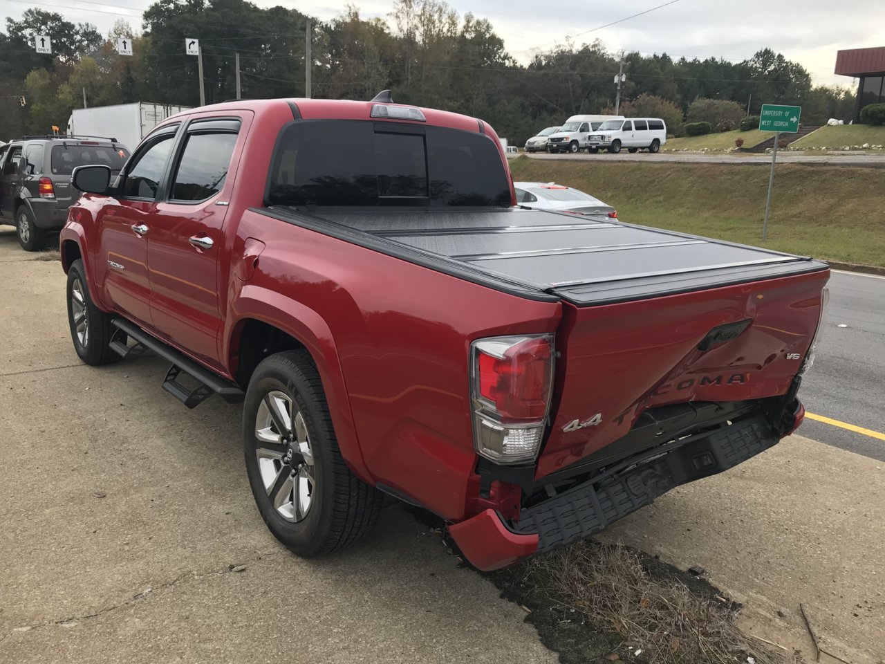

    My first 2017 Limited looked almost exactly like that after being hit at a red light...~10,200 miles and just a little over 1 year old...Totaled...

    That being said, if you look underneath you'll probably see the frame bent past the rear axle if nothing else since the receiver hitch is basically bolted to the frame and is now pointing down. Frames can be straightened.

    Any time you see the receiver bent down on a tacoma there is frame damage. It bends the rear of the frame after the leaf hangers, almost always.

    need daytime pics?, more than likely you will need the bed replaced and if the hitch is bent down you could have frame damage, my concern since I used to do full frame collisions is that a rear end hit could push the frame bolts out of whack and you could end up with serious issues down the road if they are not caught...
