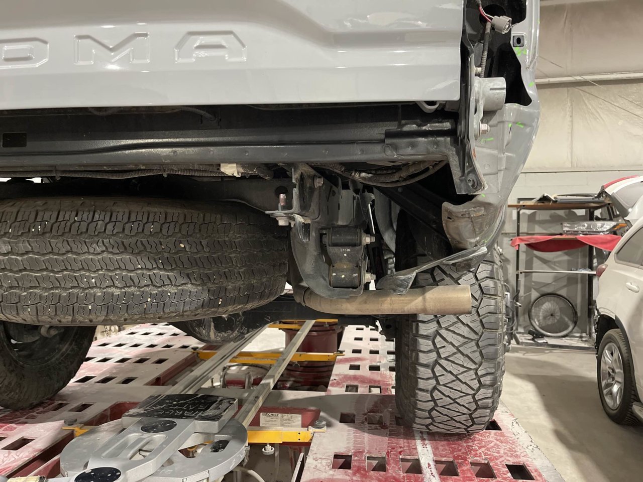

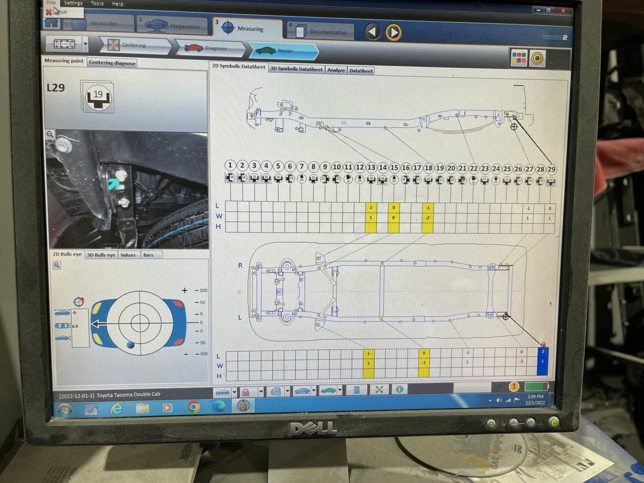

    My 2018 Tacoma was rear ended and the car went halfway under my truck, making me concerned about the frame, etc.
    These are the numbers they sent me from Toyota regarding the frame measurements.
    Is this normal? What is this showing?

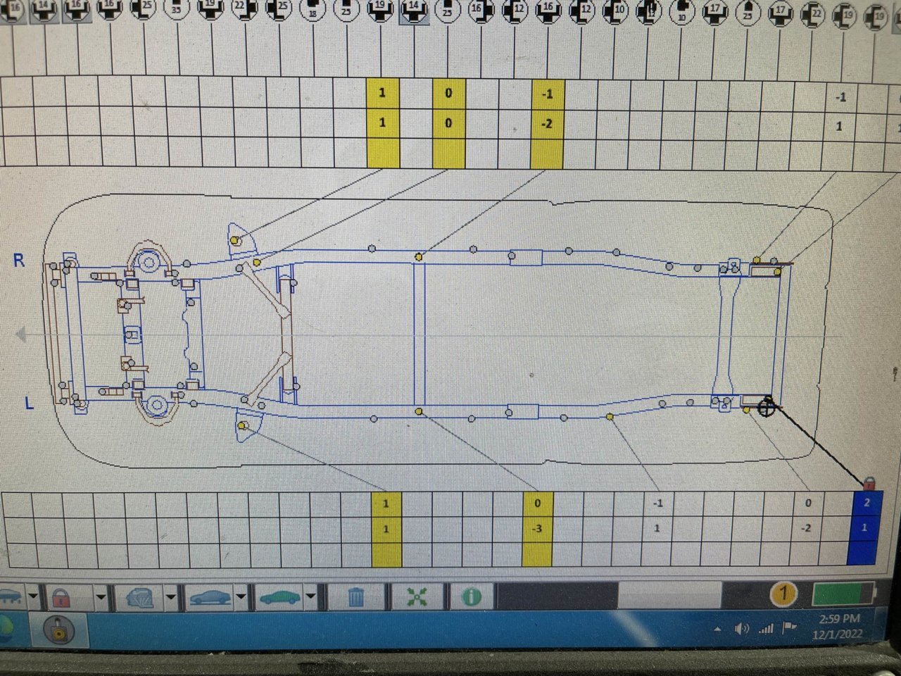

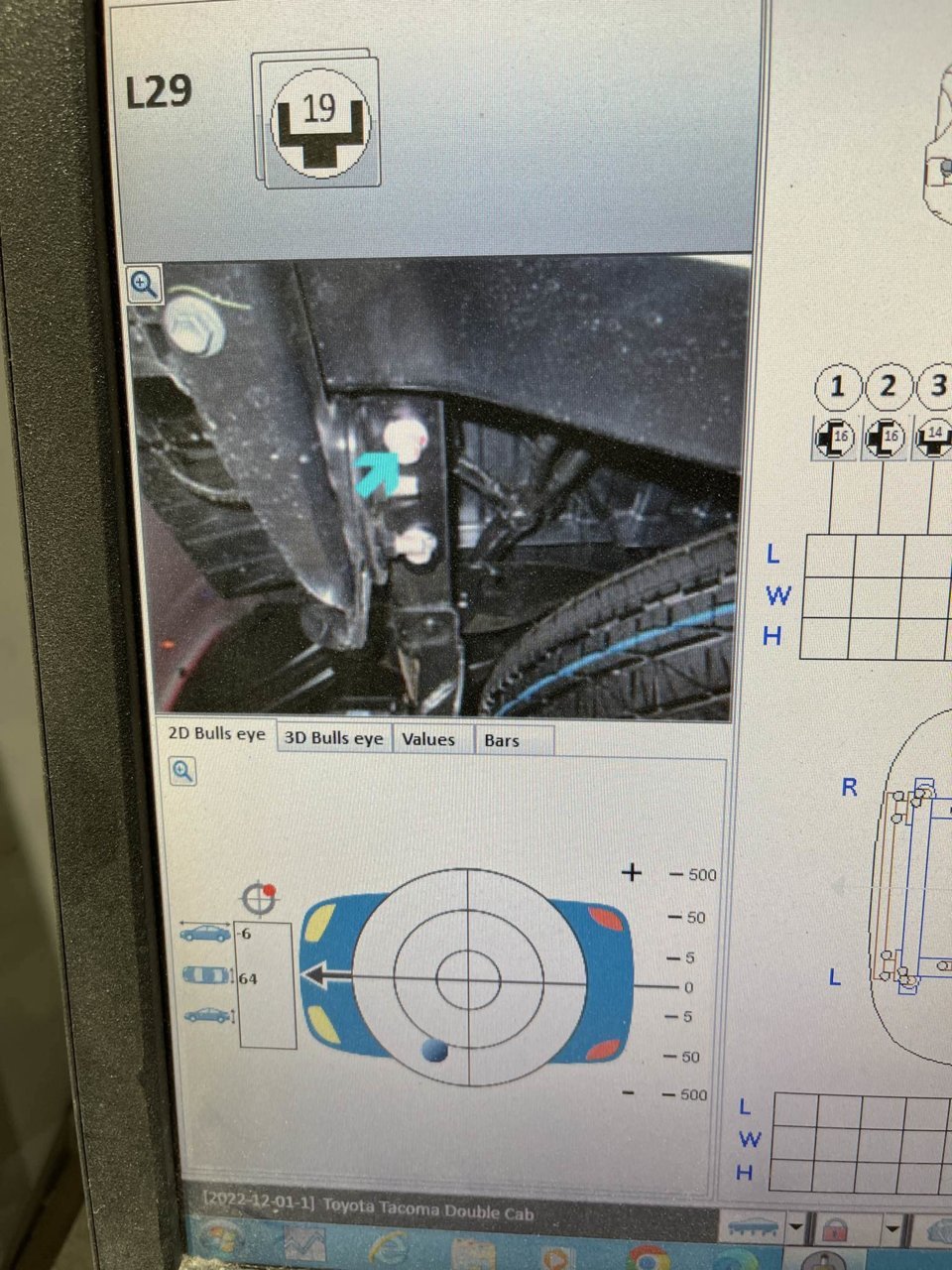

    Left rear horn is slightly out of spec, I know toyota says not to repair, but this in my book would be 100% repair and go on my way. Using a frame rack they can pull that section back into spec and be good to go.
    If there are no kinks or buckles in the frame then your not going to die the next time someone rear ends you.

    Thanks for the feedback. What is this sheet called that we are looking at? Is this an appropriate test to check the frame? I want to be sure the Toyota body shop is doing my truck justice.

    Its just a frame alignment rack print out. Its just like a wheel alignment print out. The put little laser sensors on key parts of the frame and the computer measures everything.
    The yellow ones should be ignored, but blue one is the only out of spec, but not by much.
    There is enough adjustment in the bumper itself that everything would line up even without frame pulling.
