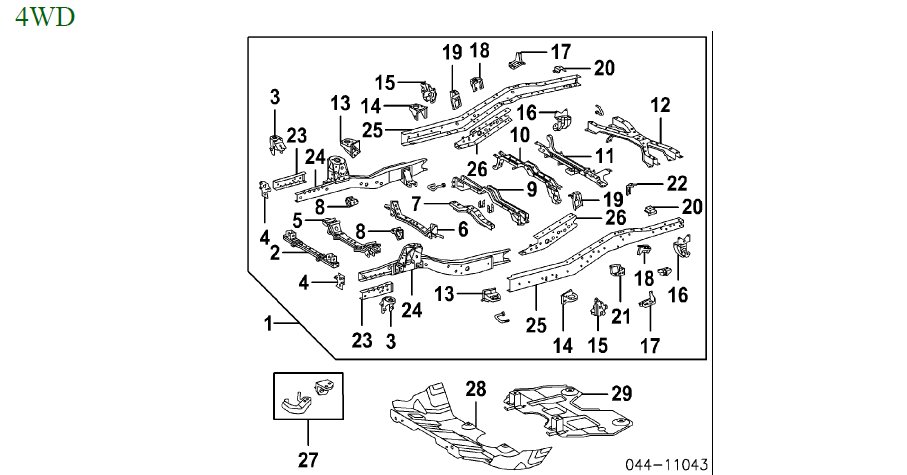

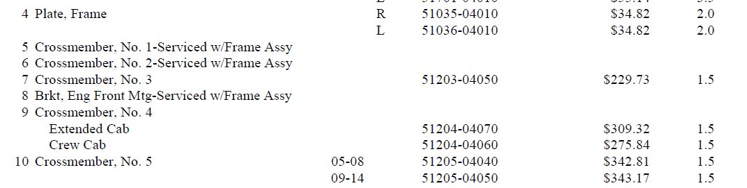

  7. Jul 5, 2021 at 6:51 PM
    #27
    super_white
    super_white Well-Known Member
    Feb 6, 2012
    #72230
    8,728
    Harry
    Connecticut
    2012 Tacoma 4X4
    Here are some part numbers but I'm not sure if you can buy them separately (no part number). It looks like #6 is bent on your truck.
    T42010[OP] likes this.
