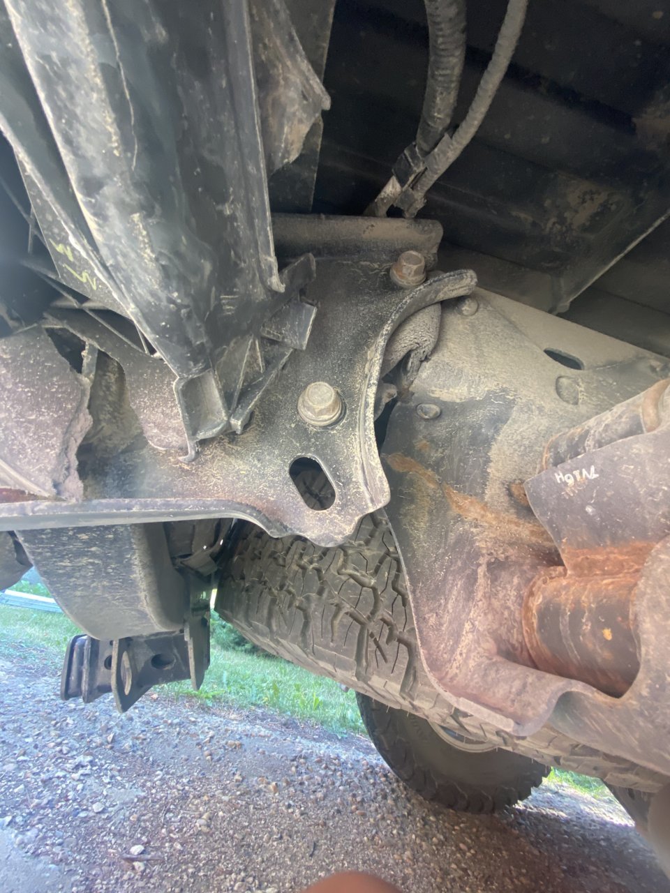

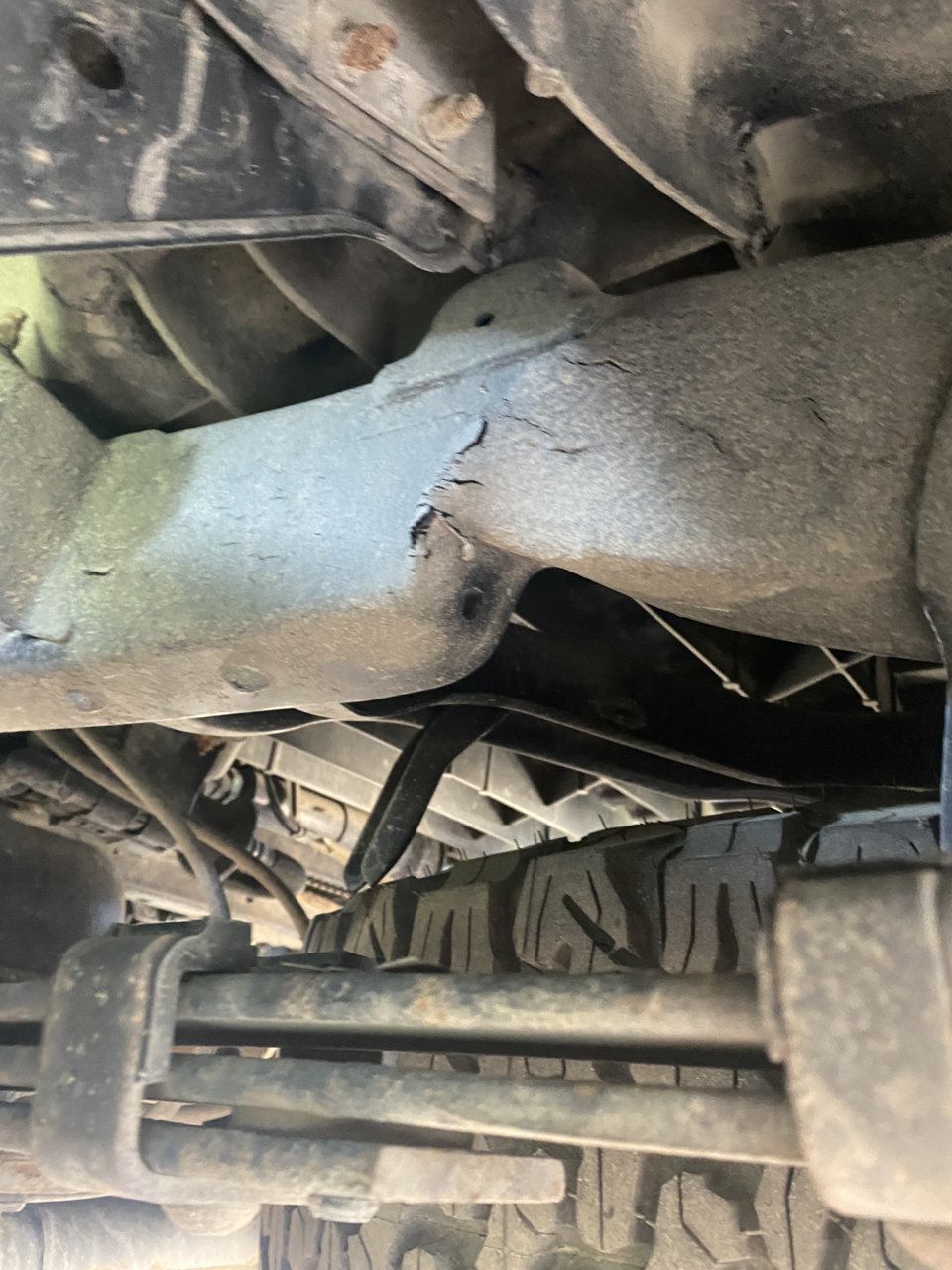

    Got rear ended in mine on Sunday.
    Frame’s bent in at least 2 spots that I could see.
    I’m waiting on finding out what the repair estimate will be/if insurance is going to write it off.

    This was mine at 10mph
    stealthmode and Thompson486 like this.

    The driver that hit me was probably going around 50kph.
    Note the way that part of the frame is folded into itself…
  10. Aug 23, 2022 at 10:34 AM
    #30
    stealthmode
    stealthmode Well-Known Member
    Dec 7, 2014
    #143869
    2,492
    Alberta
    2016 Short N Stubby Bed- MGM
    Front and Rear lifts Tires ECGS bushing Lots of other crap +HP sticker
    Wow.
    I could see why being in-between the leaf pack bracket and the hitch. It's gonna fold where it's just bare frame.
    But that's crazy.
    :pccoffee:
    Thompson486 likes this.
