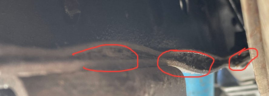

    Suggest not to F around in court trying to push the mechanic who inspected the truck to repair. It isn't his burden, YOU purchased the truck. Ultimately, its your responsibility.
    You can spend the $5600 to repair or trade to accept the $5000 loss. Its about a wash.
    Frankly, if this were mine. I'd clean out any dirt, debris, rust, crap in the gaps. Spray with a rust converter primer, paint the area, then as a final step.....pump the gaps full of a silicone caulk. This path should halt any beginning rust and prevent water/dirt from settling in the gaps. After that it becomes a monitoring item.

    thank you for the advice on how to approach it. Let’s say it does get progressively worse. What would you suggest at that point?
    Also, of course it’s my responsibility. However, the mechanic admitted some fault because of how enthusiastic they were able the truck. They even said “it has no rust, cleanest truck we’ve had come through, you should buy it”. That alone is why I bought it. Part of their integrity as a business is also at play here. Their business insurance would be the ones helping to remedy this, not the individual shop owner, so I really don’t feel out of line by asking for some help with the situation.

    Im not saying its normal but its not caused by rust, at least imo from what I can see in your 2 pictures. Your frame actually looks good rust-wise based on those pics.
    This is a random pic from the Google showing what I would think of when I hear rust delamination. Even thats not as badly deformed as what you have. Think about it from a leverage perspective. Rust can exert a ton of pressure over a very small gap. But what you have must be damn near 1/2 inch, I just dont see how that could happen.

    Could you dig some of the stuff out of these gaps and confirm that it's rust? It doesn't really even look like rust to me.

    So I just spoke with autorust technicians out in Rhode Island. They claim that it can be repaired, but that it likely is rust. They say that’s where a lot of the Tacoma’s start rusting first. There’s some rust inside between the frame reinforcement plate and the main frame panel. I believe it is like a “wedge” it’s closer near the junction of the frame and wider as it fans out. I think that’s why it is pushing out like it is.

    I coated it in fluid film so I think it’s just the grease on the area that makes it look darker

    You have a very generous mechanic. I certainly would avoid court actions. Take him up on his offer. Have him detail what he will do. Then make your decision.
    FWIW, I don't see this as a Safety or a Cosmetic issue. I'd have to stretch to think it is a Structural issue at this time.

    It seems the verdict here is that I can repair this (at some cost). For the time being, POR15 and sanding should do it well from what I hear. I also talked with some mechanics who think it has about 10 years of life left, albeit they aren’t Tacoma experts. If it doesn’t work out, they have aftermarket weld-on plates from SafTCap that can go on. Sounds like it could work out in the end if I’m being optimistic. Is there anyone who thinks that I’m off-base in this assessment?

    The shop that you had inspect it either didn't see the "issue", or didn't think it was a problem. You found it, and you think it is a problem. Someone in an earlier post suggested taking it to a body shop. You should take it to a reputable body/frame shop and get their opinion. Otherwise you may be getting all upset about nothing.

    Yes, that could very well be true. I have seen so many horror stories here that it really got me scared. This is the most I've spent on a vehicle - the reason I got it was to be relatively trouble-free.
    I spoke with the body shop that wrote the expensive quote ($5600). They said that they only do the frame-off and welding because they'd want it done perfectly the first time so that's their policy. They did say that in their opinion, the truck still has 10+ years of life left and that they'd have no moral issue with selling the truck as-is for the same price it was purchased for.

    I would keep applying FF periodically in the rusted areas, especially in the summer when it’s hot. That stuff will migrate up into the rusting areas and stop the rust. I really don’t think it’s that bad based on what the other parts of the frame look like. I would just relax through the summer and reevaluate in about 6 mo.
